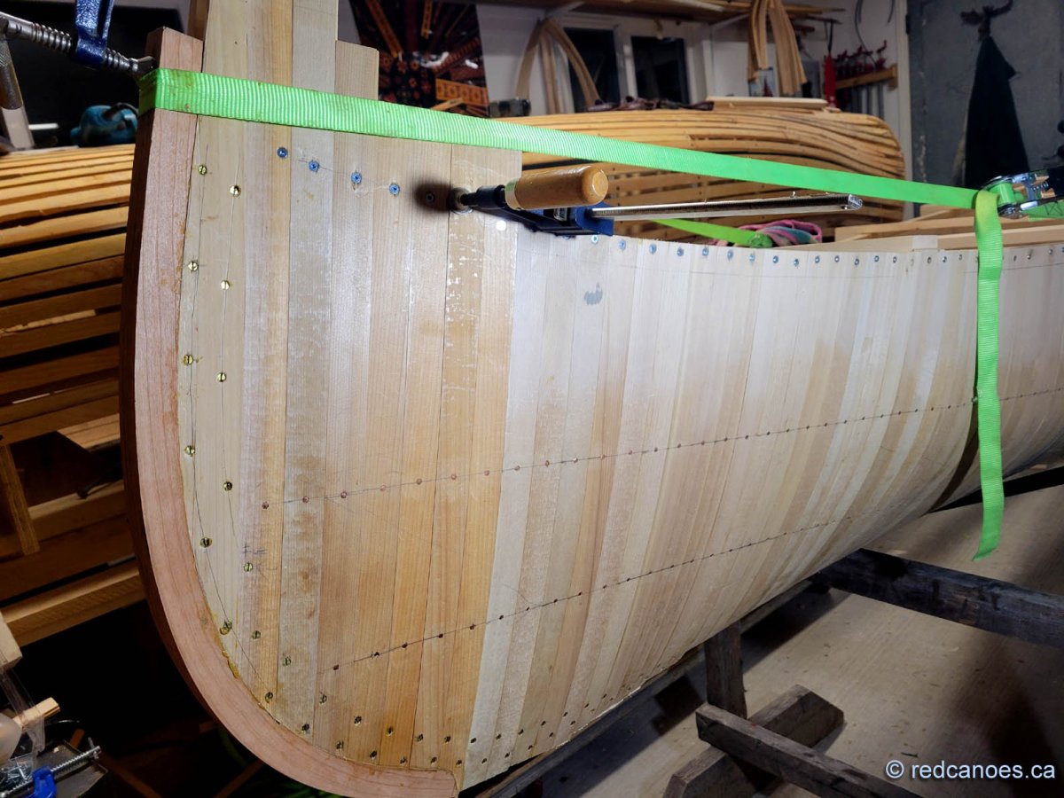

Wow, so someone finally built a rib canoe. You will love it. Good job. I was going to pull my stems and re-bed them when I saw the post.
Thanks everyone...not much luck finding a pliable mahogany here yet, so I took the easy way with cherry bending on a form and installing after a week. It's a new build and a bit of an experiment/prototype so maybe the next one will have mahogany stems.:)
This is stunning Walt. I gotta know more about this build. First, how did you calculate the vertical planking? Meaning the widths. Are they ever changing based on the hull shape?
Thanks for your encouraging words everyone. Jeff, I think that you practically built a new one when you rebuilt your cedar rib, and yours has been in the water! I am not there yet, but slowly working on it. Currently bending and installing rails and decks. If it all somehow works (or even if it doesn't) I will share the story but one thing I am pretty sure of...I will need a bailer!:D

Walt, are those nails or tacks in the pictures? Copper, brass, bronze? Do they get cliched? Pre-drilled?
Forgive all the questions, but this type of construction is not often seen.
They are 1" and 1 1/4" copper nails, probably around 1500 in the hull and yes they all had to be pre-drilled, and fastened to the form; then when popped off the form, drubbed then clenched. And then another 400 for the rails which were nailed on after it came off of the form.
