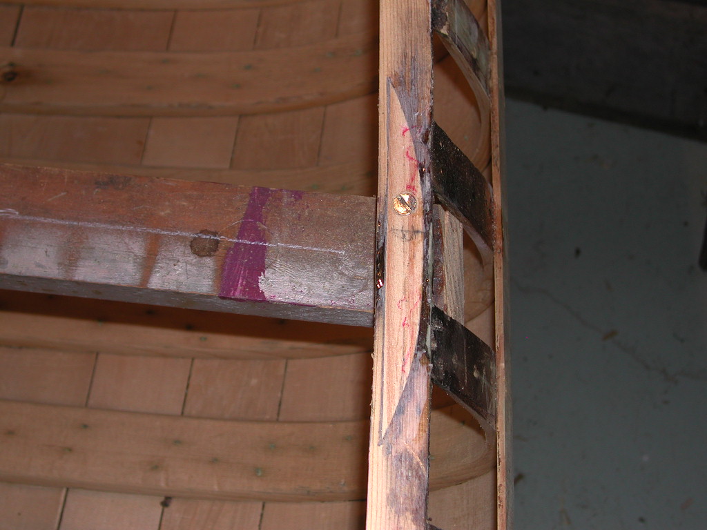

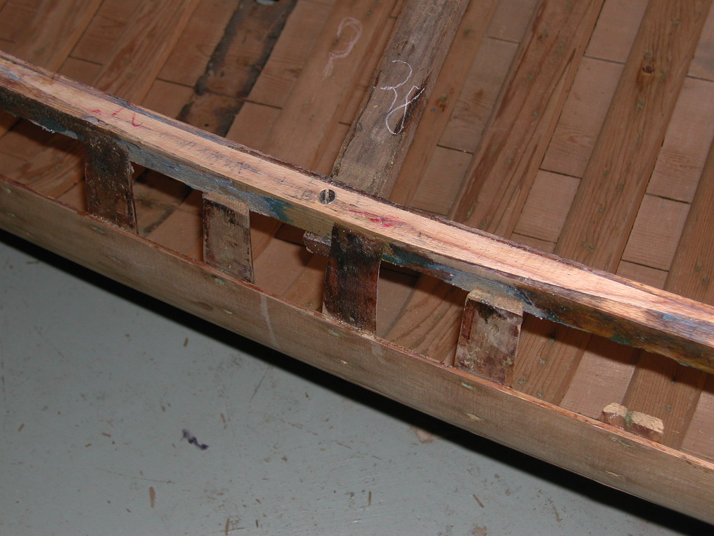

I probably would have put longer angles on the ends of the cut giving it more glue surface. You could probably still do that. I have seen worse looking repairs that have been just fine. You still have quite a good amount of original inwale there. If you are satisfied with your little insert, just add a couple of screws to help hold it in place in addition to your adhesive. It will most likely be fine.
The first two photos are of a Morris Canoe and the third photo is from a Racine. In both cases the damaged inwale that I repaired was in far worse condition originally than your little crack. Also both were closed gunwale canoes so most of the repair was hidden.
Thanks. It's not unlikely I will do one of those things. I'm thinking maybe instead of screws some small dowels glued in through the ends of the patch. It -is- a bit inelegant having to do that but would certainly be helpful. Mostly worried about getting a really good fit over the whole surface of long tapers on each end. Thanks again:)

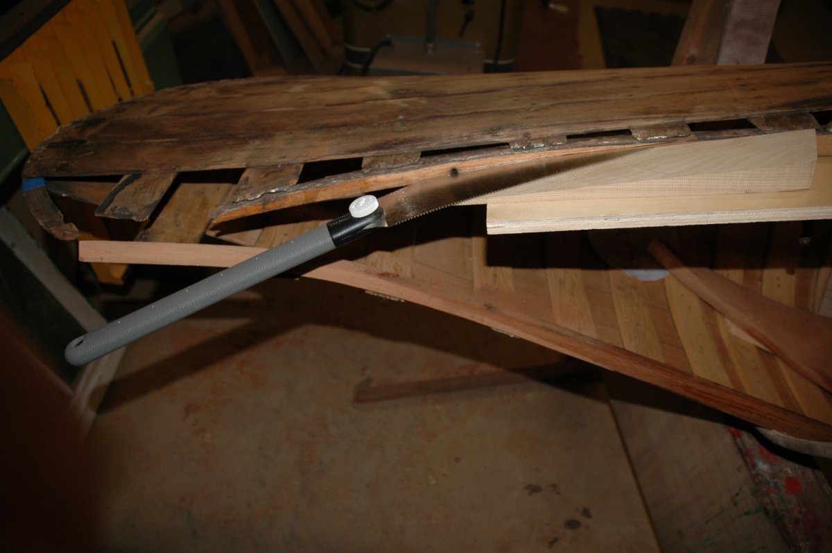

Also here's what I'm considering for the inwale tip replacements. I just need to make a jig of some sort to get nice flat cuts. I bought a couple of fancy jointery handsaws but I think my grandfather's old jigsaw is going to be the tool of choice:)

Here's a table set up from which to saber-saw these. Seems like either this or orient to each of the top surfaces. No right angles so have to establish some reference plane...
6C9F3882-6C35-4652-B142-A343E351BDCC.jpeg Here is what I prefer, a nice long scarf joint. If both sides need repaired it is nice to make them match. I don’t mince being able to see a repair if it is well done.
DSC_0884.JPG Straight cut. Simple jig, piece of plywood clamped to inwale with a taper attached to it for the saw to ride on. If you look close the other inwale is already done.
