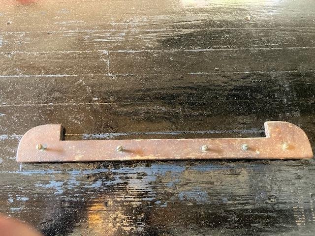

I had a look in the box I put things in 35 years ago, when I started enthusiastically removing bits and found two of these parts, presumably to hold a seat. The cut-out is 9" long; they were mounted at the rear, screwed to the ribs one on each side, slightly lower than half way down. The number on the back is the same as the number stamped into the thwarts, so they are original. Does anyone know what style of seat was used
originally?
