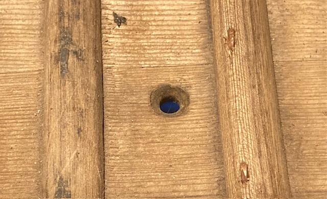

Hello again,
A few questions :
There are eleven of these holes either side of the keelson, made to hold a rubbing strake. They are approx 3/16" hole, 3/8" countersink.
What is the best way to seal them? One way is to countersink the outside and use similar-coloured filler. Another way is to drill through 3/8" and glue a plug of the same wood. Any better ideas?
I suppose, since eleven holes are in one strip, over 6', I could have replaced the two strips, but I have only one lifetime.

Others with more experience can provide an answer but keep at it, look forward to seeing your finished canoe.
I would plug them with bungs made of the same wood. Orient the grain to match and they will not be obtrusive.

Yes, I was favouring bungs of the same wood and end-grain to match but what about a counter-sink on the outside, so there's less danger of the bung being forced out (in), when bashed, for instance? Or are modern glues strong, waterproof and long-lasting enough?

Charlie , I agree with Dan as you can do this pretty fast ,with the grain just right, and with an epoxy for gluing in they will really be in to stay. Don't soak her up before you do this or you will severely compromise the bond. You have so much into the restoration at the moment , a little persistence with the details to finish it up will be appreciated when you stand back at the end and say WOW to yourself. Can't wait to see it done . It will be tender, and I mean tender. I know this. Have fun.

Thanks everyone, I'll definitely get the wood work finished before applying liquids, other than paint stripper and glue. 34 half-ribs done, 10 to go. I suspect this canoe has touched a lot of rocks.
