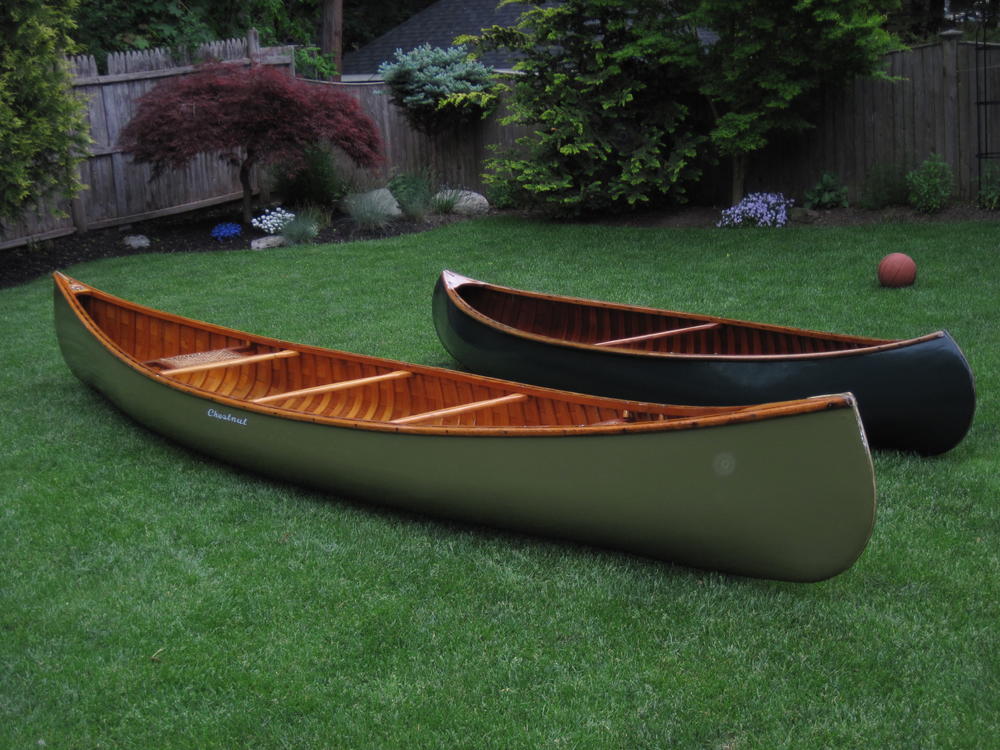

check the kirby's website, they have lots of colors and ship to your door. i just used a color called seaweed and really like it008.jpg
Sweetwater, of the two canoes in your picture, what kind is the smaller one? I have one similar to yours but never was able to identify it. My Northwest WCHA Chapter believes it is a Chestnut. My canoe was on the cover of the Wooden Canoe August 2012 issue. I removed the seats and replaced them with wicker seats. I also added the brass you see on the front. The members believe it might be a Bob's Special Chestnut.It is a great canoe.

check the kirby's website, they have lots of colors and ship to your door. i just used a color called seaweed and really like itView attachment 26232
I just have to say, a beautiful pair of canoes, and likely the beautiful colors play a big part. I've always liked the smaller OT 50-pounders (they are among the few OTs I'm really wild about), and hope to have one some day! Yours might be the prettiest one I've seen (again, your colors are perfect).
