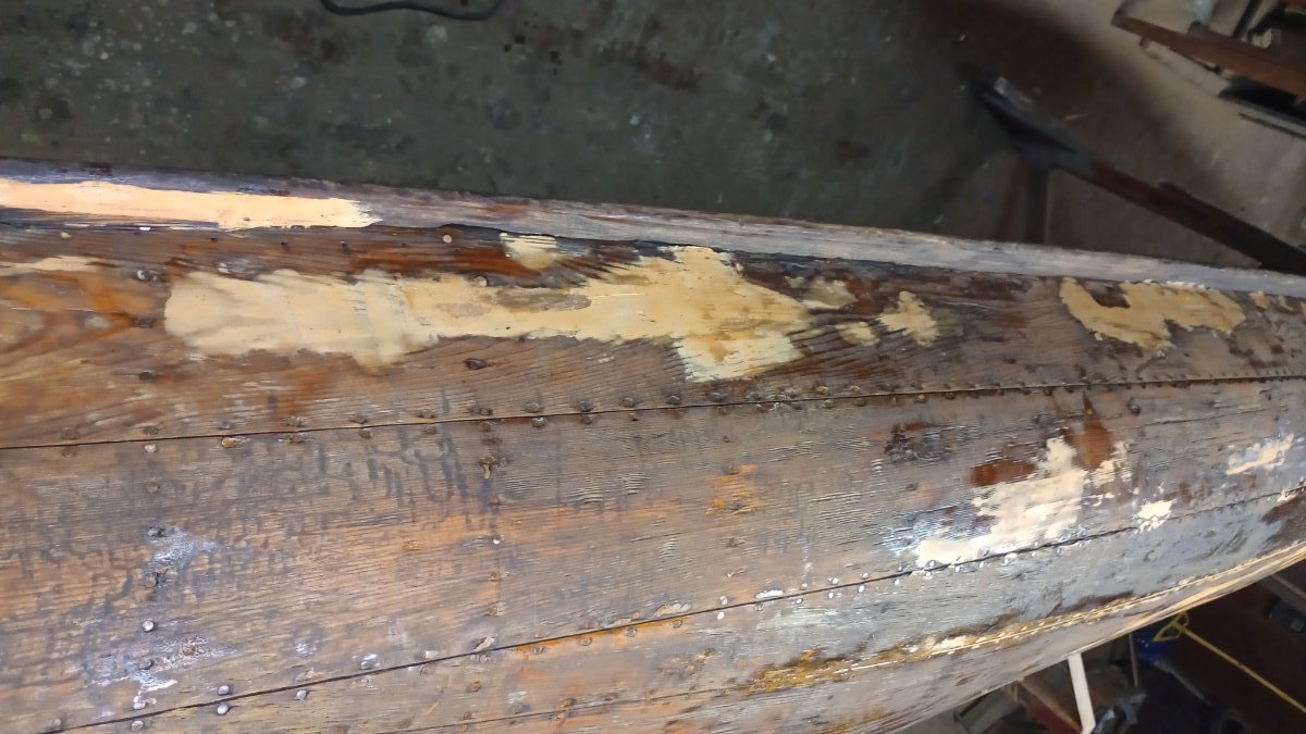

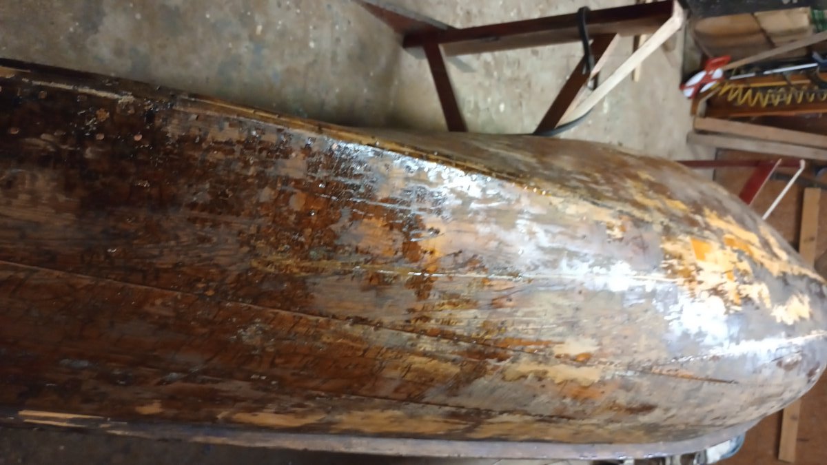

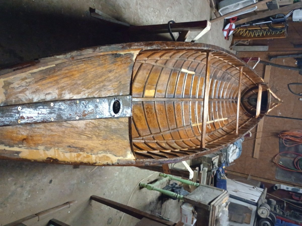

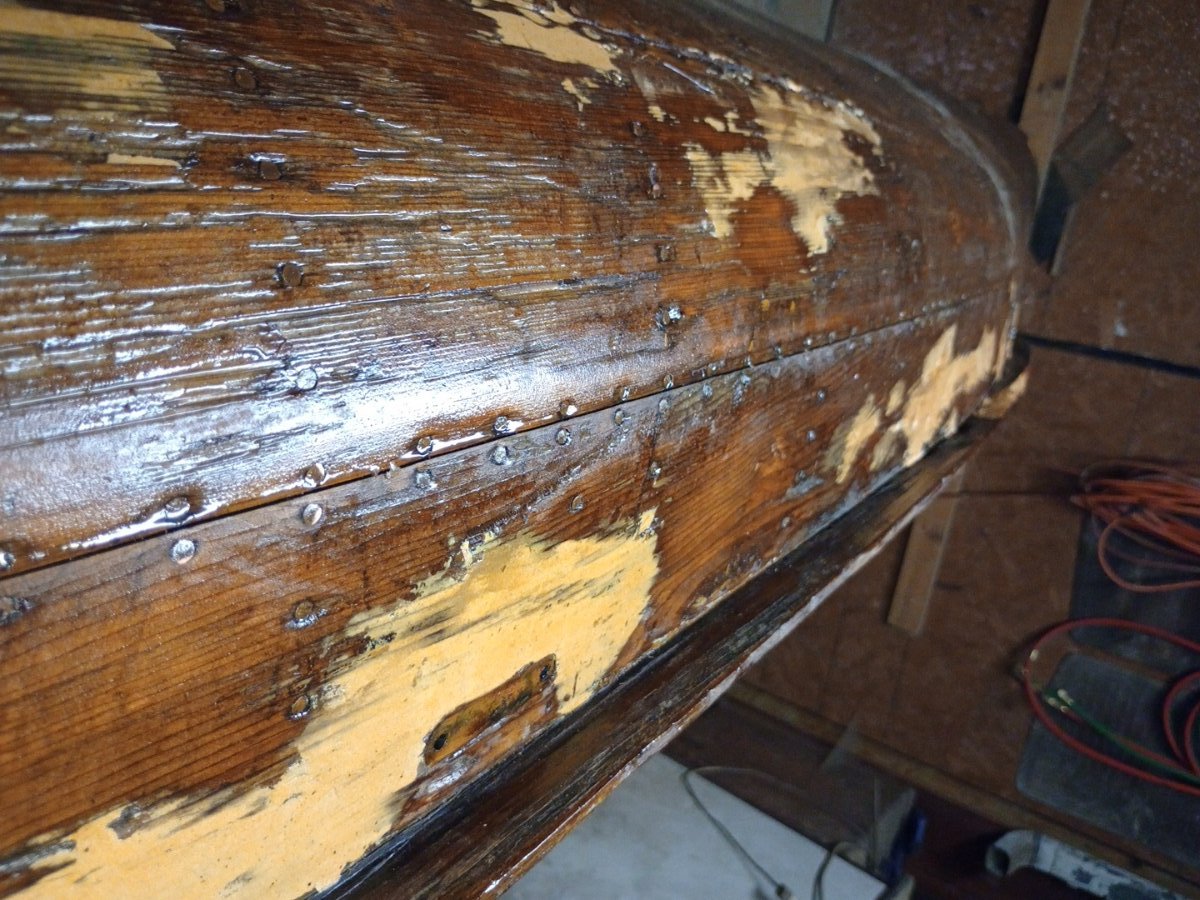

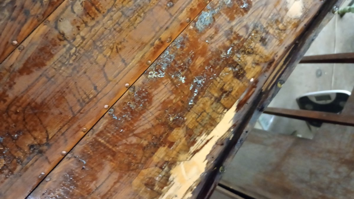

I'm not proud of the rib repairs but they are done. I'm thinning floor polyurethane to coat the exterior hull. I filled the deep gouges but every plank is scarred. When I'm satisfied it will float I'll coat it to cover the puddy.
The name shows better now. QUINNEBAUG, LONG LAKE, sometimes with one N or two G's.
It's a popular name, there's one in Tennessee
I'm leaving the country. I'm glad I got the canoe to this point. Several ideas about covering the filler. If I make it back I'll get it done. If I don't return there'll be about 8 canoes and 15 folding kayaks/ boats for sale. Here's where the Bush is at.

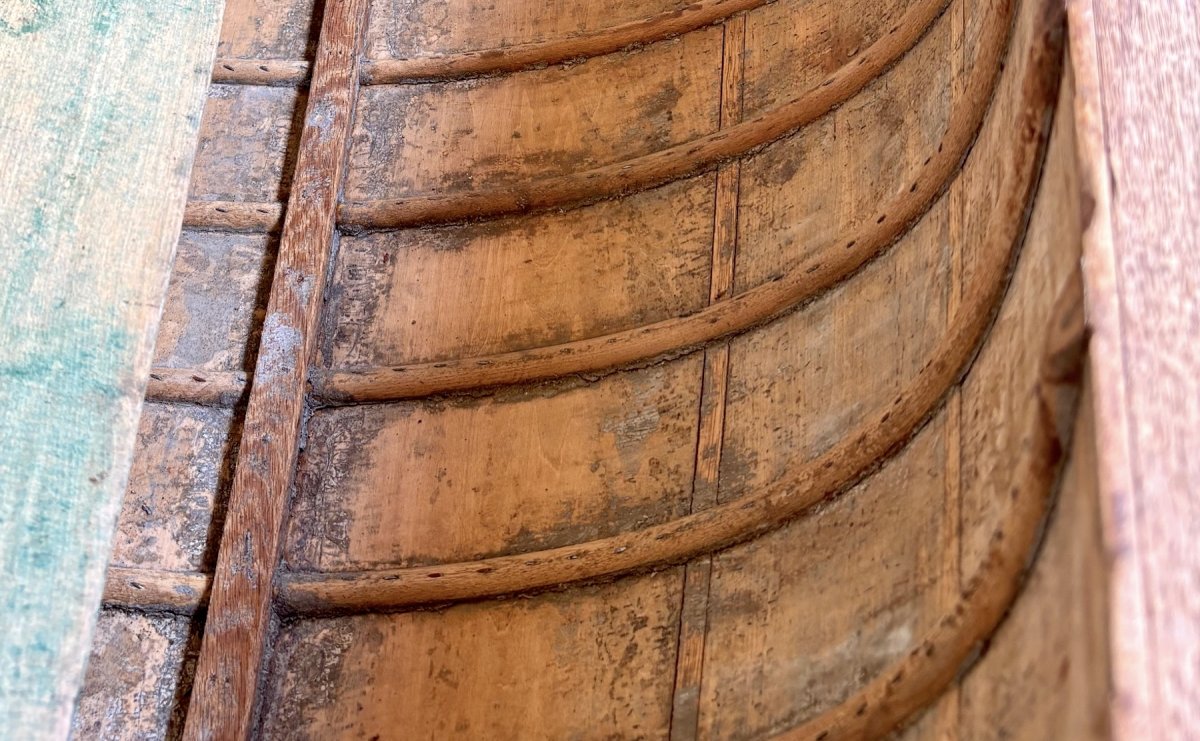

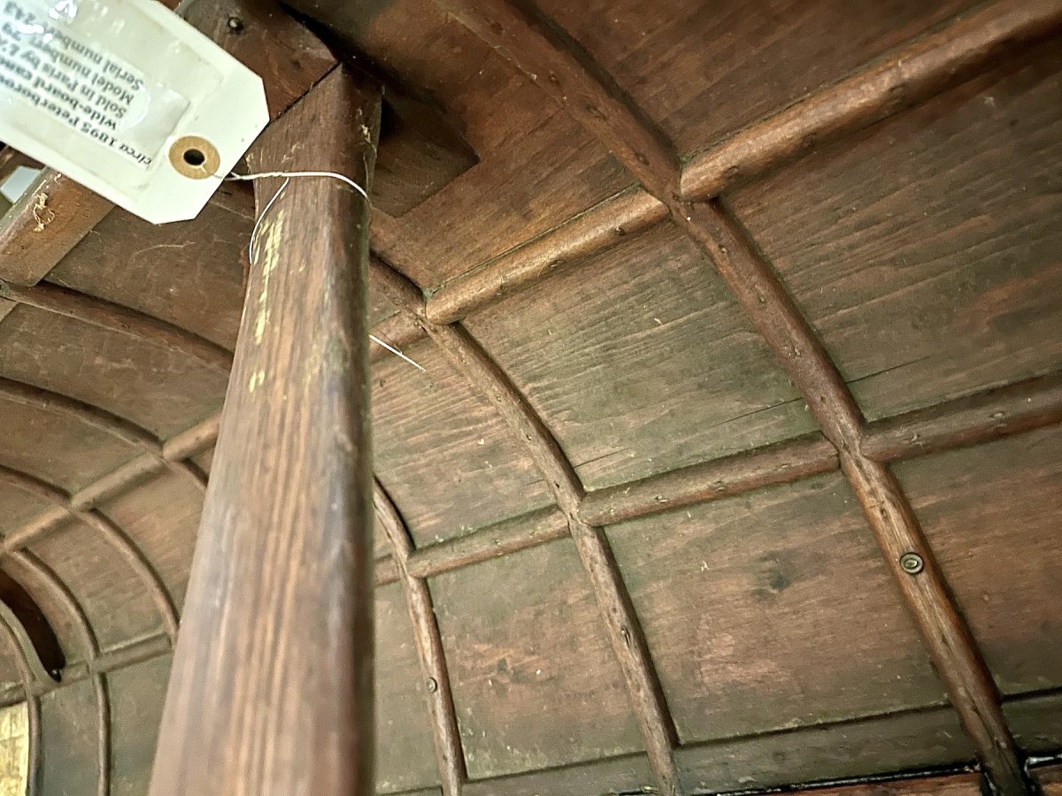

1. Rib and batten canoes, also known as wide-board canoes such as the Bush being discussed here. These are most often seen with basswood planking, though they were also built of cedar, cypress or mahogany, with widely-spaced interior ribs. The battens are made of rib stock.
14' Peterborough rib and batten

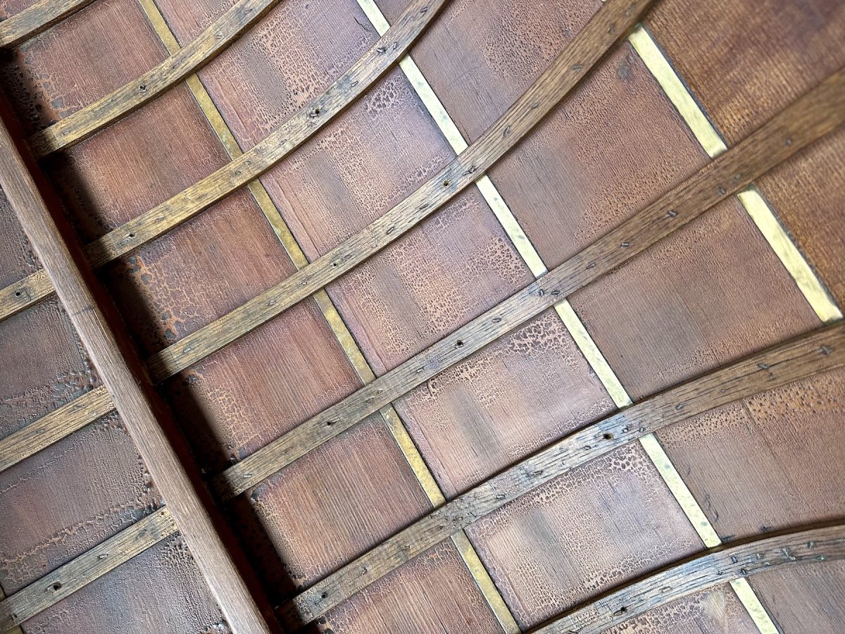

2. Metallic joint canoes, in which wide boards were joined along their edges with brass or copper strips, somewhat like an extremely long staple that runs the full length of each joint from bow to stern. The battens are visible between the narrow ribs lying interior to the planking and battens.
Metallic joint

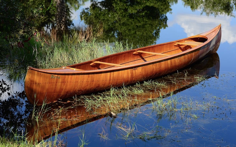

15' Daniel Herald patent double cedar
5. Cedar rib canoes. These have a single layer of planking running gunwale to gunwale, and these “ribs” mate with each other via tiny tongue-and-groove joints. Along with the gunwales and keel, lengthwise hardwood battens held everything together with a fastener through each “rib” each the batten.
16' Peterborough cedar rib

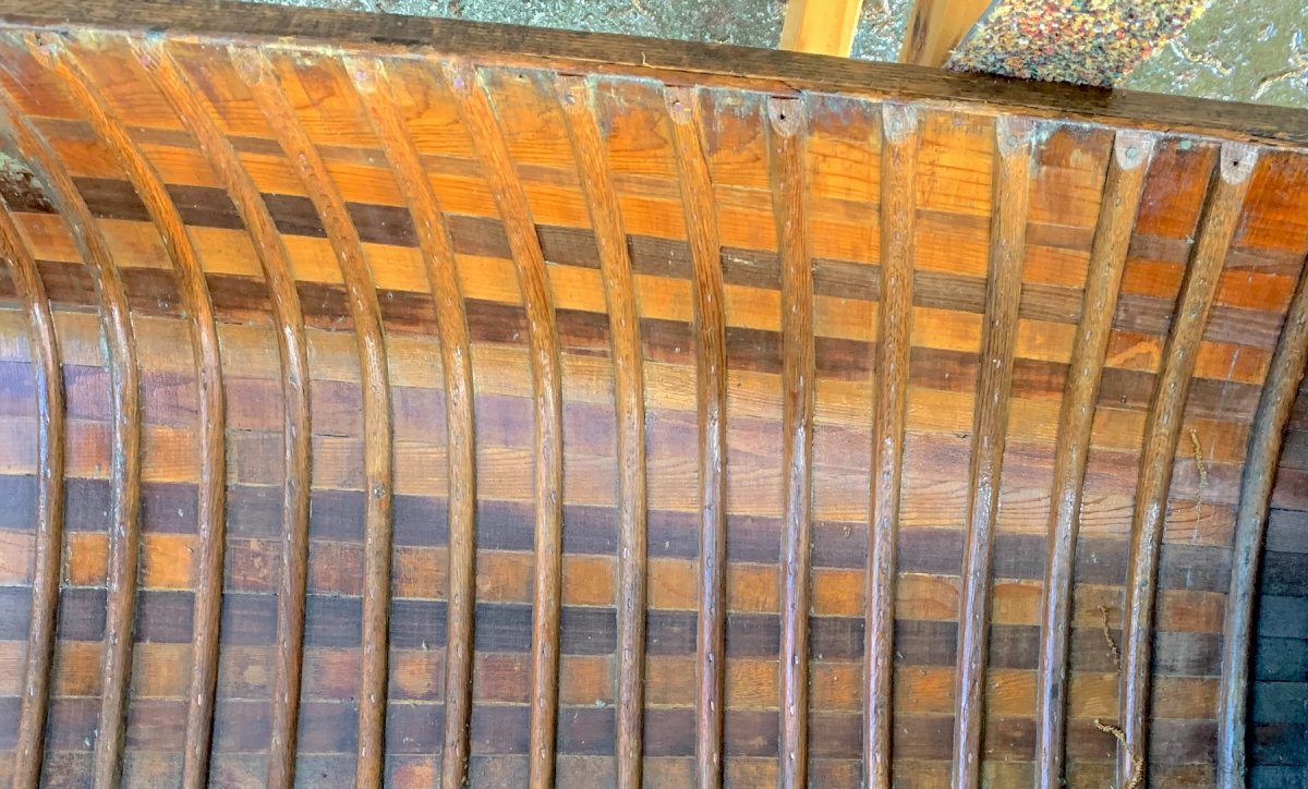

6. Longitudinal strip canoes. Numerous narrow ribs with narrow lengthwise planking nailed on, each plank joining the other via half-lap joints. Sometimes they were made with alternating species of wood to produce the pattern shown here (sometimes called "candy stripe" today).
16' Canadian Canoe Co. longitudinal strip

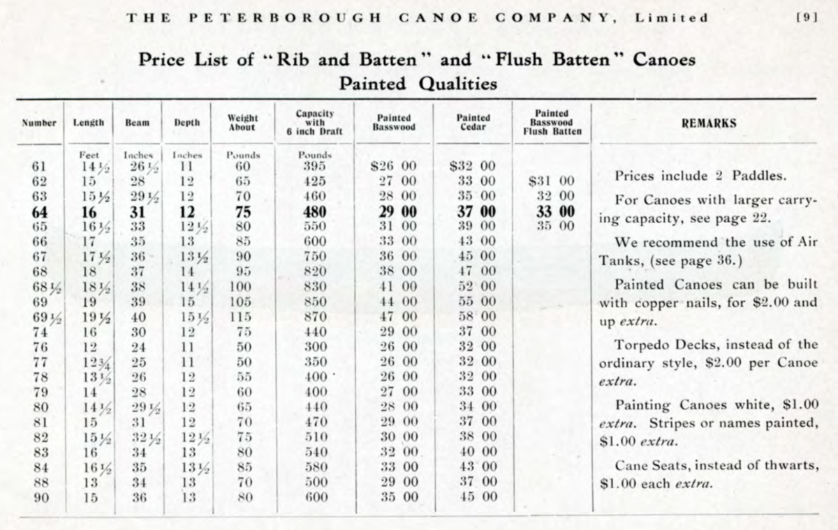

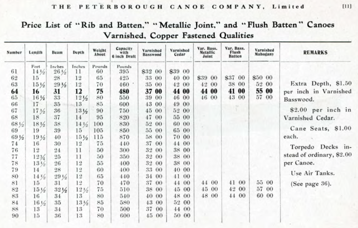

Some canoe models from Canadian builders were available in a variety of construction methods. For example, you might purchase a given Peterborough model in rib-and-batten, longitudinal strip, or cedar-canvas construction:
