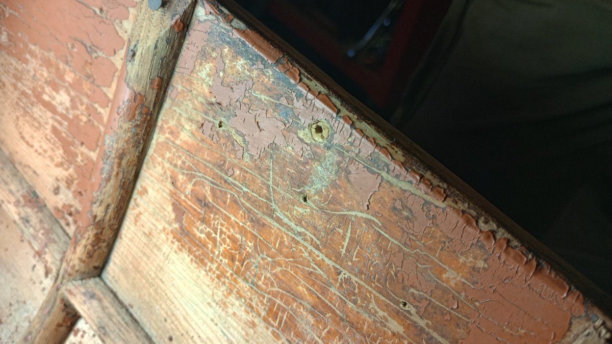

And about the paint. You're right again from what I can tell. I had it outside and stripped using a stripper and water hose. The spots I missed have a brown varnish under the brown paint. What was called "shellac" in the past was clear going on but would turn light brown with age, That's what I see under the brown paint. The basswood is light and soft. Unfortunately, it doesn't seem to be highly rot resistant.

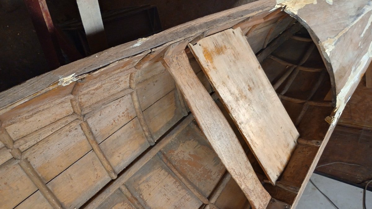

Don't throw ou that rear seat and its cleats! It may well be from the factory. The Canadian builders of that era did do this from time to time - it is uncommon but not unheard of. And they did it just as yours was done with the semicircular cutouts to fit to the ribs.

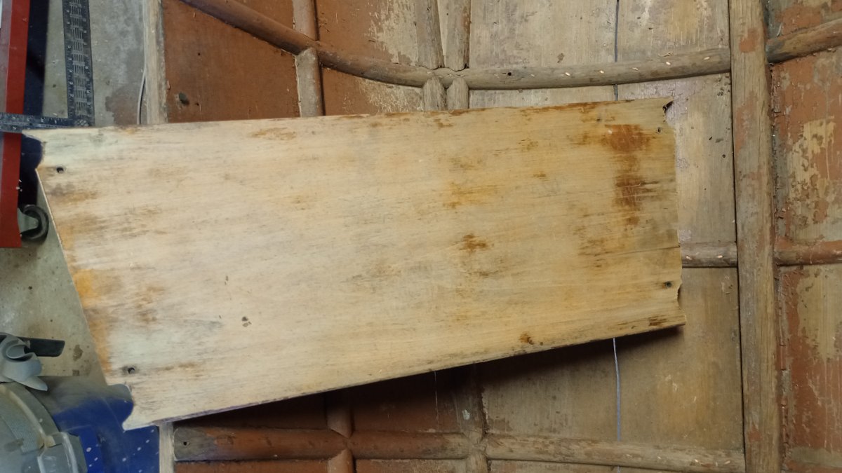

Both decks were in pieces. The stems were badly rotted. I had no model to go by. It's not going to be a great restoration. I restore these canoes to use them. After the third portage they start showing wear. I will take your advice and put a clear coat before the brown. I'll use the seat because my knees won't allow much kneeling paddling. I've used local wood for restoration. Some poplar, some oak.

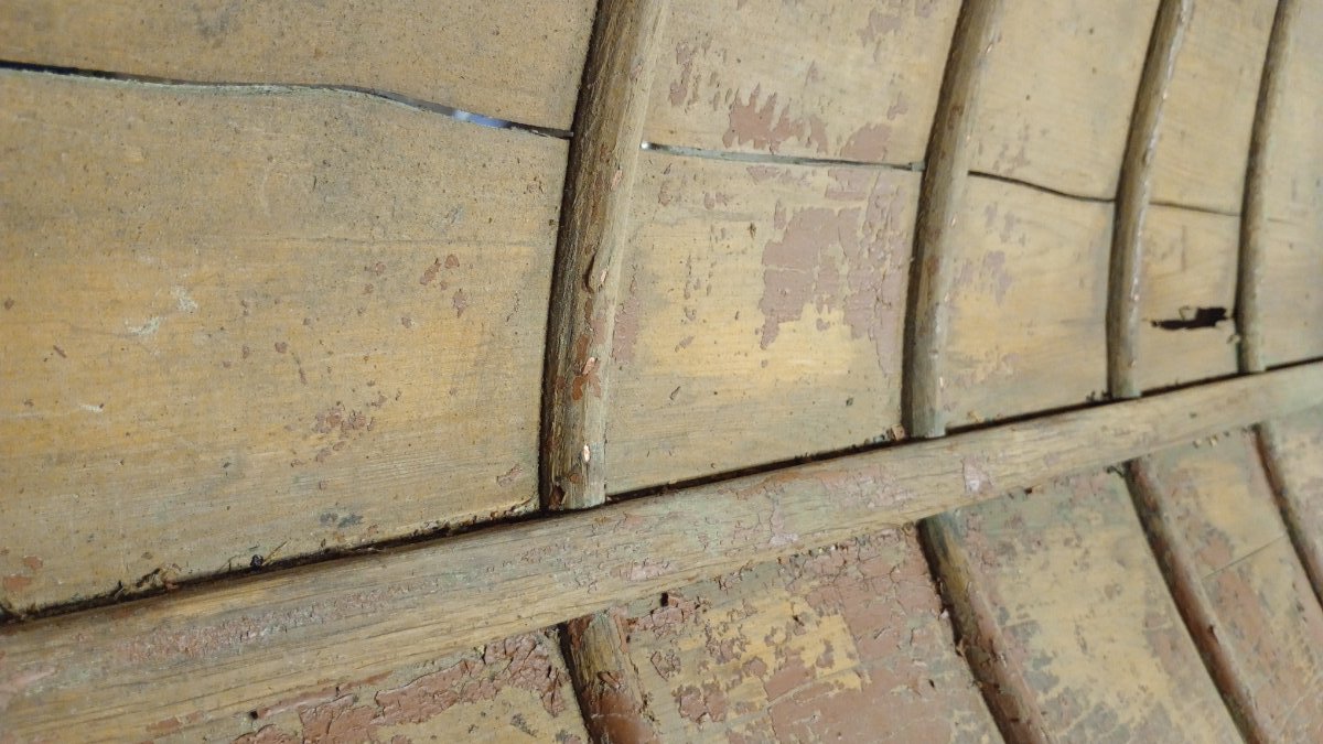

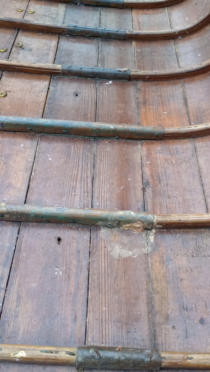

If anyone has a good idea how to repair the split wood please chime in. Photos of repaired ribs are a UFO I did few years ago. It's the only experience I have with narrow ribs. I split 1/2 copper pipe to make splints for the broken ribs. Lots of work but nine in a row and it holds up fine. The broken/split boards I'm tempted to glue.IMG_20251226_153918981.jpg
Please keep this dialog going. I inherited a basswood canoe several years ago, will need lots of work. Going to be a while until my skills get to the point I will take it on but seeing your work will be of much help. Glad you are sharing.
That UFO above where I used copper pipe to repair the ribs was canvas covered from the factory much as I could tell. It also had a clean/flat bottom where this Bush canoe has an interior keel (keelson?). Big difference because replacing a rib means a lot of disasembly. I think pulling up the keelson would cause more damage that its worth.
I turned the canoe over and added tacks to the keelson where I could. I cut out and glued a small puncture inserting a piece of cedar. Mind you I've already decided to paint light brown so missmatch of wood and filler will disappear.

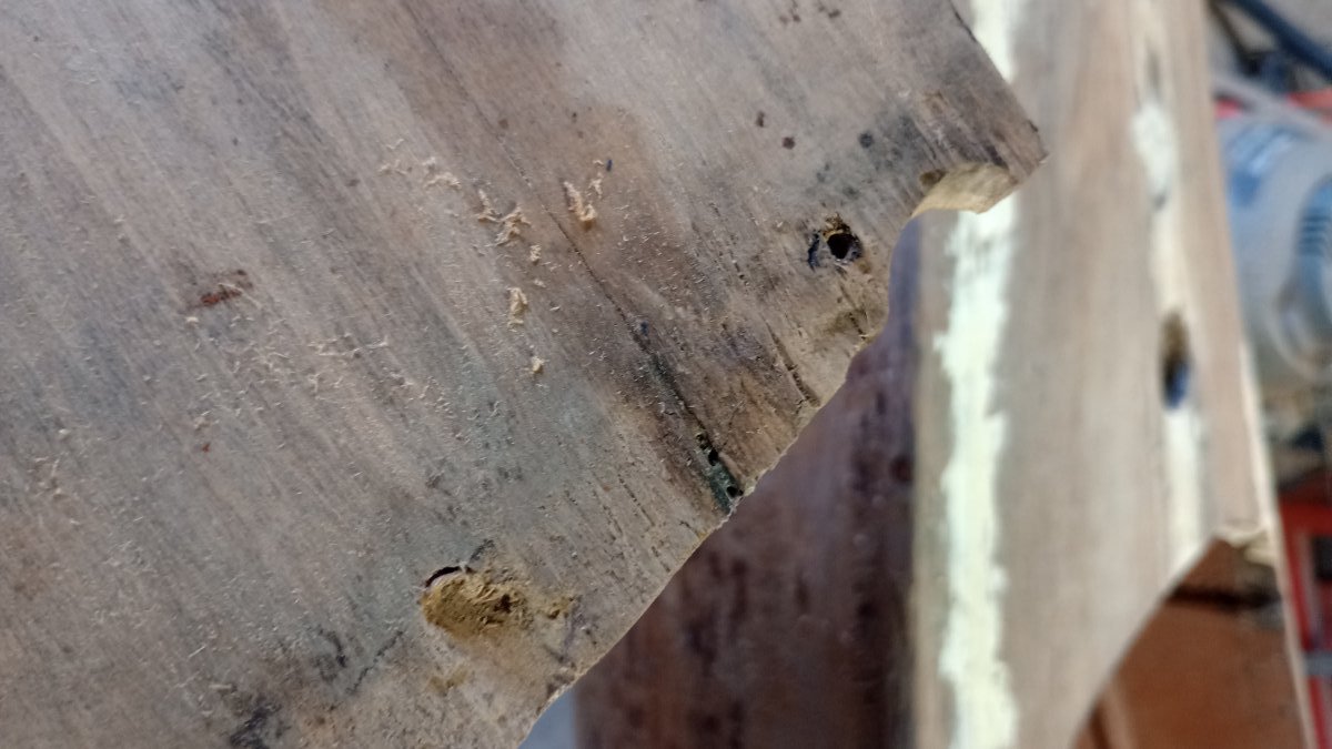

The splits in the wide board are an issue. Someone better come up with an idea or I'm going to invent something.

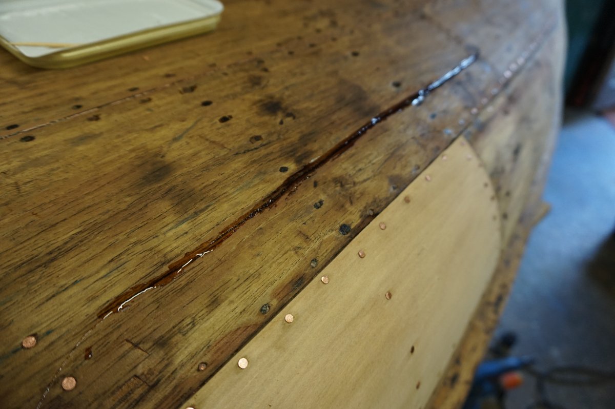

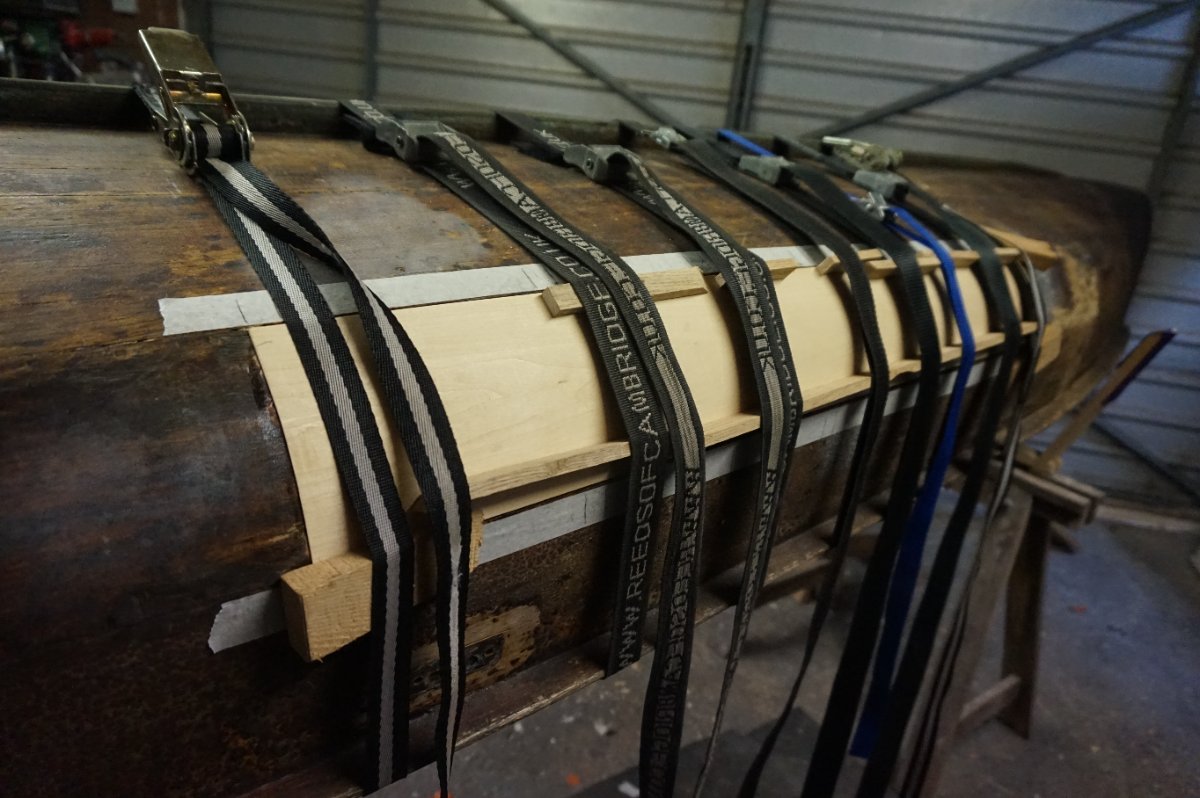

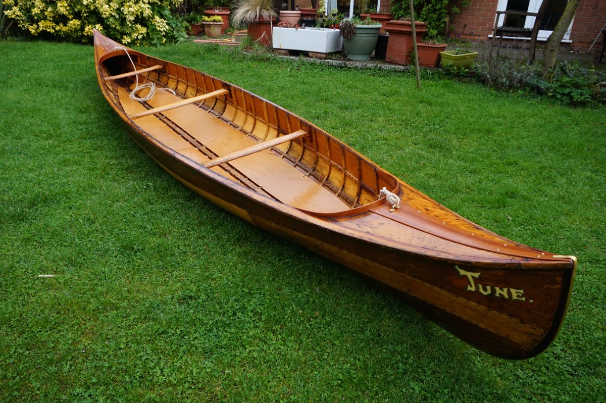

Have you a copy of Mike Elliott's 'this fancy old canoe'? In it is quite a bit of detail of how I went about sorting a board and batten canoe, including working with lime wood (the UK equivalent of basswood) and replacing boards and repairs to battens and ribs. The pictures in there are all black and white but with the text they explain well. If this is helpful and you need more detail or pictures just ask.
Sam
Hello Samb. No I don't have the book but I'll find it. My hats off to you for that restoration. Looks like you replaced two whole boards. Wow. That's a really beautiful boat. I see you put glue on the smaller splits. I'm doing that as well. Thanks
I widened the split with a V groove then filled with epoxy.
What kind of epoxy? I'm pulling the broken cleats between the ribs. They all have cloth under them.
A cheese cloth. Must be to prevent shifting or leaking.
One of the best epoxies you could use today for something like this is West System G-Flex because of its greater flexibility relative to more brittle epoxy formulations.
To repair the rotten and broken ribs and battens the best way may be more than you want to take on. They are probably red elm which can be difficult to find in the south but you can have it shipped. It would need to be milled to half-round shape, and ribs steam bent for replacement. Some people only replace half a rib - from the keelson up the the gunwale (no removal of the keelson required). The unfinished basswood planks will readily absorb water, so they can be wetted on the outside, after which they should curl toward the ribs. The fasteners are mostly likely copper nails which can be had in all sizes fairly easily. They are driven through pre-drilled holes and the tips simply bent over on the inside of the rib or batten.
