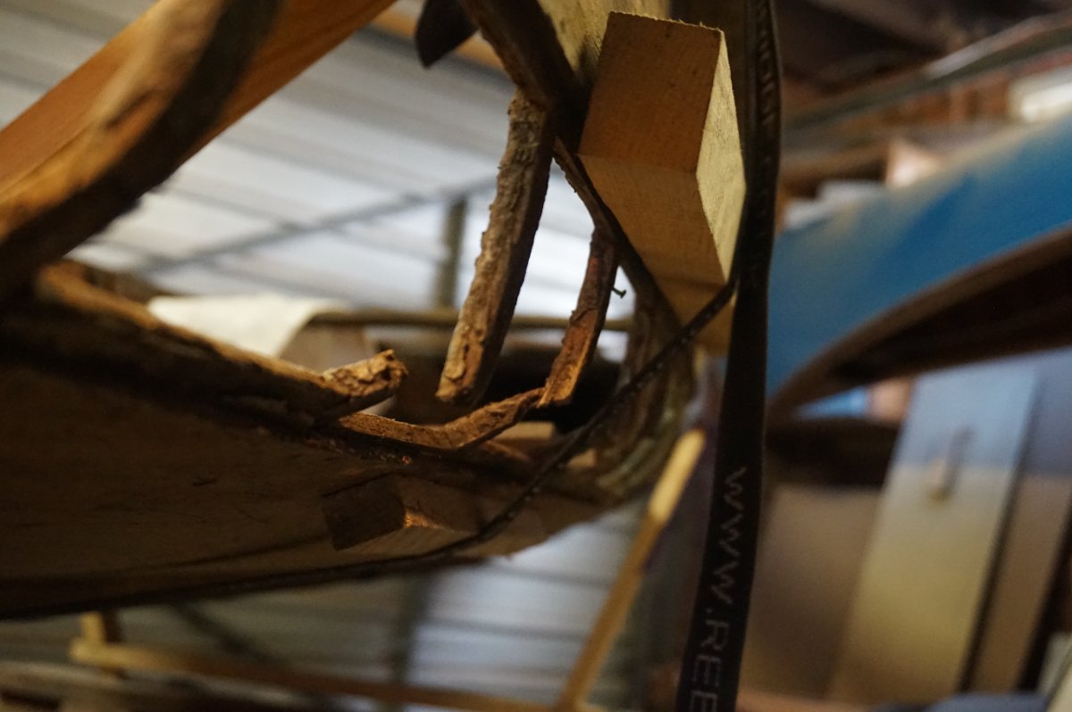

I've made every effort to save the old wood. Badly as the rot got to this basswood that means a lot of filler. I've used two types of filler. Two colors. Mixed poplar and cedar with oak. It's very ugly at this point. I'm not thrilled with this basswood. On the other hand , this canoe, as is, weighs 33 lbs on the bathroom scale. I knew it was light but thats really light for a 16 foot canoe. Because I had no model to go by there was a lot of trial and error recreating the stems and decks.
All that's left is the six broken ribs. ....copper pipe vs six new ribs, and no basswood on hand.

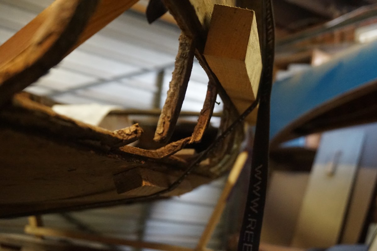

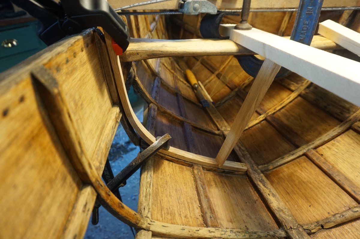

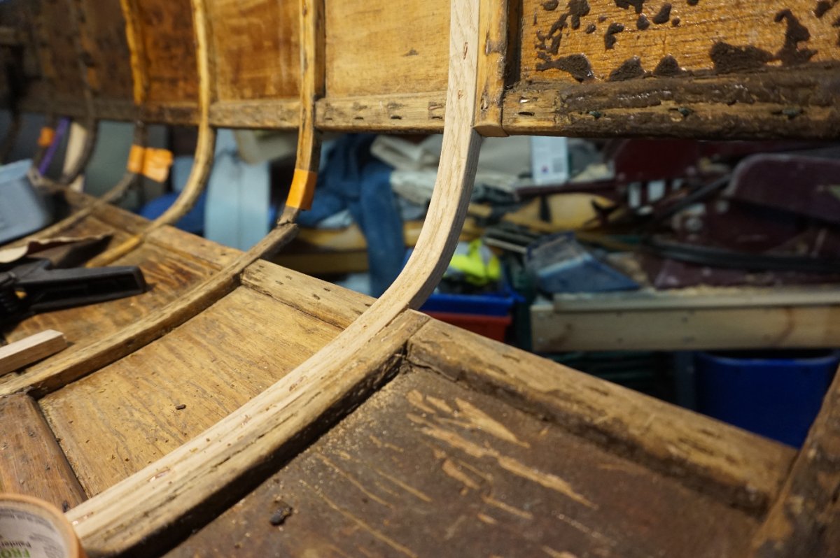

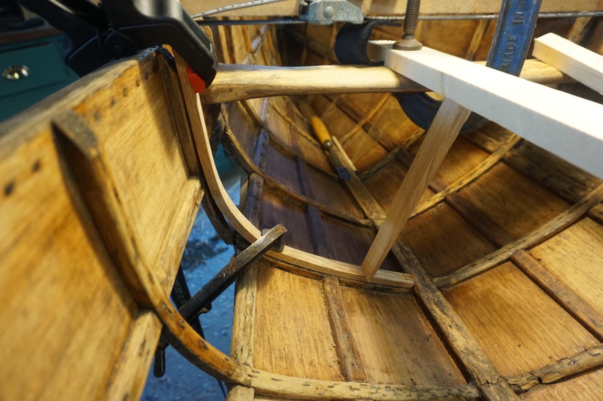

In defense of my work. It was March 2023 when I brought it into the shop. The decks were in pieces and each piece rotted. The stems were rotted away. The wales were already scarfed several times and likewise, all four ends gone. I never found another boat for an example or pattern. I procrastinated until this winter. I began piecing the decks together trial and error. When it seemed right I put thick bracing underneath where it wouldn't show. Then set up the decks as best I could but with no idea what was the upsweep or if the stems curved back or what. I Kept adding filler and small bits of wood until it seemed to come together. The result is ugly but there's an old saying about newly birthed children and their mothers. "I didn't go through all this work for an ugly." It's mine and it's beautiful.
Now that I've gotten this far I can better visualize the decks. How was I to know there was a (coming) piece on both?

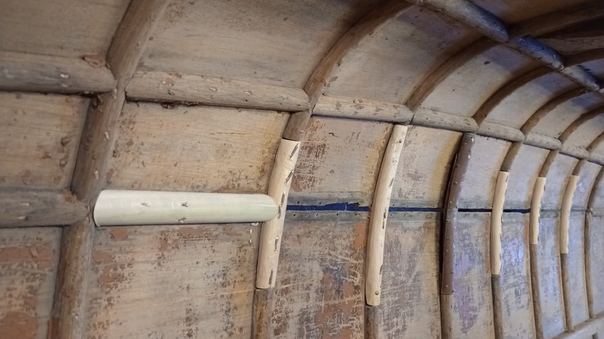

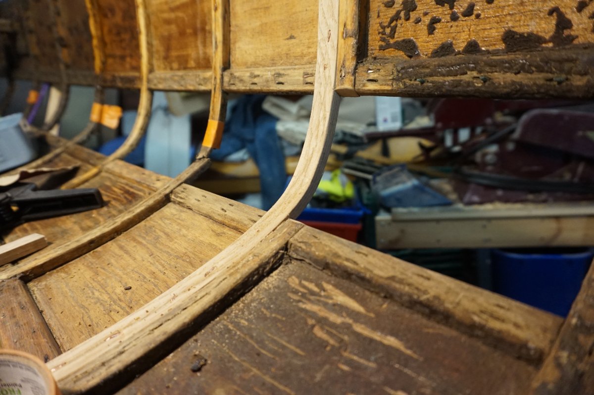

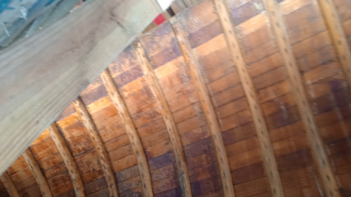

I fixed six ribs. I carved six short pieces to replace the rotted sections. I used oak for the first but poplar for the rest. Poplar doesn't split and is strong enough. Instead of steam bending I cut and sanded to fit. I drilled holes and clinched nails. The most important part was pulling the two boards edges into place. The first one I tried was oak topped with copper pipe. My previous experience was with straight cracks on the bottom which were flat and copper pipe was easy. These are curved. I'd have to use a pipe bender first before cutting the pipe in half. What I believe is that these fitted inserts will be just as good.
I'm sure some would replace everything but given the amount of rot on this canoe you'd be building a new boat.
Basswood was what the builder had but I'm seeing a lot of rot. Perhaps the builders didn't expect the canoe to be in service after 100 years.
Attached to above post

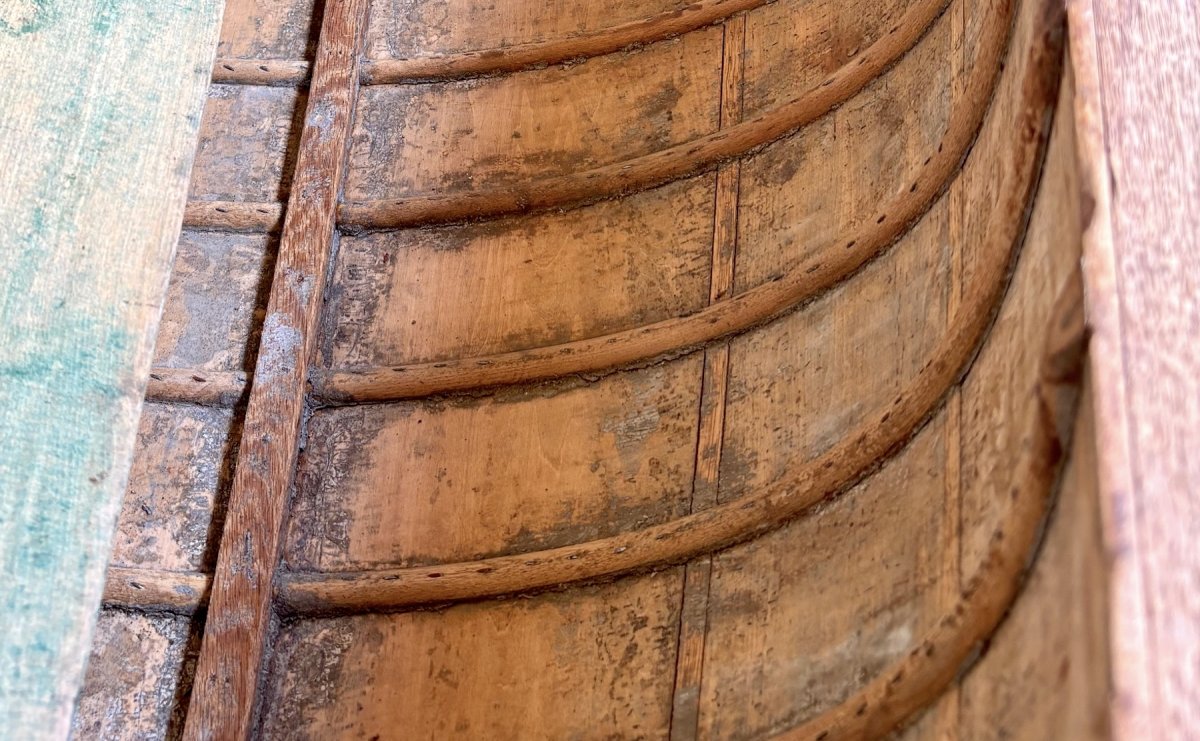

I don't have a picture of before I started filling planking. But only now do I notice this canoe has been pulled over rocks, sharp rocks. The lengthwise lacerations are numerus. I started filling the worse but soon realized I'd be filling the entire hull. In a canvas canoe nothing would show and none are bad enough to be structural. This planking is 1/8th inch. Canvas covered is typically 1/16th. I may opt for a paint that fills, porch paint I'm told.
I'm open to suggestions..........

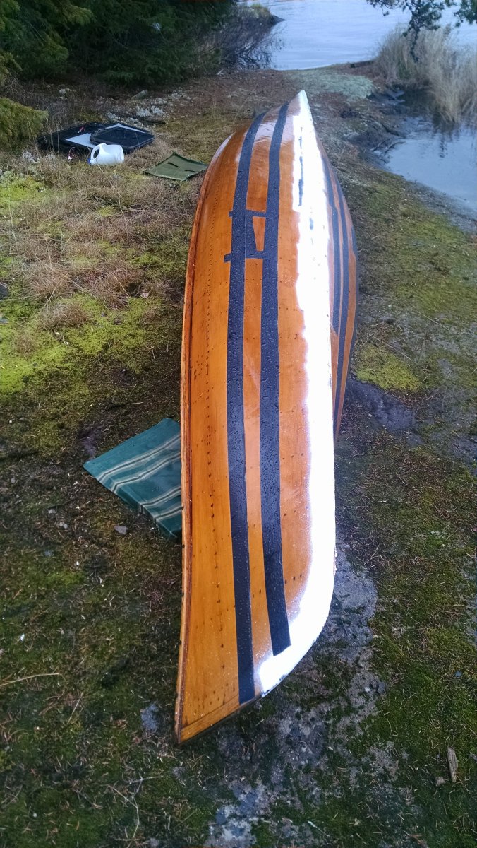

I have a longitudinal planking canoe... no canvas. What we are calling "wide board" can be two things....three boards, (what I'm working on now)...or four boards which is the photo earlier that I tried to stop leaking with tape and foam. The simple answer...there are three Peterborough non-canvas canoes. I have two. The "cedar rib", where the "planking" is transverse the canoe, I've not seen. I'm presuming Peterborough set the pace, at least in terminology. That third picture above would be "longitudinal strip." I hope that's clear.:rolleyes:

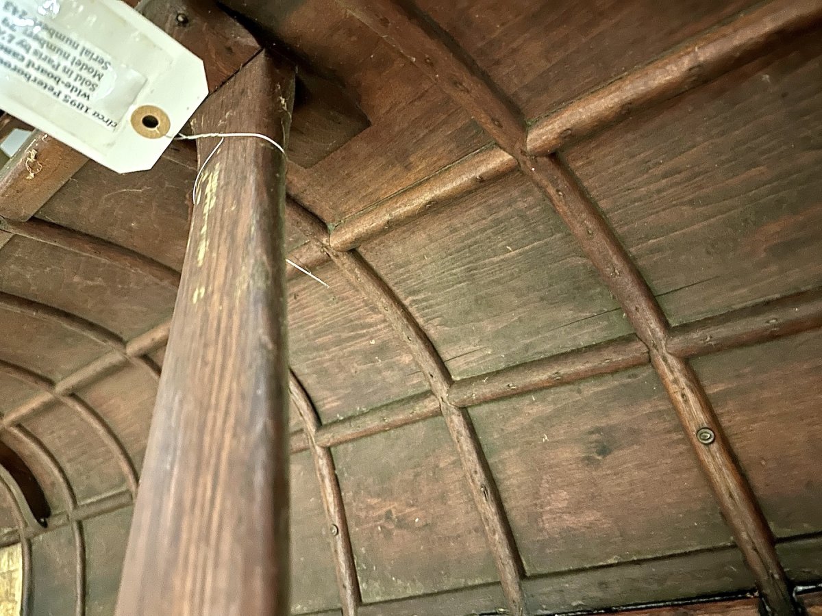

All-wood canoes were built in a wide variety of manners, especially if you add into the mix builders from the US and Europe. The old Canadian builders themselves produced a variety of kinds of all-wood canoes, and their history evolution began long before the Peterborough Canoe Company started in 1892. Canadian all-wood canoes included:
1. Rib and batten canoes, also known as wide-board canoes such as the Bush being discussed here. These are most often seen with basswood planking, though they were also built of cedar, cypress or mahogany, with widely-spaced interior ribs. The battens are made of rib stock.

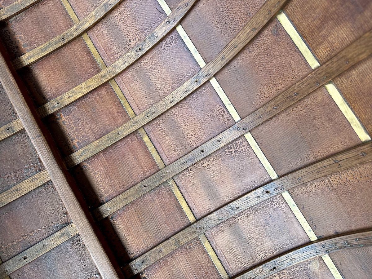

2. Metallic joint canoes, in which wide boards were joined along their edges with brass or copper strips, somewhat like an extremely long staple that runs the full length of each joint from bow to stern. The battens are visible between the narrow ribs lying interior to the planking and battens.
Metallic joint

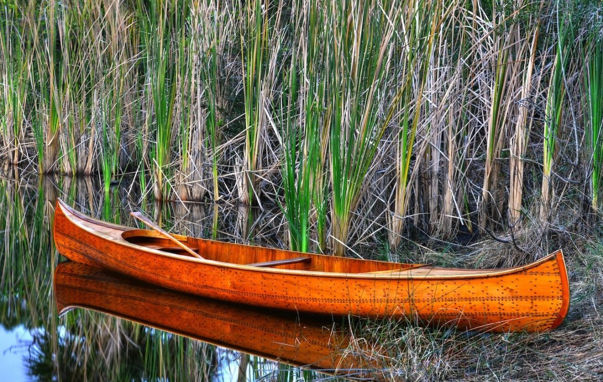

5. Cedar rib canoes. These have a single layer of planking running gunwale to gunwale, and these “ribs” mate with each other via tiny tongue-and-groove joints. Along with the gunwales and keel, lengthwise hardwood battens held everything together with a fastener through each “rib” each the batten.
16' Peterborough cedar rib

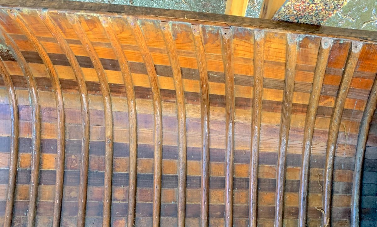

6. Longitudinal strip canoes. Numerous narrow ribs with narrow lengthwise planking nailed on, each plank joining the other via half-lap joints. Sometimes they were made with alternating species of wood to produce the pattern shown here (sometimes called "candy stripe" today).
16' Canadian Canoe Co. longitudinal strip
