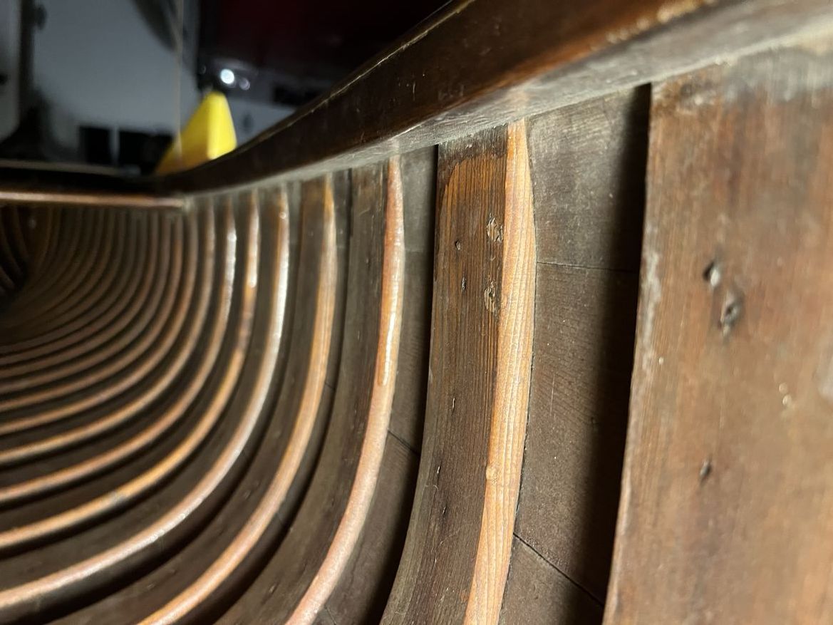

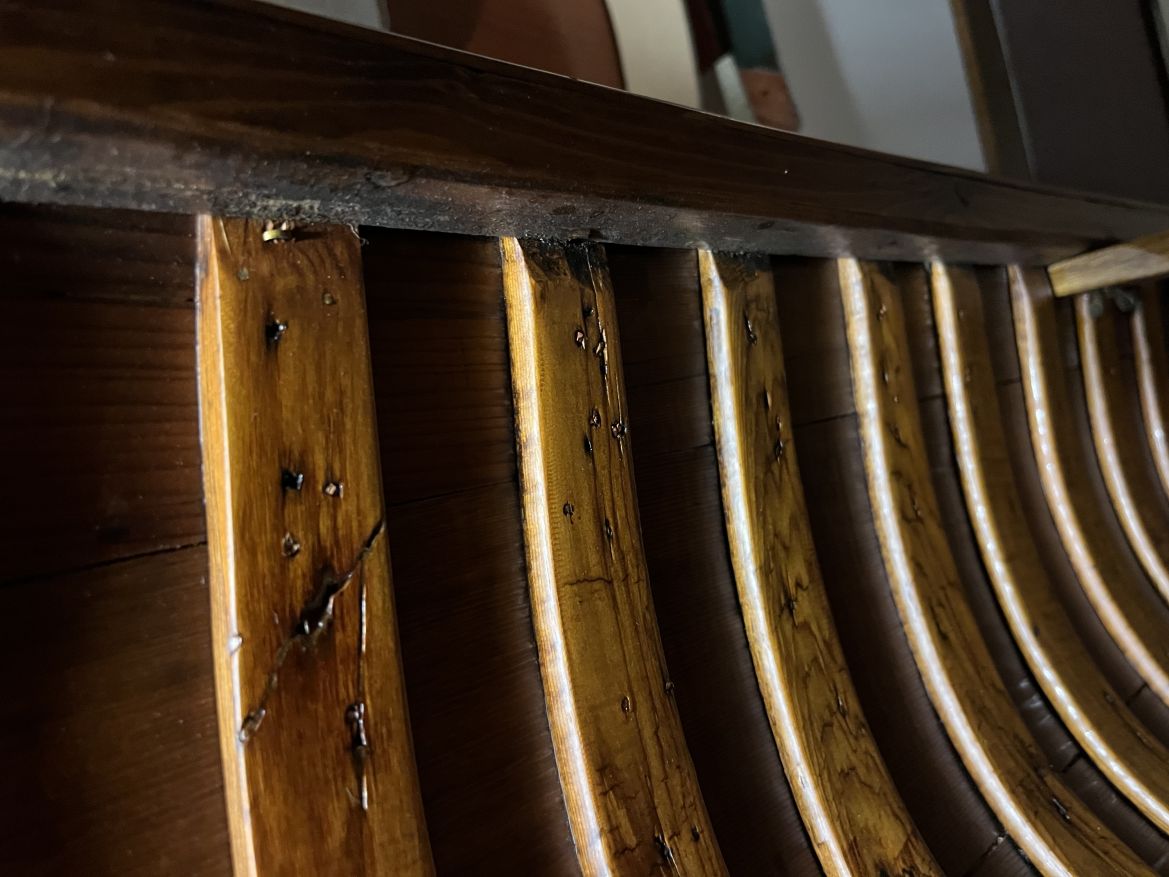

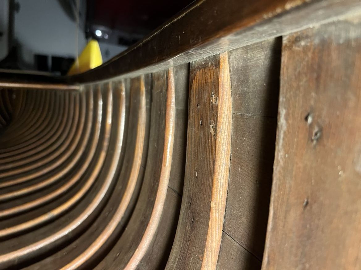

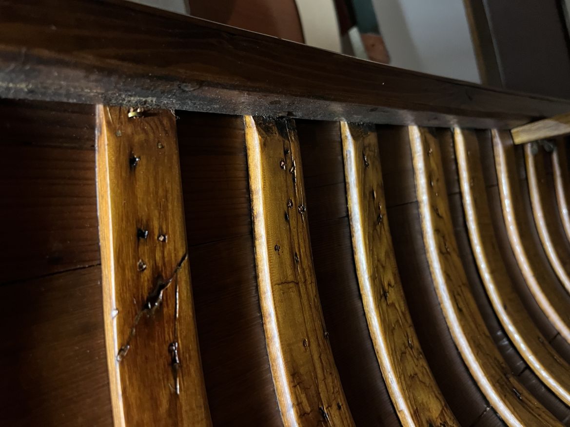

Interestingly, the inner and outer gunwales, and the decks, are all cedar. The decks are very small and plain. They are slightly undercut to provide a better hand hold.
There are five thwarts, all oak, with round center contour and flat ends. One is amidships, two are about 3-1/2 feet fore and aft, and the two at the ends are about 1 foot long (so bigger than carry handles). The inner gunwales have mortises for both ends of all the thwarts.
The inner gunwale is routed out for every rib top. The outer gunnel has a wide rabbet that leaves just a little lip over the top of the last plank. There are evenly spaced nail holes in the inner gunwale which may mean there was a cap, to make a closed gunwale.
The spacing between the ribs is about the same as the rib width at the bottom, but the ribs taper considerably towards the top.
I have removed the fiberglass, seats, and out gunwale, and I have started stripping the varnish off the interior.

Following up on my previous reply, here are the details I have recorded as I have worked on the canoe.
-Worth
Length: 18' 5” max, 18' just below gunwale
Width: 36” max, 33” just below gunwale; tumblehome continues for most of the length.
Depth: 24-1/2” at ends, 14” midships
Symmetrical; no rocker; shallow arch bottom.
Decks: 11” long, 3” wide; concave on open edge; bottom of open edge rounded as if deck might be used for carry handle; possibly oak.
Thwarts: 1 center, 2 quarter (74” from ends), 2 end (40” from ends); end thwarts missing but remaining 3 thwarts are oak, oval for most of the length, and flat at the end for the 1/4” x 2-1/4” mortise into the inwale.
Seats: unknown due to later replacement. May not have been any.
Stems: oak; extending over first 4 ribs and partially onto 5th rib; 3/4” (actually 0.80”) thick over full length; 7/8” wide tapering to 3/8” at top; contour square at bottom tapering to triangular at top; not visible at top, i.e. ending below decks.
Ribs: 44 in number; width from 2” to 2-1/2”, down to 1-1/2” near the ends of the canoe; spaced 1-3/4” to 2-3/4” apart at the centerline; all rib edges beveled full length; no cant ribs but last 3 at each end made in halves instead of bent; ribs strongly tapered to widths of 1” to 1-1/4” just below inwale; rib ends as thin as 1/8” x 3/4” at attachment to inwale; rib tops curved to match inwale notches; ribs lean towards the middle of the canoe, progressively more toward the ends, with a tilt of 8 degrees at rib 10 (halfway from midship to ends).
Inwales: nail holes remain from original gunwale cap (so originally a closed gunwale canoe); curved notches for every rib end, with the notch starting from nothing at the bottom on the inwale, and reaching 1/8” depth at the top (this tips the rib ends inward at the top for tumblehome while keeping the gunwale horizontal); mortises for thwarts extend all the way through the inwale; tapered alongside decks to about half width at tip of deck; overhanging planking about 1” at ends; wood is light, possibly cedar or spruce; full length pieces, not scarfed.
Outwales: unknown due to later replacement (not sure if cedar or spruce; poorly scarfed).
Planking: width from 2-1/4” to 4”, except that center plank is 7” and full 18' length; planks have beveled edges from the bottom up to the top plank amidships (and any above that at the ends), which have straight edges.
Fasteners: planking attached with clinched copper tacks; rib ends attached to inwale with steel ring nails; ribs attached to stems with various steel nails (tacks, ring nails, finish nails – perhaps not all original).
General: considerable variation in rib width and spacing, and variation in planking width; this seems to indicate a variable lumber supply, or a relaxed non-perfectionist attitude by the builder, or both.
Hello Worth,
In your earlier correspondence with Al you note that the planking edges are squared.
In your recent overview of your progress, you mention that the planking edges are beveled.
A reason Al was asking this particular question is beveled planking was not a very common practice. EM White, one of the earliest Old Town builders was known for this practice. EM White was also known stubby little decks as seem to be evident in your canoe.
You note that the canoe tacks are copper. That suggests an early construction. Brass tacks do not appear as early as this canoe was likely built.
Mortised thwarts also suggest a very old construction. This style of build was a transference of birch bark canoe construction methods to more modern boat construction and suggests a build earlier than 1900.
Al is spot on that the boat has been tweaked along the way and also that it appears to be an early Maine canoe. It should have had single piece outside rails extending beyond the stems, possibly cane lashed. It was very likely built without seats.
There are several members of the WCHA who post here from time to time who have the depth of knowledge to properly assess what you have. Rollin Thurlow (Northwoods Canoe) is one such person. Jerry Stelmok (Island Falls Canoe) does not post here but he is considered to be expert on the White canoes. He has the original White forms in his shop.
If I were in your shoes, I would be giving Jerry or Rollin a call to get their thoughts about this canoe.
In my opinion, the canoe is one that should be restored. I would be trying to eliminate all signs of previous repairs and attempt to return it to original condition. Seats probably do not belong in this canoe. Neither do brass tacks. Copper tacks are available. I would lean towards a canvas and would not consider Dacron.
You are working on a very interesting old boat.
Mike
