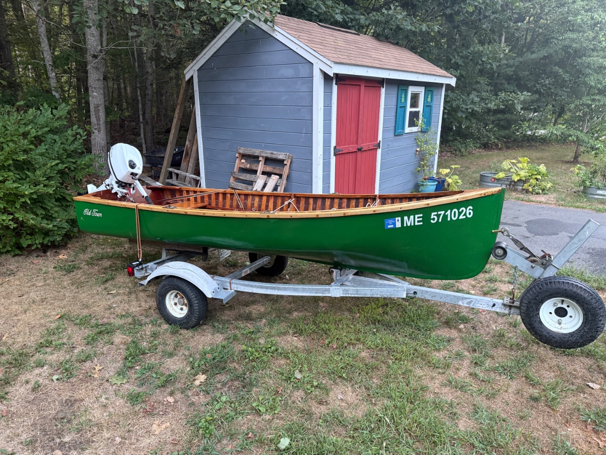

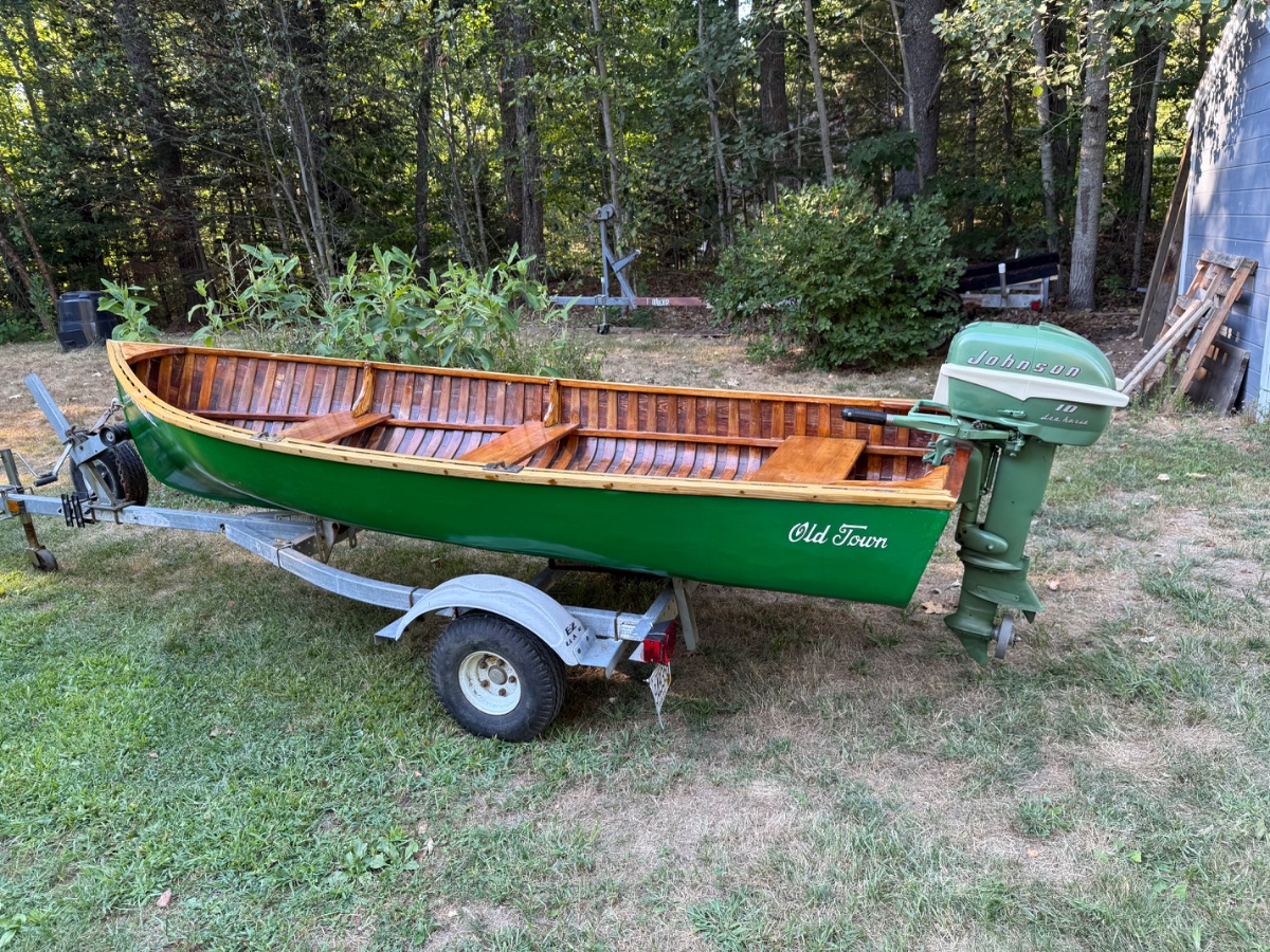

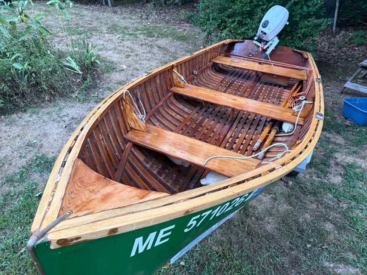

I want to give everyone who has an interest in my square stern rowboat project an update. A friend in Somerville Maine was a huge help in the re-canvasing part of the project. I finished the rebuild with new outwales and paint and had her first launch on Pemaquid Pond last month. I put one of my antique outboards on for show but replaced that with a new Tohatsu 6 HP for her trial run. I am very pleased with the way she turned out.

Totally agree with the outboard choice. For years I kept a period correct motor on my boat all the while hating the oil slicks I was leaving behind. I was ok with carrying tools and fixing it on the fly. I owned British cars and motorcycles so the concept of having to repair something during or after every drive was familiar. My new Mercury starts with one pull, nothing vibrates loose from it and it does not stain the water with a big oil slick.
Your boat came out nicely. Well done.
