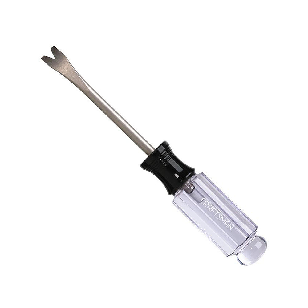

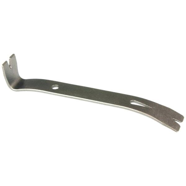

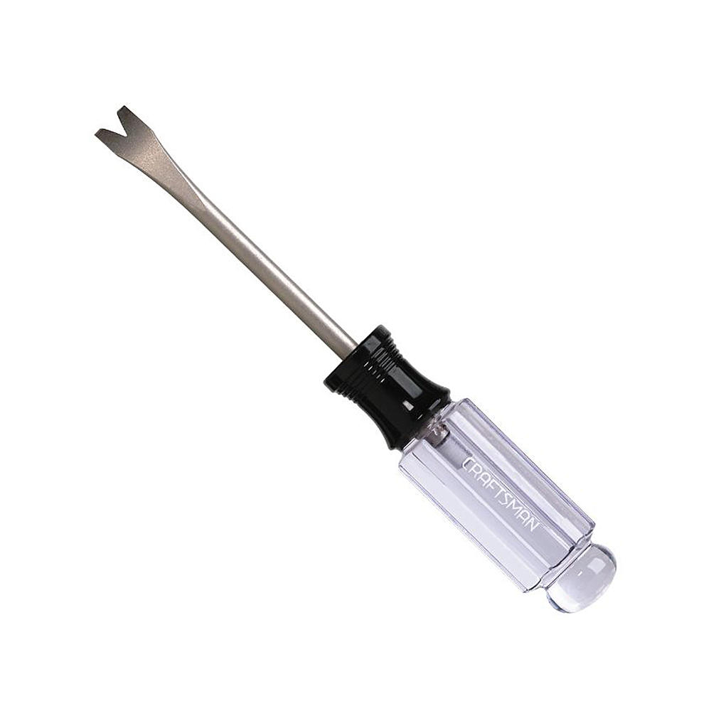

There's no need to remove the tapered ends from the sponsons - this will just make more work for you later. If you haven't taken the other one off yet, just remove the whole thing intact. More generally, just look at the boat and you can see how it was put together. Leave as much together as possible as long as things don't interfere with what you need to do. These boats were built starting with the hull itself (inwales, ribs, planking), and then all the add-ons were installed (deck framing, decking, seat cleats, seats, etc.). Removing the add-ons should pose no problems, but as said before, you don't want to remove inwales unless necessary (because they're seriously damaged).
And yes, get a decent tack puller - it's cheap and will make your life much easier. Like any tool made for its purpose, a tack puller it will make pulling tacks easier and will help reduce damage from the tear-down. See the images below for two examples. I use the simpler one on the left most often; I grind the tool a bit to make a sharper edge which is easier to get under tack heads.
View attachment 43168 View attachment 43169
