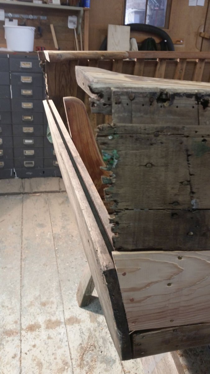

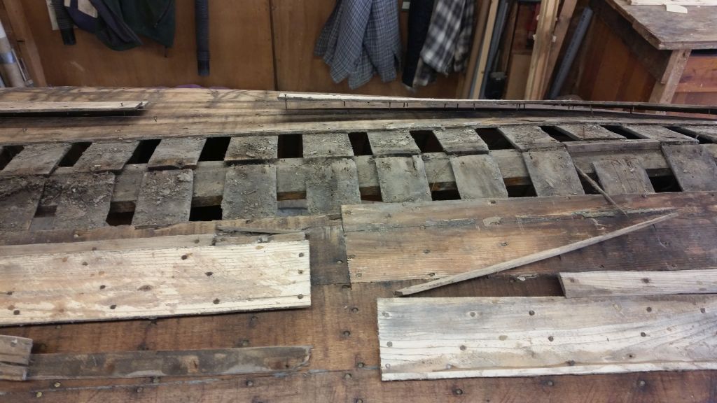

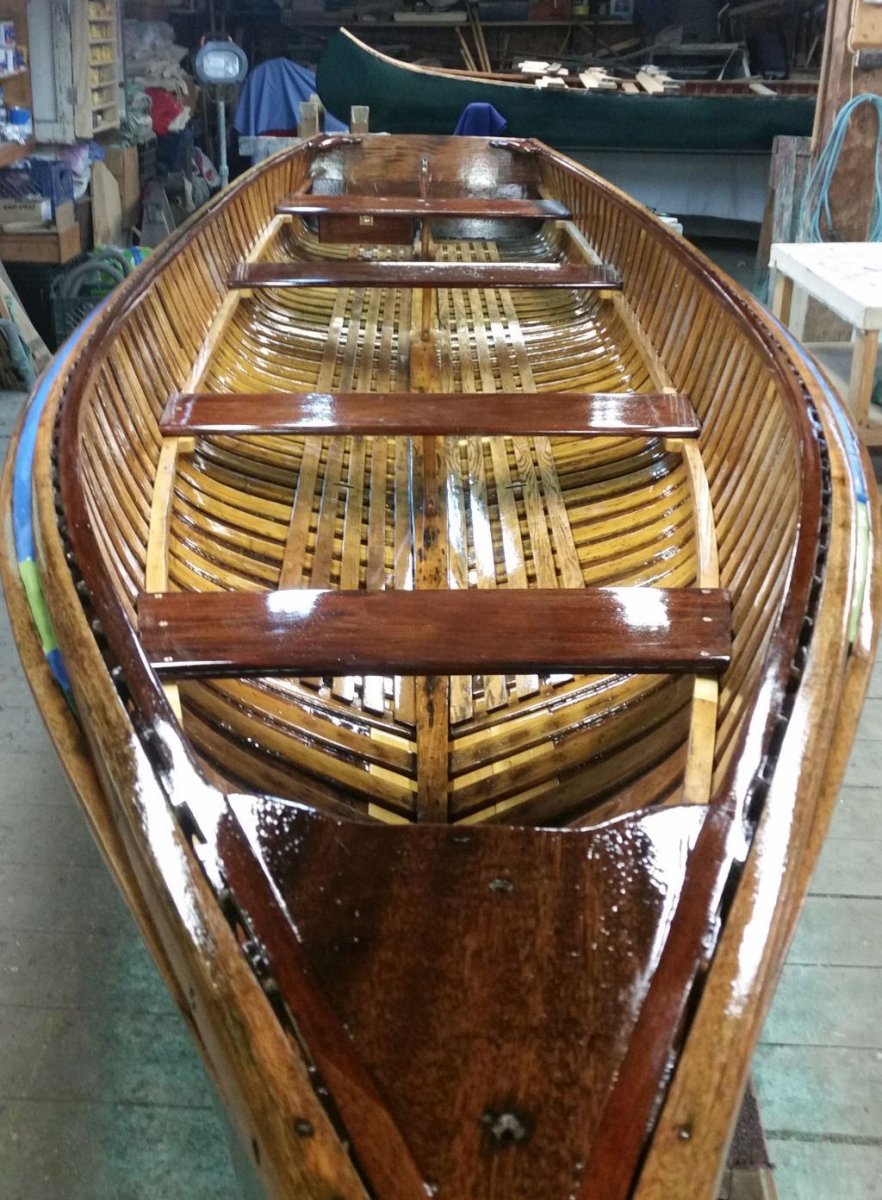

If you can see those bad planks, then I'd go with the other boat.
We worked on a similar square stern a while back that had had other work done some years ago. The old problem and the new were caused by water between the fiberglass and the planks. We replaced both garboard planks and one adjoining. The transom had been glassed and the top board replaced with oak instead of Mahogany. This is a 1935 AA Sq St with sponsons. The transom boards had a dado or groove on the joining edges that had a spline in it. The leaking between these boards had turned the spline to mush and so the leaking continued. Originally it would have had Mahogany rails and wider seats but the owner wanted what was there.

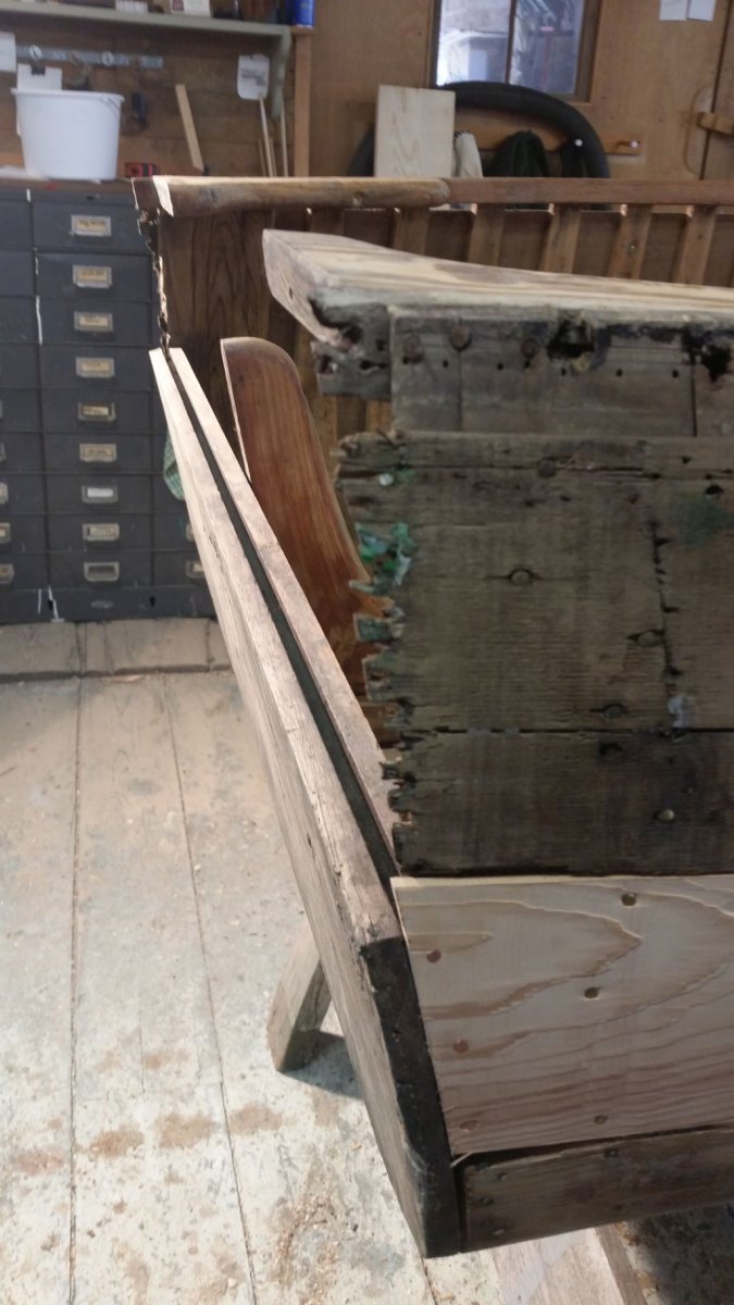

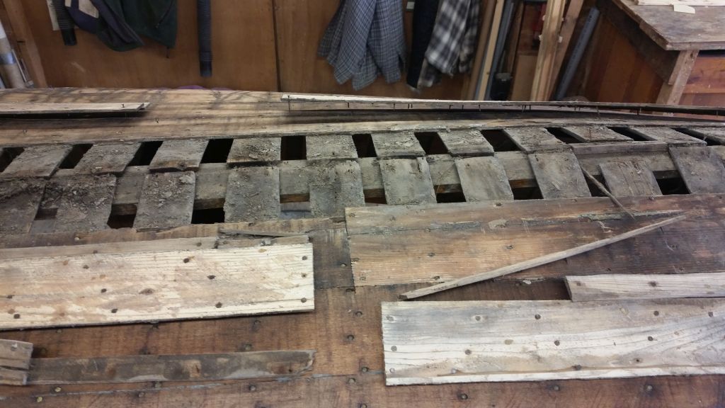

View attachment 42989 View attachment 42990 View attachment 42991
