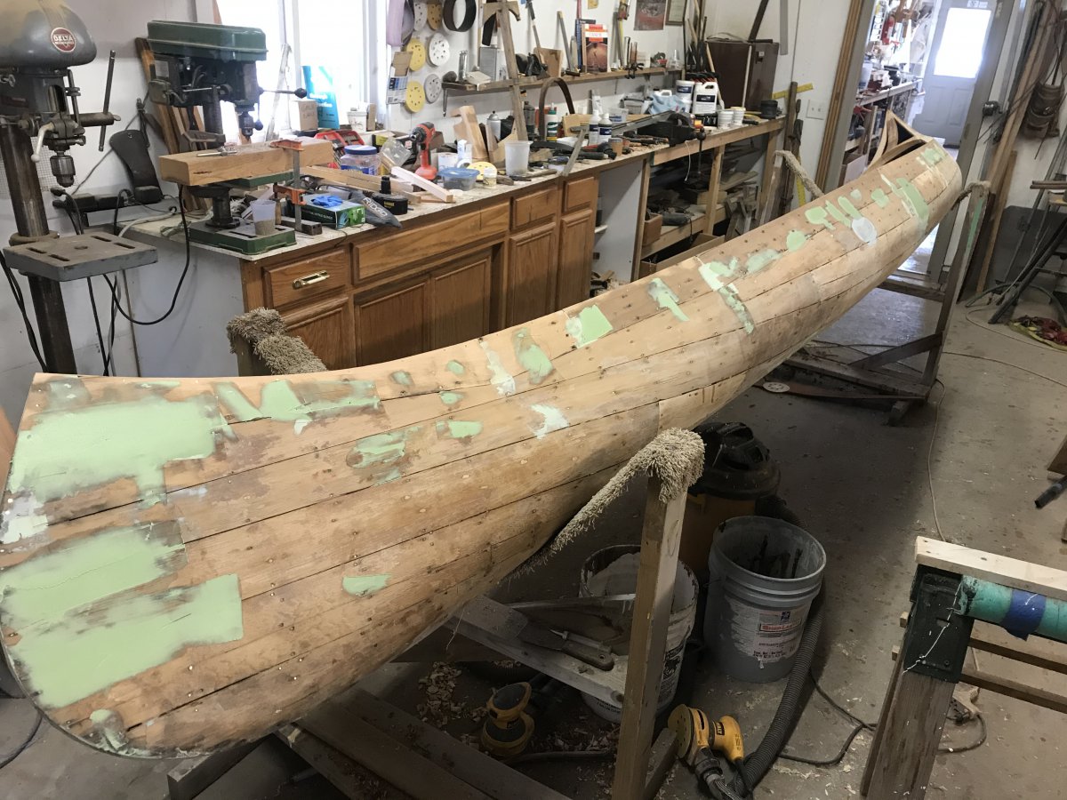

Question about fairing the hull prior to canvas: how much am I able to sand it fair since the planks are only 3/16 thick? Do you guys use fairing compound on the hull at all?

You can fair the hull only as much as it allows. I use 60 grit on a random orbital sander.
You can use a fairing compound where there are spots to fill. Be sure that no compound gets between the planks, as it will show through on the inside. Typically you don’t need to fill tack holes, as the canvas will bridge those.
When you sand, you will likely expose tack heads that are proud. You should take the time to re-clinch them, or they will show up in your finished product.

I got the first pass done with the random orbital and am still seeing low spots at the seems. Does the canvas typically “float” over these low spots or should I remove more material?

Wood changes over time. What was likely a very fair hull in 1910 is now full of lumps, humps, and low spots.
You can apply a marine grade fairing compound to fill in areas that you think need it. In general, unless the area has real tight planking or is under the decks where you can’t see it, stay away from planking gaps. After it cures, sand it smooth to blend in with the adjacent wood. You may need more than one application to completely fill the areas. It will likely never be perfect, but you can remediate some bad areas.
I use a product from Jamestown Distributors called Total Fair. It’s a 2 part epoxy compound. I’ve been using it for many years with no failure.

Thank you Dave that is super helpful. I’ll take some more material off where I think I can get away with it and use fairing compound as you suggest.

Greg, the fairing you’ve done may highlight more planks that are cupped and need tacks to pull the planks down to the ribs. Don’t fair so much that you compromise the tack heads, and re-clinch the ones that the sander shined up.

I have a lot of clinching to do for sure but I think I was able to sand it fair in most places without compromising the planking too much. I did have to tack some more cupped planks down in the process.
