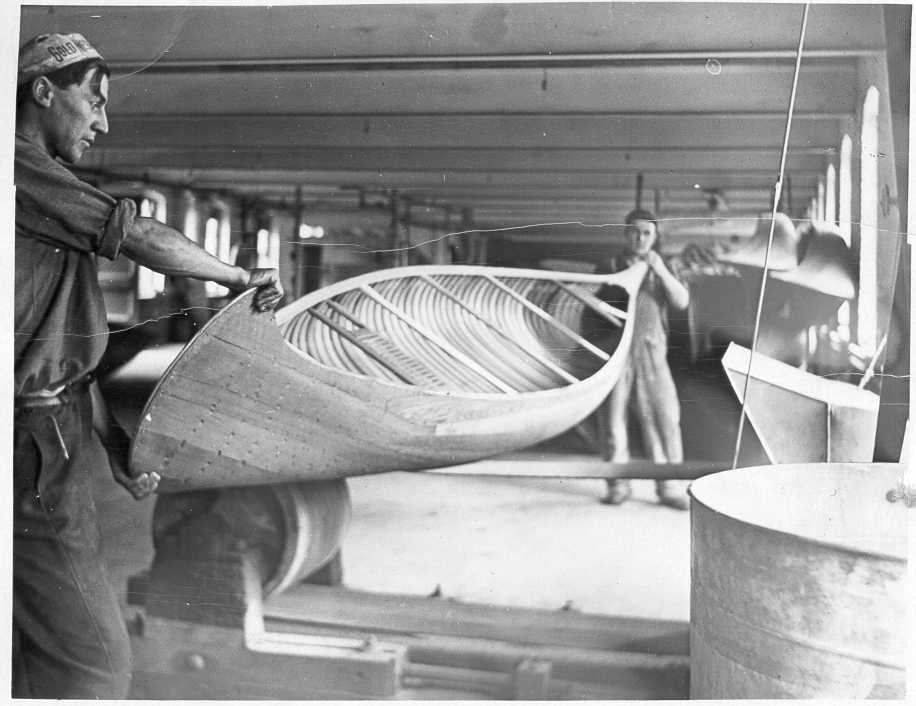

Greg, what grit(s) are you using. Big difference!
Hi Todd,
I started out with 80 grit but it was taking too long so I stepped it up to 60 grit on a random
orbital as Dave Suggested. Interestingly the planks don’t seem to have been faired at the factory in 1910 as the original saw marks were still present throughout.
Their non-OSHA approved fairing technique shown below was probably not developed until after 1910.
Todd F
Lifetime Member
OSHA SMOSHA...boy would I love to have one of those! Actually very impressive how they must have been able to "feel" how much they were fairing and when to back off. Great photo!

Dave, I think you are correct. Not sure where though. Pretty impressive, these folks were studs.
