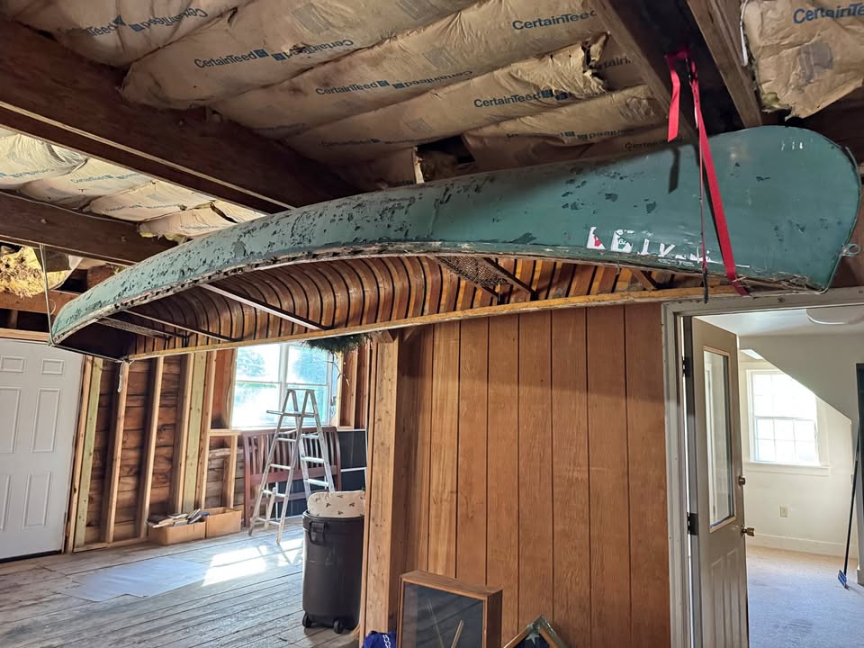

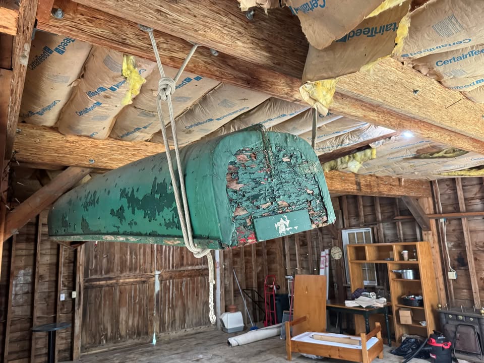

I recently rescued a 16 foot 1976 L.A. Picard square stern Canoe. It appears to have cedar ribs and a fiberglass hull. I'm planning on restoring it and am looking for images of what it looked like new. I'm mostly interested in the transom, which is very rotten and has had several repairs.

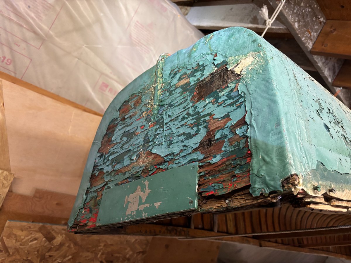

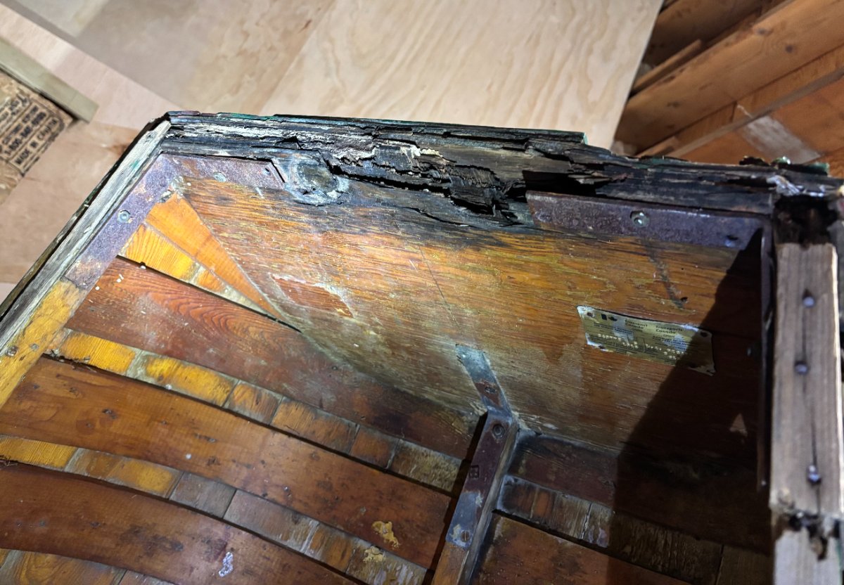

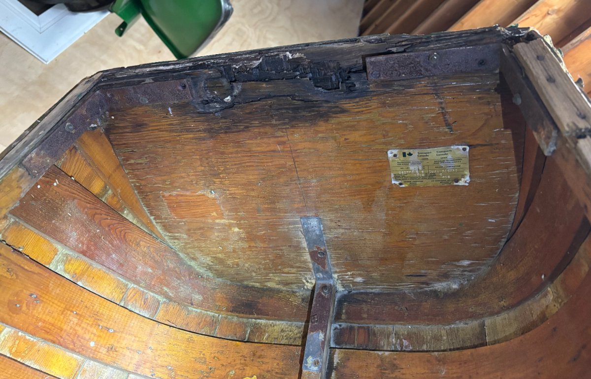

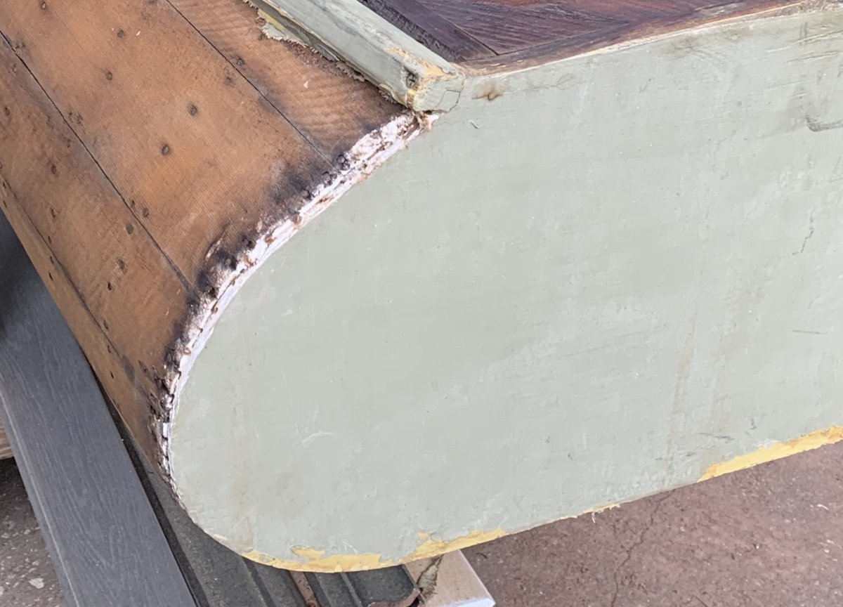

Here's a few pics of the transom. I'm sure the glass added to the outer edges was done as a repair as the person who did it didn't seem to own any sandpaper. I'm not sure about the 3 Steel L-Brackets on the interior. I suspect they were added as a repair, but the fact that some are through-bolted makes me wonder. The transom is about 1.25" thick

Ah, okay. no inner frame, just nailed through the furthest end of the planking and rib, and knees to hold it. take it all apart being careful with the last piece of rib, and whoever glassed it relied on the overlap as well. if it were mine i would make the transom knee and the gunwhale knee out of hardwood, nicer looking than the steel brackets. canvas or fiberglass will need to be brought around to the transom to wateproof the joint where the planks attach since there was no inner bracket. More usually the covering will wrap around then the transom board will go on last, but its not a problem to do it that way. will be a nice canoe when its done
this is a better way to build, but that way will work just fine as well. the builder didnt bother with an inner frame but between the brackets , plank fastening and glass its all good
yeah, I had the same thought about making hardwood knees. I've got some half-inch okume. I'm thinking I'll epoxy & glass two pieces together for the new transom.
That said, why is the above method "better"? Mostly as there is no way to capture a traditional canvas covering , so they shortcut the whole thing with plywood and glassed around it rather than frame it

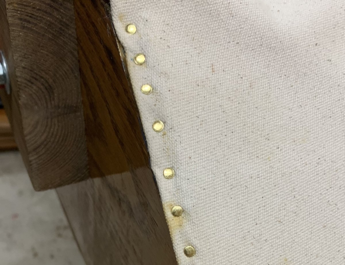

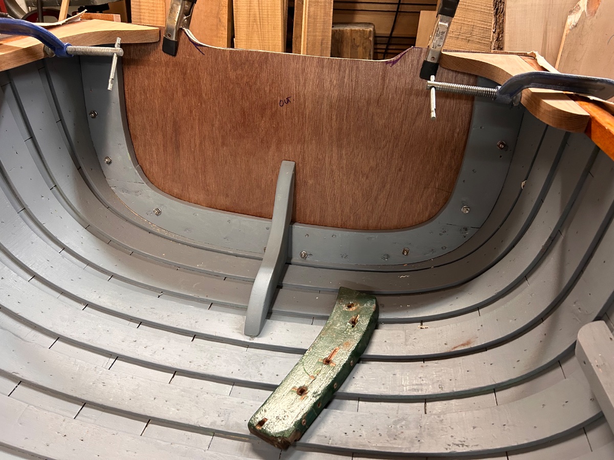

At least some manufacturers didn't use any kind of frame. Instead they neatly attached the canvas around the perimeter of the stern. Here's one example from Penn Yan (and I think some of our celebrated modern builders have built square sterns much the same) in which the transom is mounted, there is no frame inside or outside, and canvas at the stern is doubled and attached around the perimeter. Not saying this is better or worse, but it works. I've had multiple boats built this way that still had their original coverings after some 80 years, still intact at the transom even if damaged elsewhere. With a little care and fitness, the end result is very neat and long lasting. Different strokes...
