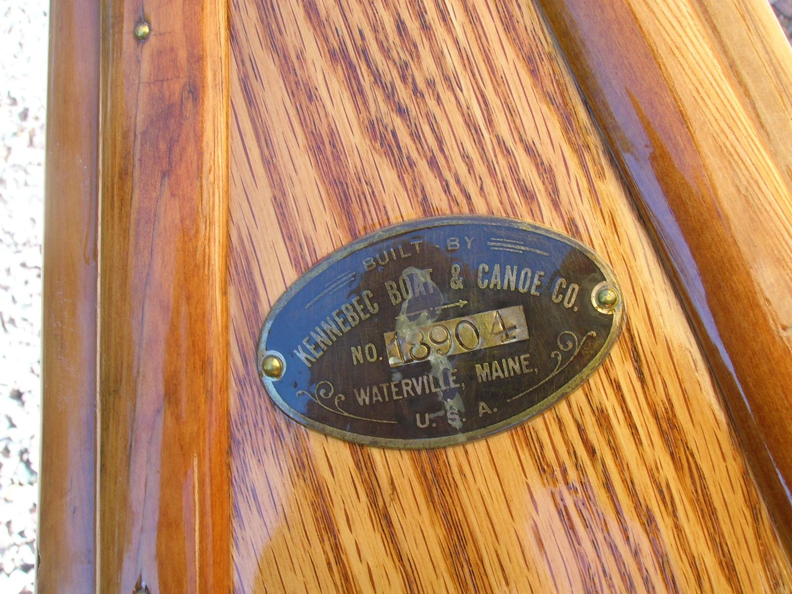

Back again with another question. There is currently a Kennebec canoe listed on E-Bay stating it is in original condition. To me, it looks like the seats are fastened different and the seats are not caned. Would this be correct?
Yes, troubleshooter-- the seats on that Kennebec are strangely hung and should have been caned using the 7-step method. It's also unlikely that it's a 15 footer, as I am seeing two thwarts and I think 15ers have only one.

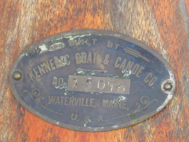

The seat drops, seat material, and seat bolts all appear to be replacements in the canoe at http://www.ebay.com/itm/251763994103 on eBay. The screws on the metal tag and keel do not appear to be original either. The pictures at http://s695.photobucket.com/user/DeepSeaToddMaci/media/canoe5.jpg.html and http://s695.photobucket.com/user/DeepSeaToddMaci/media/canoe3.jpg.html show the seats in a more original Kennebec. The ones at http://forums.wcha.org/attachment.php?attachmentid=6458&d=1188766934 and http://forums.wcha.org/attachment.php?attachmentid=6432&d=1226254804 show the nails used on the tags originally. The asking price of this one also seems to be very optimistic. The Kennebec records identify this as a 16 foot long canoe that shipped on March 25th, 1930. Good luck,
Kennebec placed the serial number plate of my 1927 Katahdin model on the stern deck... and the serial number was also on the bow stem (tamped into the wood).
