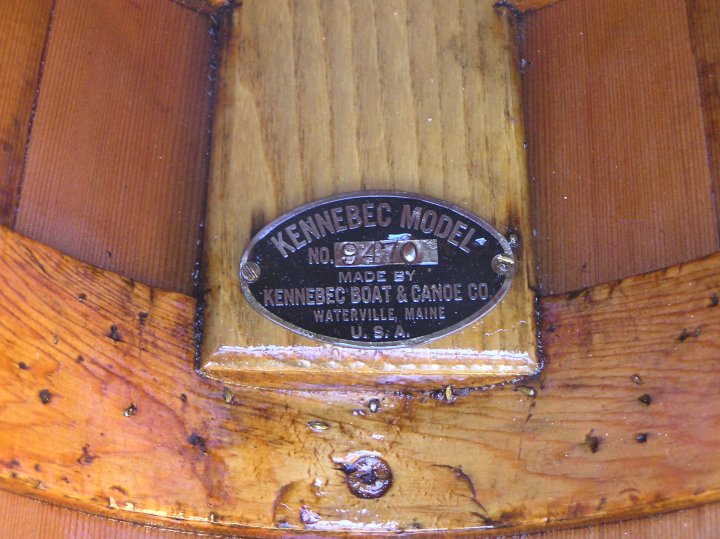

My 1916 17' Kennebec model SN 9470 has ash splayed stems. It makes some sense that these "hybrids" may be entirely Kennebec built, unless someone has definite proof that they were partially built with Morris components. The splayed stem differs from the Morris profile, so why would anyone go to the trouble of reshaping the stem, or if the hull was already planked, redoing the planking to match the new profile. Mine had riveted stem bands, done late in the process. With these differences, it begs the question of what anything brought in from Morris might have looked like, or even why, since so much must have remained to do. Where were the savings in time or money? How were the parts were held together? Did Morris bend the stems in the Kennebec profile and just send them that way? Either a Kennebec form that was modified to accept the different components must have been used at Kennebec some point, or Morris had such a good supplier relationship that they had a Kennebec profile form and the Kennebec build records were filled in as each batch of hulls arrived. We may never know.

One more thing. The oval tag on my Kennebec Model doesn't look like it would fit on anything or anywhere except a splayed stem or the deck, even if it was turned sideways:
http://forums.wcha.org/attachment.php?attachmentid=569&d=1121048050
It is a very nicely made piece, stamped and with black background, obviously later than the one shown in this thread, but similar in shape. Certainly not a makeshift afterthought. Why spend money on making and stocking these tags unless this was very common? Without going back and looking for picture evidence in the forums, (and I don't have the catalogs) are there any Kennebec "Kennebec Model" canoes from this early period, (about 1910 to 1916), documented that are not of this type of construction? It might have been pretty standard for a number of years, defining the type, and only changed later in the Model run.
