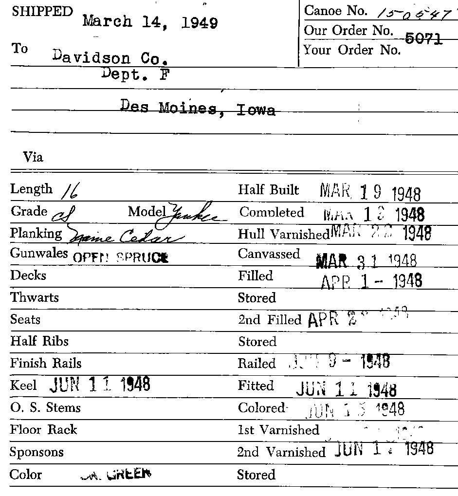

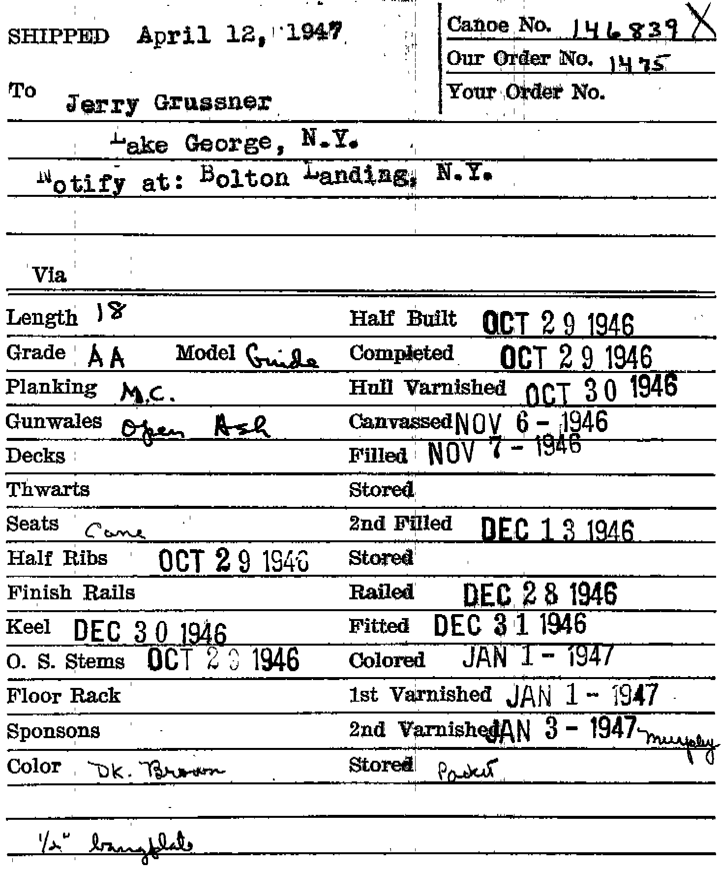

Gents, this is a great thread for me. I also have an OT that I've just stripped the paint from (inside) and will have to deal with all of greenvilleguy's same questions. One thing caught my eye though, that being that OT's have red cedar planking. While experimenting with getting rid of the paint I tried a sample patch with fine glass bead (with the expected result), and the planking was just as white as white could be. So now I'm as puzzled as puzzled can be.
Did OT ever use wh. cedar for planking? The canoe appears to have been built somewhere between 1949 - 1960's (no ser.#). Yikes....!
Yep did that more than once. Had to go back and tape off and stain all the new wood. Now before installing any new ribs or planking I stain it. My mix is minwax golden oak, a touch of walnut, and a little red oak. Somtimes it needs lightened with some natural. I oil (boiled linsed) an old plank (removed from boat) to match the color. When I am all done I put a little of this stain in the oil/spirits mix to blend the rest of the canoe...

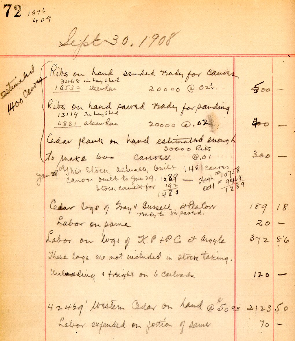

As to the cedar many of the earliest canoes were white cedar planked. You can see in the boat of the 1900's and in the teens some of the canoe planking got narrower. The wide white cedar planks got harder to find and finally in the teens somewhere they switched to western red. Even after the switch in the CS grades some AA gades had white cedar planking...
My research indicates that western red cedar was in common use from the earliest known Old Town Canoe Company records. A portion of their inventory from September 30th, 1908 at http://forums.wcha.org/attachment.php?attachmentid=7595&d=1242342933 shows 42469 board feet of "Western Cedar on hand" at the bottom of the image with various amounts of local white cedar ribs, planks, and logs above it. This came from a company ledger that has entries for Western or red cedar from 1905 to 1932. The information at http://forums.wcha.org/attachment.php?attachmentid=18732&d=1322443967 has more details about their use of both types of cedar in the 1930s. Old Town always tried to use white eastern cedar for their ribs and red western cedar for the planking when available.
