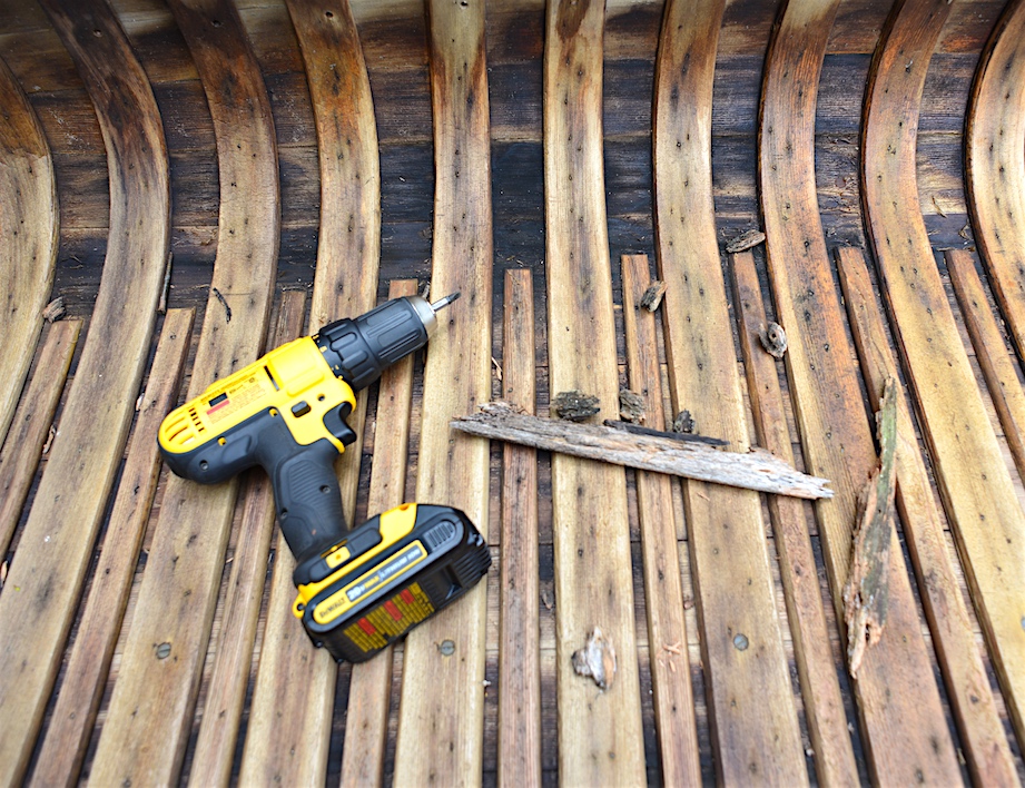

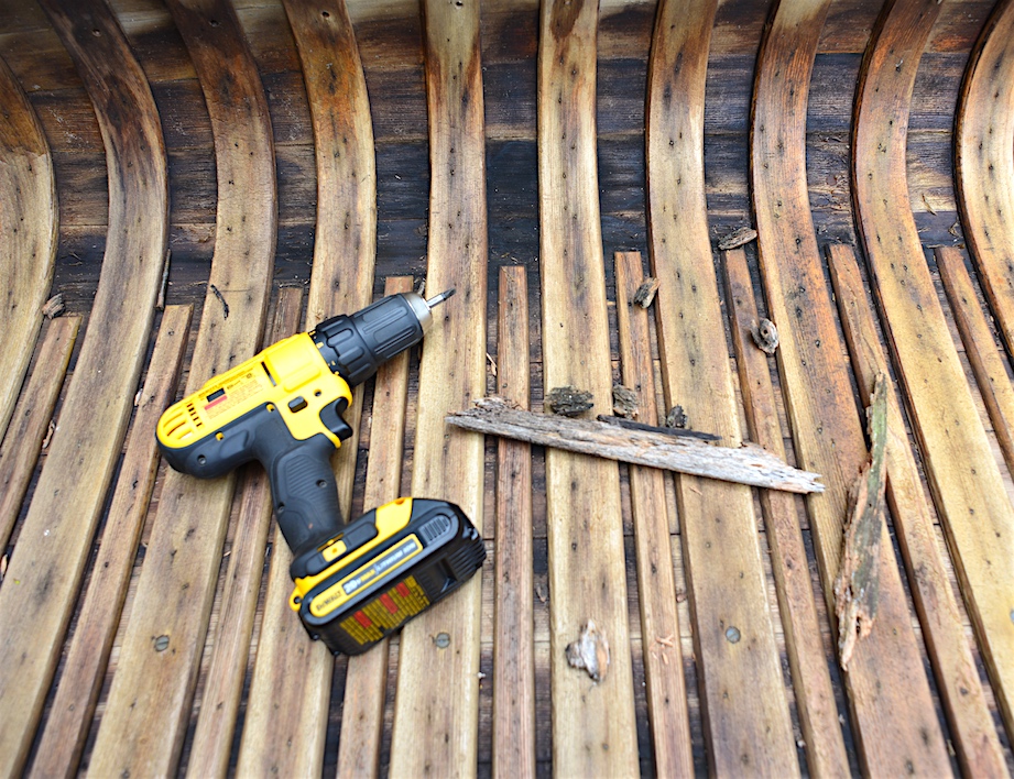

what causes the inside of the planking to be black?
There are many possibilities, it may be old paint, old varnish will turn black (as shown at the link below), standing water (as shown at https://forums.wcha.org/attachments/40018/ for example), or a combination of factors. This might be a great chance to try out some new techniques and improve your skills without having to worry about ruining a nice canoe. Chris Merigold did that many years ago and called it "Merigold's Marvel." It provided some great articles in the Wooden Canoe magazine. Most people here would encourage you to "bring it back to canvas." Good luck with the decisions,

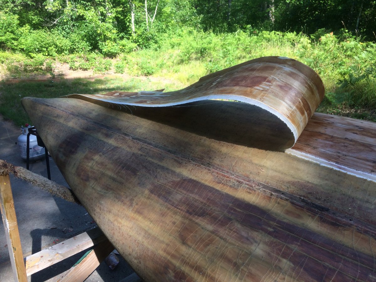

Dan,
I have not tried or heard of scoring the fiberglass. I can’t even think of an effective way to do it.
A utility knife will have a difficult time cutting through. A fine saw might go too deep.
I think you’ll find that it may come off in long sheets for the most part.
I can only think of one canoe out of dozens of glass removals that was much of a problem. For the tough spots, use the heat. For the residual resin on the planks, I suggest the heat gun and a pull type scraper. Do not sand it until the resin is gone.
The glass edges are sharp as hell. Wear gloves.

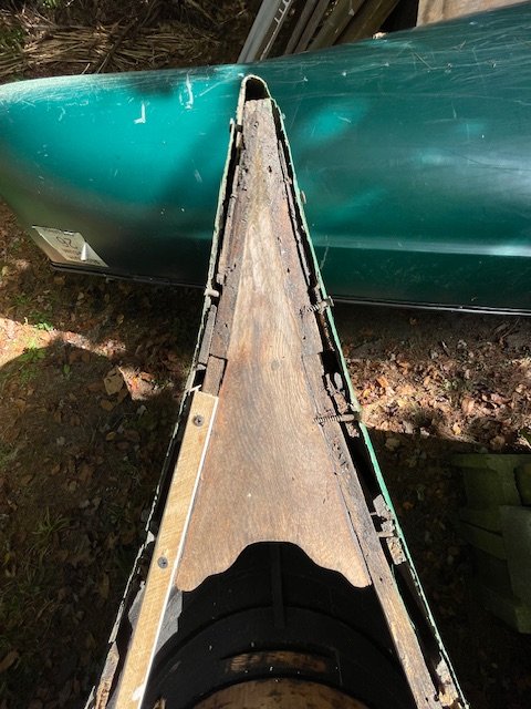

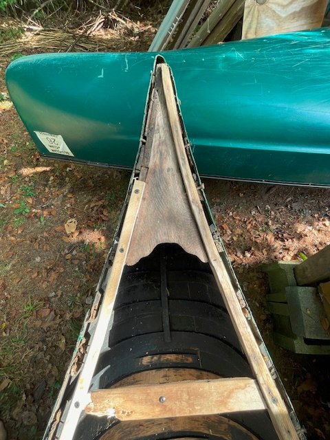

Hi All,
I'm finally finding the time to start digging into this canoe. I've been reading the forum and looking at the canoe trying to think of things that might help identify it. I'm wondering if it may be a Huron canoe or something similar based on the gunwale/deck configuration.
Here are a few more points that will hopefully help. I have not taken the fiberglass off to look at the planking but do plan to.
It has inner gunwale caps. The outer gunwales are gone but the caps clearly were made to cover only the inner gunwales. The screws for the outer gunwales are still there so I was able to get dimensions but the screws do not look original.
The thwart bolts are recessed into the inner gunwales.

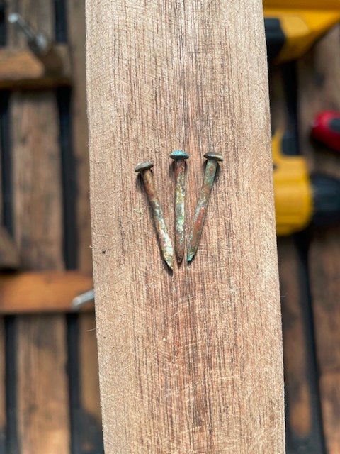

The gunwale caps were attached using brass or bronze nails.
Some dimensions,
Inner gunwale is 1" x 7/8"
Inner gunwale cap is 1/4" x 7/8"
End of the inner gunwales to roughly the end of where the deck point would have been is about 7". The bow and stern dimensions are the same.
Outer gunwale (based on screws) 3/8" thick
The rib dimensions varied +/- but the average dimensions are...
Rib width 2 1/8" tapered up to 2"
Rib thickness 3/8"
Distance between ribs is 1 7/8"
Planking thickness (tough to measure due to fiberglass still on) roughly 3/16"
Attached are some photos of the decks, nails, and bolts.
One of a shakedown paddle to see if we liked the ride before diving into the project. She is not fast but steady and carries momentum. We got 3 and a half yes', my wife only gave a half yes... "Looks like a lot of work" lost half a point.
Disregard the piece of pine screwed to the gunwale. That is keeping the gunwales as a continuous piece. They need work.

Your pictured nails are likely escutcheon pins. I presume they came from the inwale cap, and are a decorative and often stouter ‘nail’ than a brad or wire nail.
Is this the same canoe? The decks look different than originally shown.
Those highly shaped decks would not be typical of a Huron.
