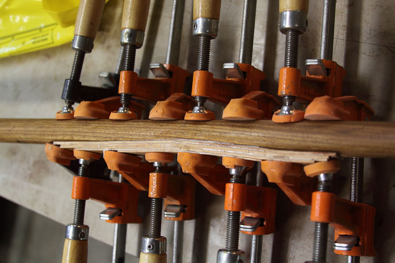

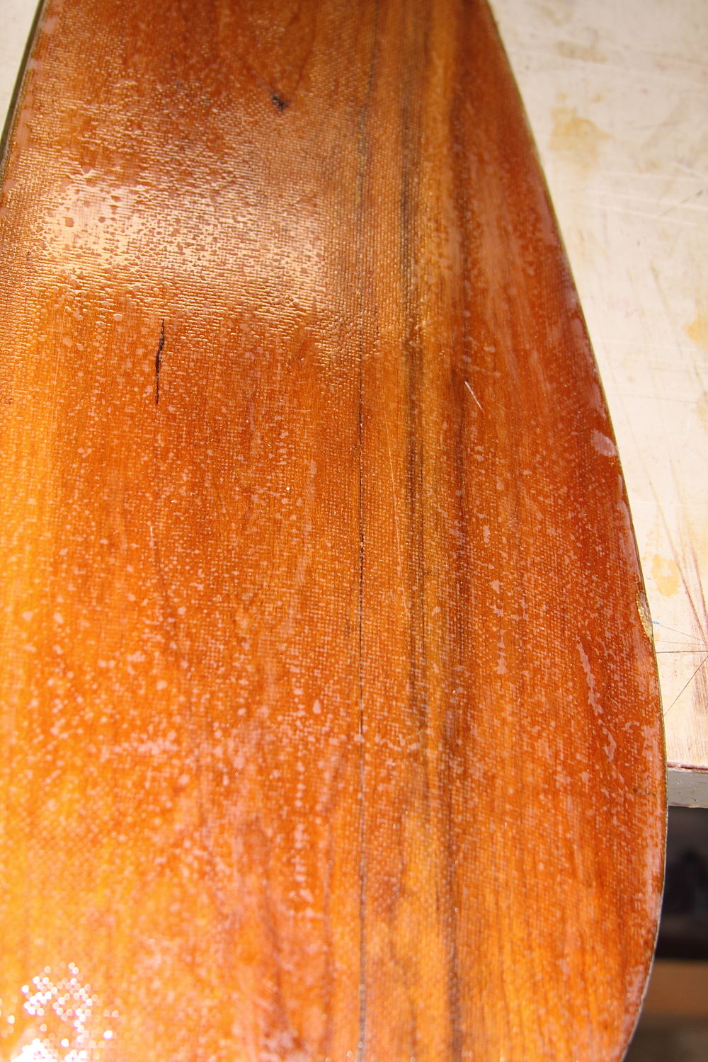

Attached are pics of the paddle with the broken blade. It also has a crack in the shaft, which is now well on its way to being repaired...

Thanks! RE: the blade: I had tried just gluing the broken piece back on, and then glassing just the tip of the paddle, and then just a strip of glass the length of the crack, but it didn't have the strength it needed to stay intact. Your mileage may vary; the blade on this paddle is very thin. If you need to 'glass the whole thing, use very lightweight 'glass cloth to unbalance it the least bit possible. I don't even fill the weave (2nd coat of epoxy) for that reason. It leaves the surface weave visible, but is noticeably lighter.
RE: the shaft: The grain of the original wood doesn't run out; what you're looking at is actually the curvature of the 1.5mm shims I glued into the shaft after shaving down past the crack. I'm hoping this holds well... otherwise this paddle will be relegated to ceremonial use. That would be a tragedy, indeed!
