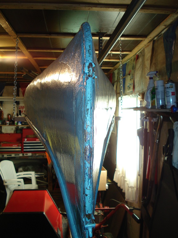

The hooks are for the rudder for the sail rigging

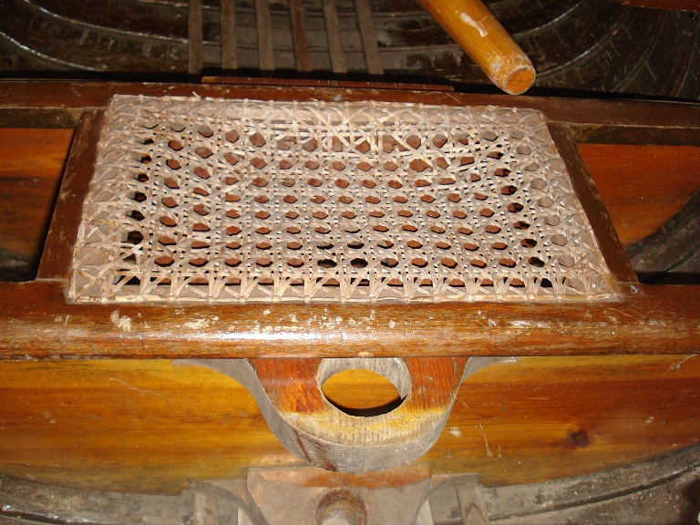

sail rig mast support added under bow seat

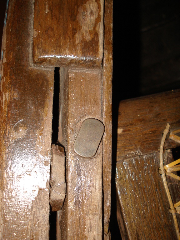

mounting hardware for stern seat anyone know where I can get this hardware to replace a missing bolt

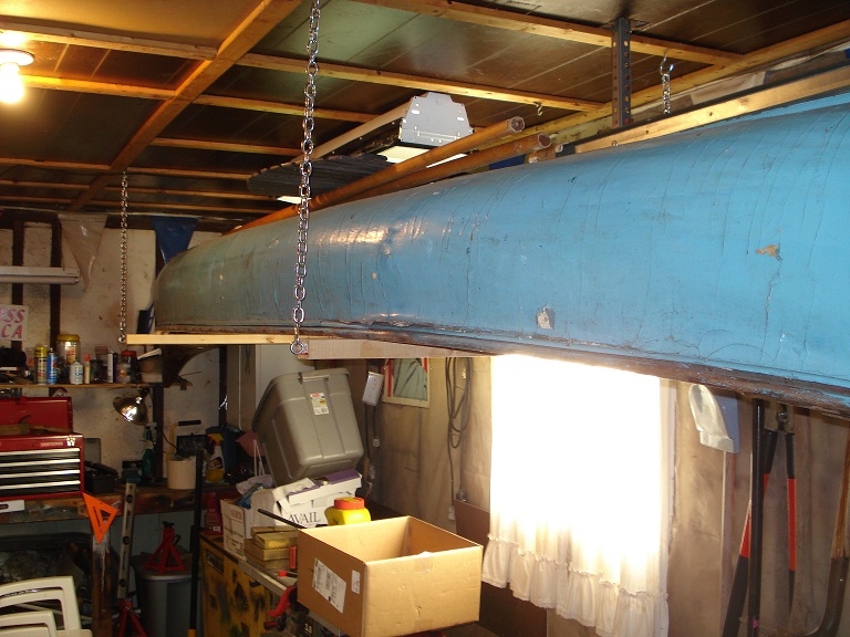

Edit these photos were taken with the canoe hanging upside down so photos were rotated to make for easier veiwing

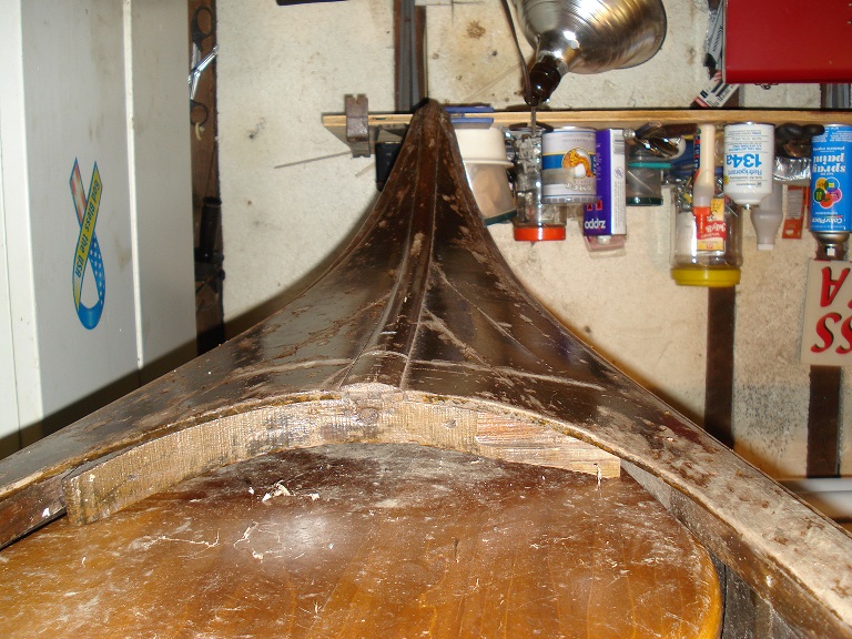

As far as I can tell this is the worst of the rot/damage on the canoe this is on the sternfall 036r.jpgfall 030r.jpgfall 027r.jpg
The bow is intact all be it a bit beat up fall 037r.jpg is this really how they attached the canvas to the canoe with what looks like 1/4 round nailed into the gunwalefall 044r.jpg

The mast partner is a later user addition. The rest of the rig may be homemade as well. Kennebec had a fairly distinctive leeboard thwart, and their leeboards were shaped the same as Morris. Post pictures of those and I can tell you more.
The seat hanger looks like a bolt from a T-slot jig, and is a replacement as well, IMO.
