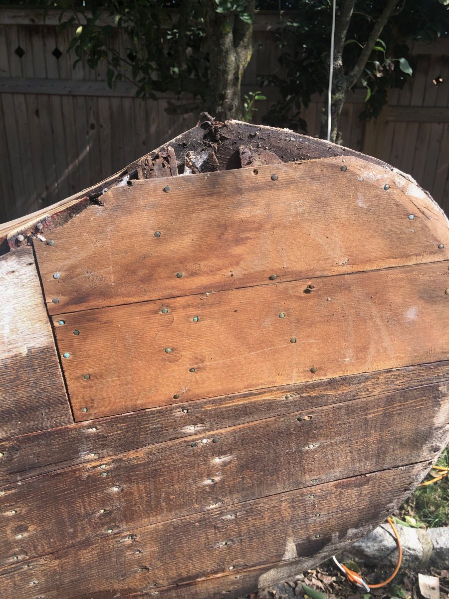

I am beginning a project that is over my head, but I'm excited to give it a shot. I have a 1923 Otca with many problems.
I will need to work on the inner rails among many other parts and I'm looking for the correct spruce to for this task.

Boy Brian, I still don't like the profile of those rails - I'm still wondering if the thwarts are the right length. Unless... are there 2 or 3 breaks in each rail? That would sure explain it. O - did the canoe come with seats? If so what happens to the rail profile when you slip them into place?
Hello Howie,
There were seats and three thwarts. I took the seats out and removed the center thwart just before I took the picture above. I don’t think the rails moved much after I removed the seats and that center thwart.
I’ll get the measurements of the thwarts and share them. Perhaps someone has the length of thwarts in a 17’ 1923 Otca. I do believe there are other breaks in the rails. For starters, each thwart has two screws in addition to the diamond head at both ends of the thwart.
Thank you,
Brian
Yeah, those screws through the rails and into the thwart did nothing to strengthen the rail. And that's right - I already checked your thwart sizes from what you told me earlier & they seemed ok. Maybe try that paint stick & c-clamp idea at every break in the rail & see what the profile looks like.
