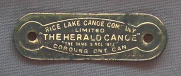

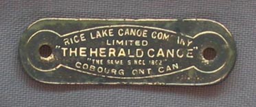

Hello H.E. Pennypacker,
Dan Herald started building canoes in 1862, after his death in 1890 his sons took over the company, operating under the name Herald Bros. In 1899 the Herald Bros. changed the company name to Rice Lake Canoe Co. to use the general brand the company had become known for. All three companies produced the same model lines of canoes, built on the same forms, by the same workers and at the same place, Gores Landing.
However, in 1919 the Herald brothers sold the company and the new owners moved the factory, its forms, equipment and some of the workers to Cobourg.
Thwart tags were used by Herald Bros., a very simple hand-stamped tag with rounded corners. With the change to the name Rice Lake Canoe Co a more elaborate tag was used (see picture below) this tag was also used by the Rice Lake Canoe Co in Cobourg.
Yes, all correct. Three different names for three different iterations of the company (only the last of which is named Rice Lake - the Rice Lake Canoe Co.), and uniform tags with profile like Aleck's were used only on Rice Lake. Your photo shows the tag that is on my two Rice Lake canoes, and its shape matches the ghost of the tag on Aleck's canoe. Thanks for posting the details, Mr. Persson. For comparison to the Rice Lake tag, attached here is photo of a Lakefield tag. The shape is a little different - it's convex on the top and bottom, while the Rice and Lake Pete tags are straight, and the ends of the Lakefield tags are a bit narrower, a bit "pointy" (it's subtle, but Aleck's ghost looks straight-sided and with circular profile at each ends). Some people may generically call all of these Rice Lake canoes, but Rice Lake is the trade name of only one, started in 1899. I've never seen a Rice Lake with one-piece decks, and if my impression is correct that the one-piece decks are significantly earlier than 1899, then that should rule out the Rice Lake Canoe Co. as the builder.
EDIT: Now I see the reason for your response, Mr. Persson! I just re-read my post above and see that I made a major typo, writing "Dan Herald and Herald Brothers are different companies - new iterations of an old company." Oops! I meant that Herald Bros and Rice lake were new iterations of an old company [Dan Herald / Herald & Hutchison]. I'm a big fan of the whole Herald/Rice Lake lineage, so I'd love to see a photo of a Herald Bros. thwart end tag.
I'll correct the earlier post above to avoid confusion.
