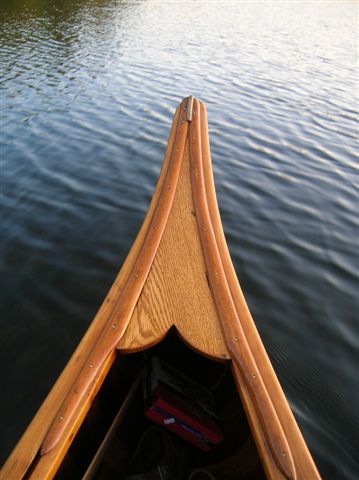

You can find most of that information by using the search utility here. The "type A" is plain and the "type B" is fancy as described at http://forums.wcha.org/attachment.php?attachmentid=3560&d=1193578175 from their 1929 catalog and the page at http://forums.wcha.org/attachment.php?attachmentid=20427&d=1319388096 describes the Kennebec model. The image at http://forums.wcha.org/attachment.php?attachmentid=6434&d=1226254804 shows a typical Kennebec deck pattern. Good luck,
