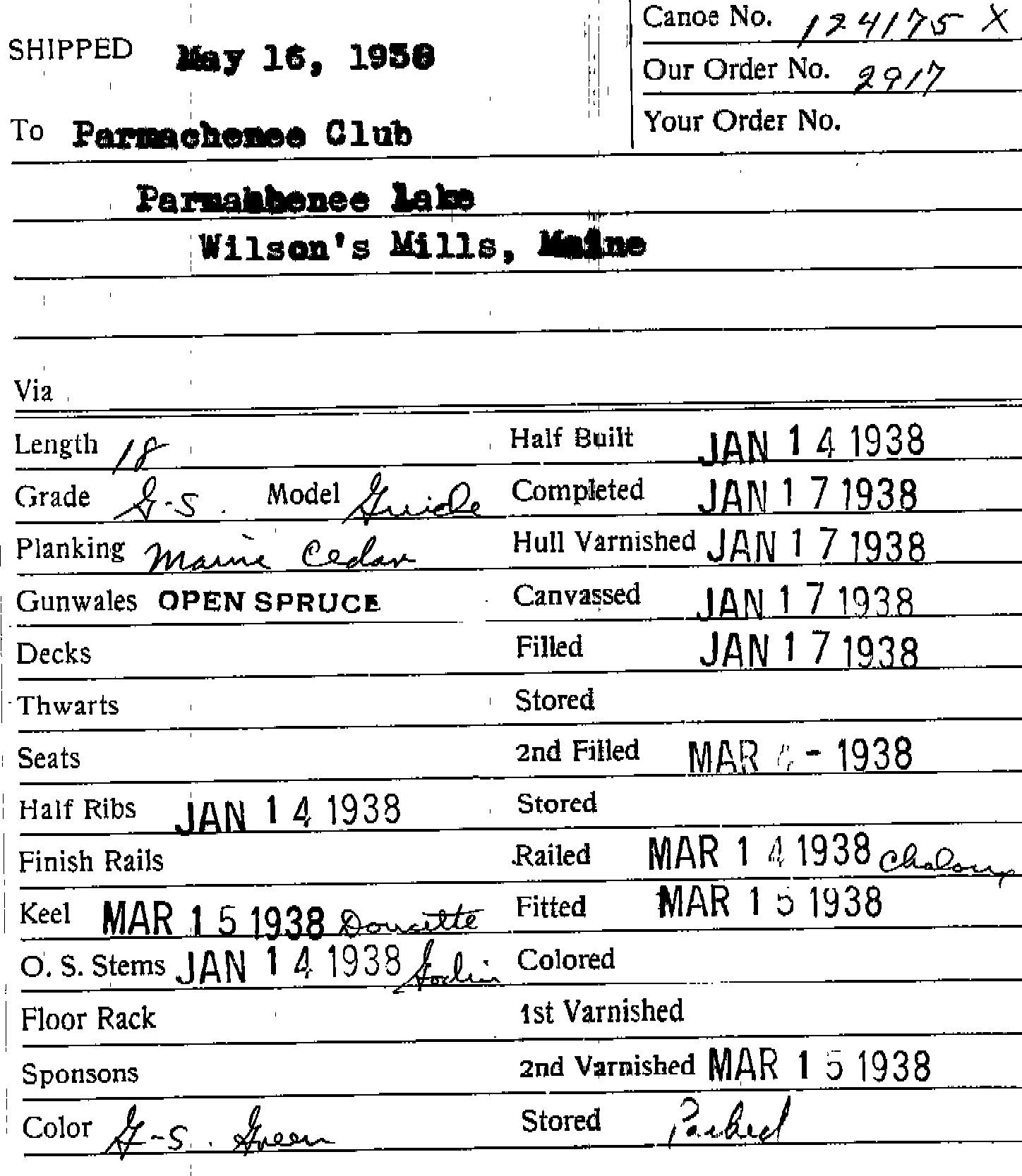

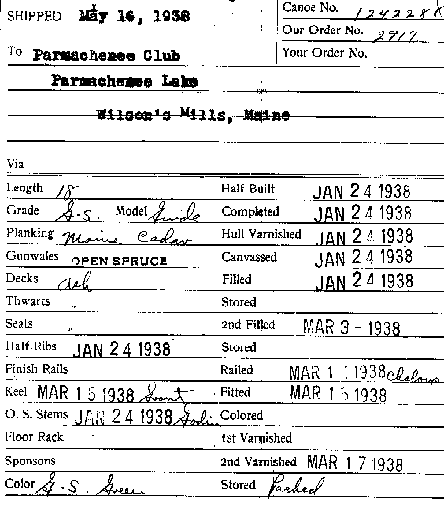

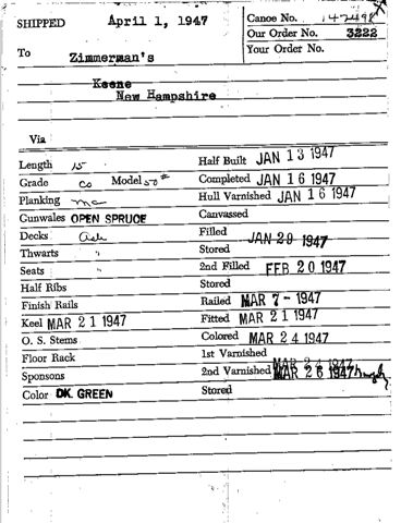

Sigh, I respectfully disagree with the "OT representative" who told you that Old Town changed the meaning of "WC" planking on their build records over time. My experience is that "WC" on the planking line of an Old Town build record always means red Western cedar. The records at http://forums.wcha.org/attachment.php?attachmentid=5015&d=1212510186 and http://forums.wcha.org/attachment.php?attachmentid=5016&d=1212510186 show Maine Cedar spelled out on the planking line. The records at http://forums.wcha.org/newreply.php?do=newreply&noquote=1&p=23387 and http://forums.wcha.org/attachment.php?attachmentid=5614&d=1217818815 show an abbreviated form. All of these are after 1920. I have Old Town canoes from 1907, 1914, and 1936 with the "WC" designation as shown in the build records attached below and they all have red Western cedar planking.
The 1917 Old Town catalog lists the width of the 16 foot Otca at 34.5 inches as shown below. The current Old Town catalog at http://www.oldtowncanoe.com/canoes/classic_wood/otca_16.html lists the same model's width at 36 inches. Many of the models have not changed but the 16 foot long Otca model did. This has been a problem for some people in the past. Your mileage may vary...

Mr. Gray, Thank you for the interesting history lesson regarding the variations in building records of the OT canoes and the differences in the Otca model form widths (old and present). The building records you sent show that OT used western red cedar throughout its history along with the Maine white cedar. Did OT tend to use more Maine white cedar than western red cedar during its early existence? According to Stelmok and Thurlow in their publication "The Wood & Canvas Canoe" page 178 that OT had lumber crews harvesting local lumber and didn't begin to import western red cedar till the 1920s. This is the base to my confusion regarding the use of white cedar for planking. Again thank you for straightening out the matter.
Rollin Thurlow occasionally responds in this forum so I will let him provide an explanation or reference for the comments on pages 178 and 179 of his book. It was published in 1987 and a fair amount of new information has been uncovered since then. A portion of the Old Town Canoe Company inventory from September 30th, 1908 is attached below. It shows 42469 board feet of "Western Cedar on hand" at the bottom of the image with various amounts of local white cedar ribs, planks, and logs above it. This came from a company ledger that has entries for Western or red cedar from 1905 to 1932.
Old Town always tried to use white native cedar for their ribs and red Western cedar for the planking when available. Supplies would occasionally run short requiring them to use other woods. Old Town employed their own lumber crews so the supply of imported red Western cedar was usually exhausted before the locally available woods.
