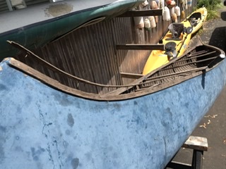

Hey everyone, I'm ready to canvas and put replacement gunwales on my boat. It's an 18' CS model with 'closed spruce rails'. I'm completely unsure what the pieces and profiles are to cover the edge of the canvas. Attached is a closeup of the inwale and cedar siding, and a diagram of the 2 ways I think it *may* have originally been done??

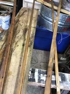

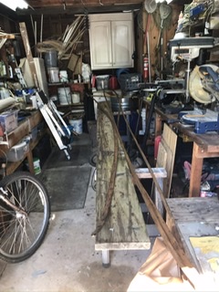

I’m working on a 17’ Carleton built in the Old Town factory in 1916. It had the original closed gunnels when I got it. It had been fiberglassed but the gunnels had not been removed. The first photo shows the gunnel configuration as I started to removed them prior to stripping the fiberglass. At this point, I’ve canvassed and coated the hull ready to begin priming and painting.
I’ve tried to save as much of the original as possible, so I’ve decided to keep the original gunnel caps, splicing a spruce section onto one that was in really bad shape. The outwhales were rough, so I cut replacements from spruce firing strips my lumber yard let me pick through. I steambent these on the canoe, clamping from the middle until the bends became too complex; then encasing the remaining two to three feet in plastic tubing, running in steam, and carefully bending against the hull and holding in place with strap clamps for several days.

This looks *exactly* like my boat. Thanks for the sketch too. It looks like on the pics named gunwale that the rails are higher than the deck? This was confusing to me too, and made me seriously second guess the need for top rails. I ASSumed the decks and rails were flush, but the deck was definitely reinstalled at the same height it was originally at.
RHP - The photos of your canoe (inthe attachment in your original post) definitely show a closed gunwale canoe. Your gunwales (rails) are in place as they should be, and so are the decks. All you're missing are the gunwale caps - one on top and one outside. I call them caps as opposed to gunwales because they are much less substantial than the actual gunwale or the outwales on most open gunwale canoes. They serve to cap the rail and canvas, providing a neat, robust edge that cover and protect the rails, planking and canvas.
Jim Clearwater's diagram is excellent, and his photos should be helpful. The only thing I would add is that not all makers, at least not in all years, cnamfered the edges quite so much or so crisply. Some did, others had chamfers that left a bit of a flat on each edge, and others appeared to have little or no chamfer and maybe just a little roundover. But those are fine details that you may or may not be concerned with depending on just how historically accurate you want to be, vs. simply having a nice, functional canoe.
