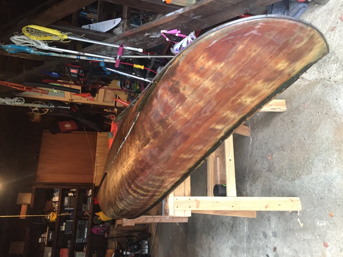

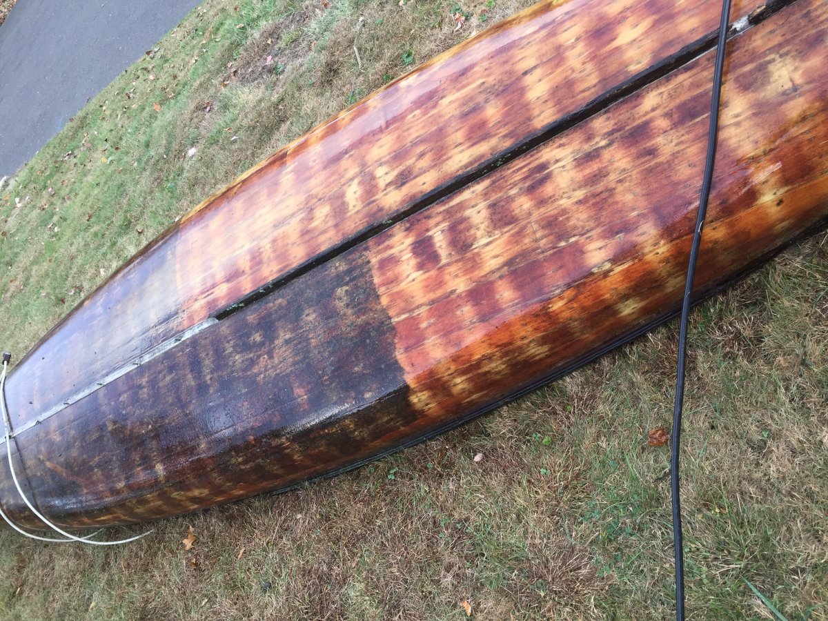

I've added a couple of pix to show you what I've got. The first is as the canoe is being cleaned. It's got a nice pattern; the next is of the boat after drying. Not sure how to rotate the thing, and I don't have any pix of the inside, which is nice, except for the gunnels, stems, and deck. Sorry about the format; not sure what's happening! IMG_6989.JPG IMG_6990.JPG
I am suspicious that the canoe left the factory with canvas, and was glassed by somebody later on. Never seen that zebra pattern before. If she is watertight, or close to it, do a minimal restoration, then use and enjoy the canoe. Save the hard work for later when it really needs it.
The "Natural" on the build record indicates that it was fiberglassed at the factory and left clear to show the wood. I can't explain the zebra stripes either but agree with Tom's suggestion to "do a minimal restoration." Factory fiberglass is often much very difficult to remove since they typically used styrene to thin the first coat of resin and improve the adhesion to the wood. Good luck with the restoration,
The zebra striping on the hull is not unusual in terms of wood and furniture. The boat has seen a lot of changes of humidity and temperature. The space where it is just cedar planking will freeze, thaw and soak more quickly. The place where it has ribs will be slower. Given the right (really "wrong") storage condition the wood undergoes totally different aging.
