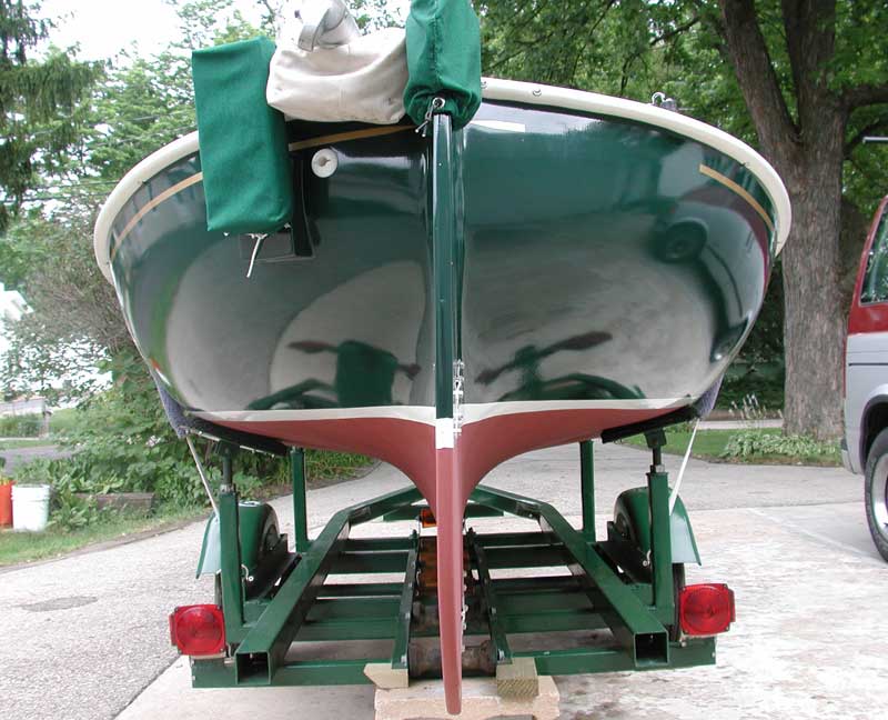

Two coats of Brightside, painted out in my driveway. It had sat outside for three years after being painted and had spent the previous summer out on a mooring buoy when this photo was taken. It was in for spring cleaning.
