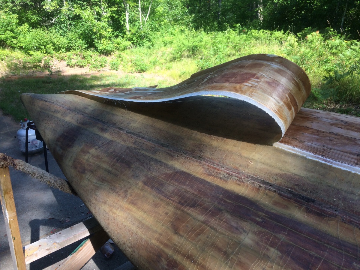

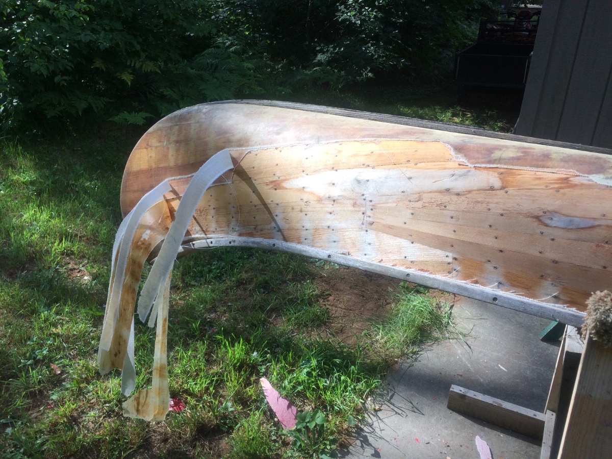

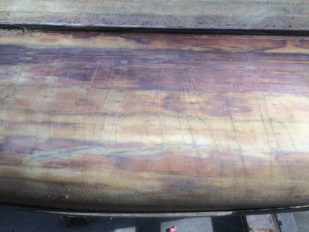

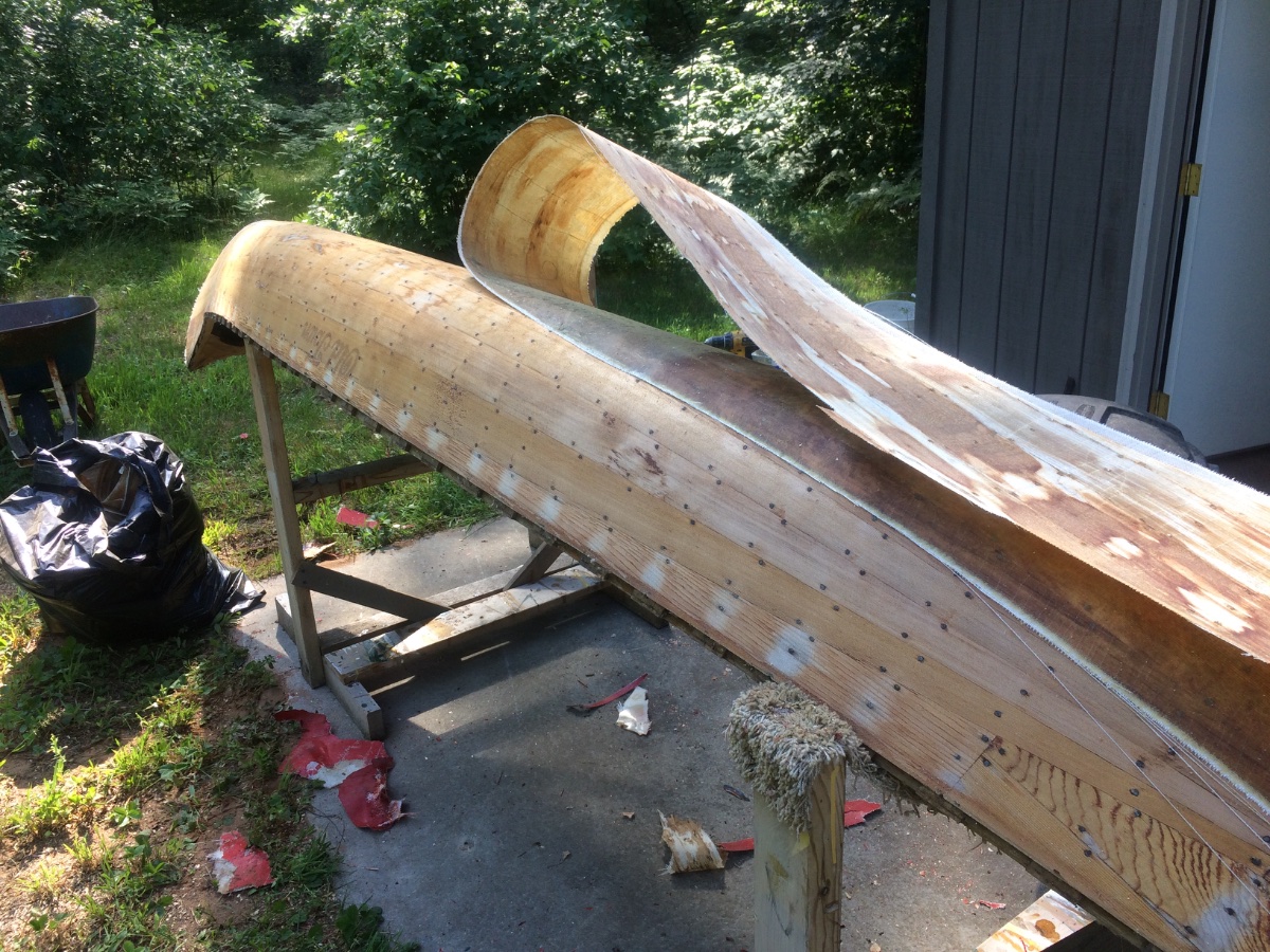

BTW. The inside was pristine. I re-glassed it at the customers request.

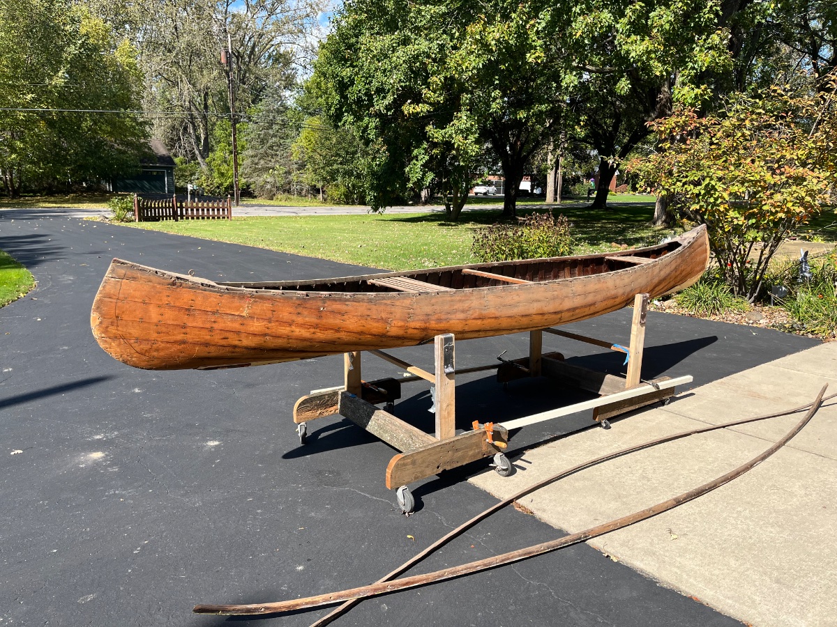

Removing the polyester fiberglass from this hull took about an hour. I’ll be researching “best methods before proceeding.
