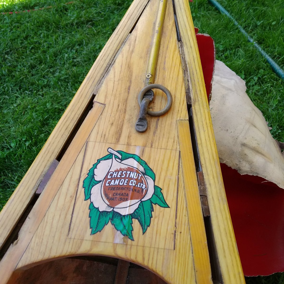

Hi, this is my first post. I found this chestnut on garbage day. I took it home for the thrill of portaging in the city. Now I'm restoring it to paddle around the mouth of 16 Mile Creek in Oakville, Ontario, with my daughter....and possible for solo trips or as a second canoe on a trip. There is a canoe club there that is really good with kids.
Anyway: is this deck the result of a previous repair? The inwales don't reach the end?
The stems are white oak, front one might need rebuilding. About half the fasteners at the stems are steel....all but one fastener for the ribs were steel. All tacks are brass. Gunwales screws are bronze. Keel is while oak. Undersides of thwart and seats were left unfinished.

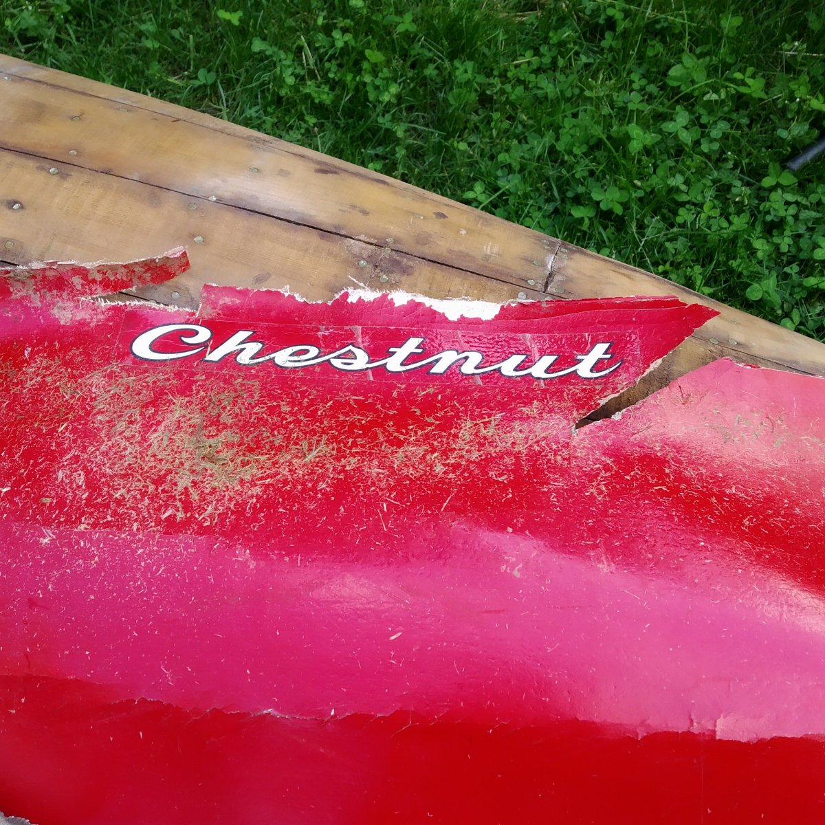

Also: any hints on how to get planks off without splitting them? The iron nails are hard to get to...but I guess I'd better get them all.
Your canoe appears to be in good shape, and certainly restoreable and usable. That style of deck joinery is more typical of Huron canoes I have seen, and there is nothing wrong with it when properly done, but I suspect it was done during an earlier restoration by cutting off rotten inwale tips, then filling that space with a new oak deck ( and a reproduction Chestnut decal). If the canoe is as old as WW2, a lot of steel nails were used, and if rusted into place, difficult to remove. Don't remove any more than necessary, as a lot of collateral damage to wood will occur. I worked on one where I touched a soldering iron to the steel nail head to create a small burn around the nail, which allowed it to come out, but I'm not saying this is a great idea. Keep us informed about your progress, and we like photos. TM..
I have a Peterborough River Model (Prospector) with a deck like that. It was a previous repair.
Not sure what to say about steel fasteners in a Chestnut. Word on the street says that steel was used during WW2 because brass was going to the war effort. Old Town used steel, albeit galvanized, to fasten the ribs to the inwales, until they went to the long @#$&## staples. They are generally no problem. Unplated steel screws are a problem normally. Hard to remove, but should be replaced with brass or bronze IMHO.
I’m working on a 1945 Old Town with steel clinch tacks. They are hard to remove as well. They don’t “unclinch” when you pull them out, so they normally pull a good size chunk of plank and rib with them. For the most part, I leave them if possible. if there are steel tacks and planking is to be replaced, I will break up the planking, leaving the tack stand proud.
Then use an angle grinder with a 36 grit wheel to grind the tack flush with the rib, leaving the clinched portion buried in the rib.
I might leave the steel in the stem, but replace all the rib fasteners. I was going to steam bend a front stem, but could only find kiln dried white oak. Air dried ash was only available as 22 foot boards....yikes. I will replace white cedar planks with red cedar....just because I have some clear grained cedar rescued from thrown out fence posts which are 2.5" x 5.5 "....and I can't find white cedar that easily. A lot of the planks have knots....some planks have really nice grain. I might have to rebuild the decks as is....tips are a bit black. Stem to deck joinery is hard to make out.

scrape off the crud, paint remover if necessary, and then autosol and fine steel wool will shine them right up. Then you will get a nice overall patina from there on. Enjoy the steel, its a chestnut hallmark. Looks like a bobs or a later, widened chum. try to get some white cedar, its easier to work and the red will stand out considerably. looks like someone previously did the arrowhead decks instead of a gunwale splice, but if they are solid just leave them.
The ends of the decks are crumbling (well the front is)....I had some butternut from a table I bought at a garage sale that I used to make new decks....not original species but it is light and the colour is great. If I fail at bending red cedar ribs I will look for white cedar...I'm trying to not kill any more tress than I have to. I tend to collect too much wood as it is, and the wife is happier when I use it up.
The iron nails are only in the stem and the ribs.
I'm in Oakville....Ontario. I might be able to get air dried 8x8 but with knots. Exotic woods is close....5$ bdf....Noah's marine is 8$ bdf and likely have more clear grain.
