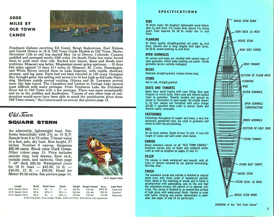

Just curious, big square stern canoes. I usually use #8. I'm thinking about using #6 on the next one. It just seems so darn heavy. I'm sure I've used it in the past. What do most of you use ? and what weight did they use 60 70 years ago?
The Old Town square stern model was introduced in the 1917 catalog and number six canvas was included in the description as shown below. This was also listed in the 1964 catalog which was the last year that boat was included in the catalog.
