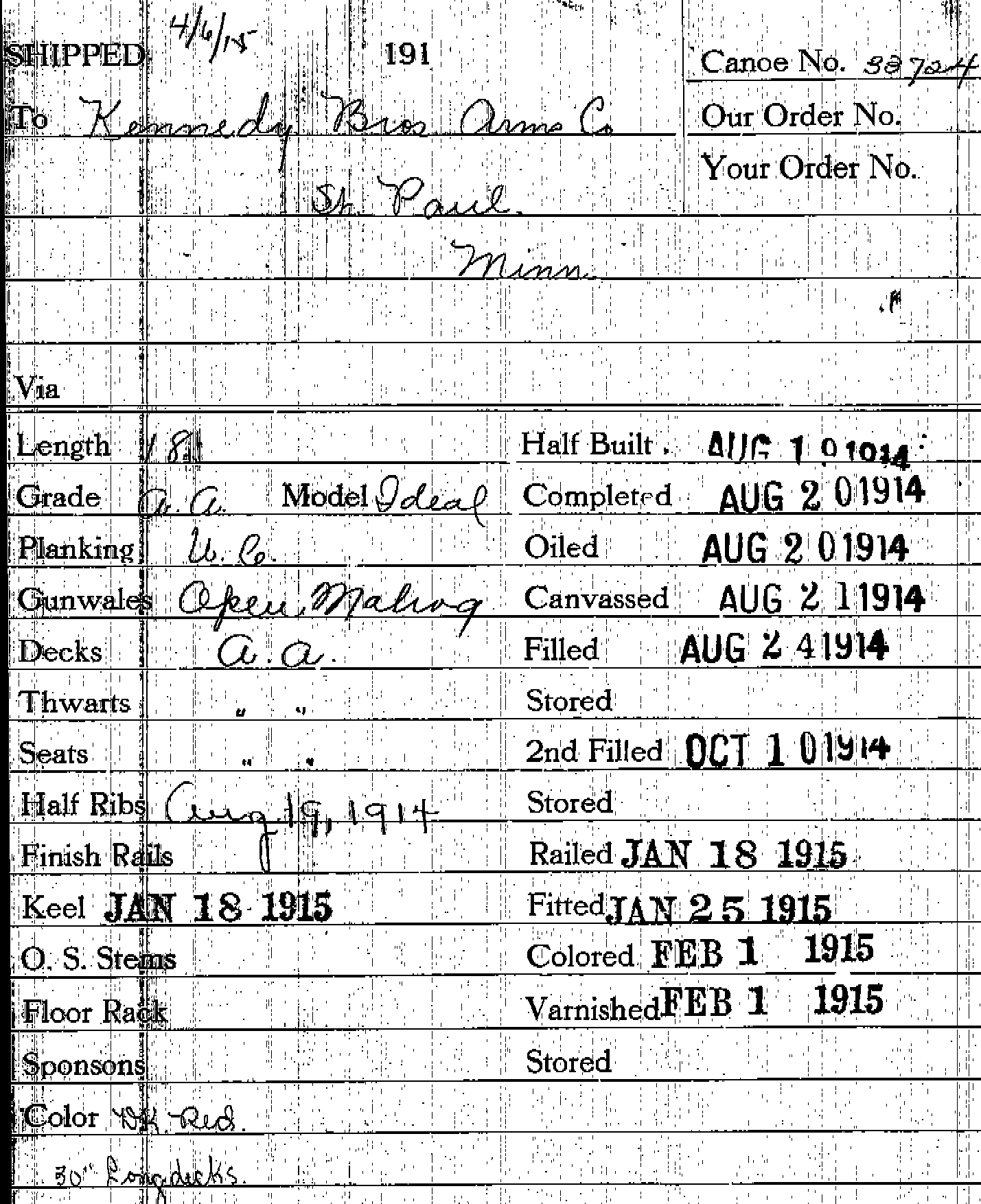

1916 old towne ideal canoe
hi, i'm new here but wanted some info on my antique canoe, i've had it since the early 60's and do have a number i found on the inside # 42997 it's a 17' with all mahogney wood inside the canoe and on the gunwhales and decks, i did get the history from old town but wanted more can you help?
