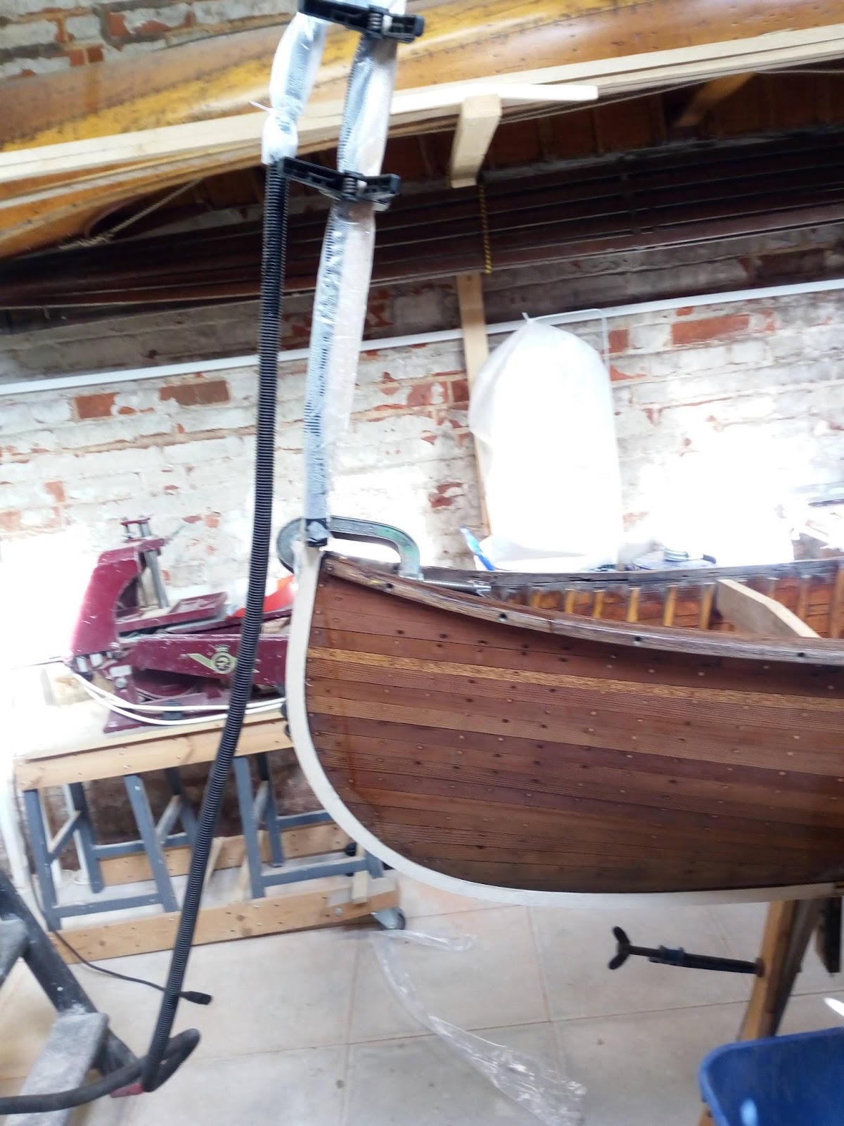

A technique that I use to make outer stems on an all wood boat could probably be adapted. It means there is no cooling between heating and bending.
-udx-P7SgSK65kFMWUvz_xg8VOdMro7IJPLXJAjsi9zFPwORMkGSTvw1pxo2YLGdqRJO1GurYLtarrn8h88qv8zH6O2Gcqcp0g7u0187hIiK6ti7FsS7o7hNej9u0YDWmusGrpdwxKbcBtKwxq6xgUY
In the photo, you can see the over length and still straight stem is inside the plastic sleeve and under the towel for a bit of heat retention) already screwed to the keel. The screws also hold the compression strap in place. The compression strap has a handle at the end measured to act as a stop. The steam is applied by the wallpaper stripper on the left.
-j4LihAxyFTDhwMQrBIrO3nrLhhHi9EukzdftXaUuct7_OTs4AWMr7sxv1v4MXYE8GLWrv_SAp9Y7g2Uu9Mu8aZTieGIGMNle0MUPqtRmgOJ9eY2Q7fJHwzqHlE82Ecidqb5jycQh1cIaIPFeJp8wKQ

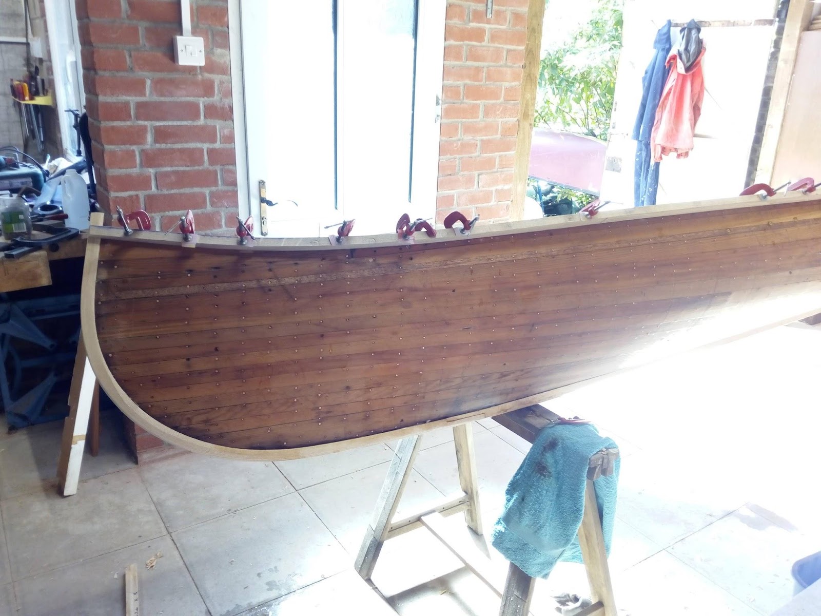

After the right time, the strap is hooked round the end of the stem (the steam tube has to run on top of the stem to allow this). While the steam is still on, the stem is bent slowly round and just needs the one handed application of a previously prepared G clamp to keep things in place. At that time, switch the steam off and split the tube away to allow things to start drying. Don’t forget the thick gloves! The boat needs some weight in it otherwise you end up lifting it up. If you lift the boat after the right amount of time, you can let it steam longer and lift more slowly
DPg2PJwHlEapyCM6kLuGkKUj9v9lY5NqSJ542NPutf5Wo2sFs2q3uSRi_pNbL0zX0FgserAAJpbxoFAPLxTVk8hyeDiam2IB1b2uy7Xm88XGL5lwC1GMyiPOPuH7VMqz39JbO1NXHeHdedHdj-Pygok
All finished and fastened, waiting to be trimmed flush with the hull.
Sam
