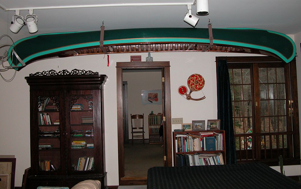

I usually store my canoes on straps and snap hooks hanging from the ceiling as shown at http://forums.wcha.org/attachment.php?attachmentid=29351&d=1209335424 although I will occasionally use a trailer as shown at http://forums.wcha.org/attachment.php?attachmentid=5305&d=1215358989 if I need to move more than one around at once. An upright display rack from Old Town like the one shown in the attachment below is currently disassembled in my garage due to a lack of floor space. My model canoes rest on a scaled down version of this rack. The thread at http://forums.wcha.org/showthread.php?4548 has some other options and a few pictures at the end.
