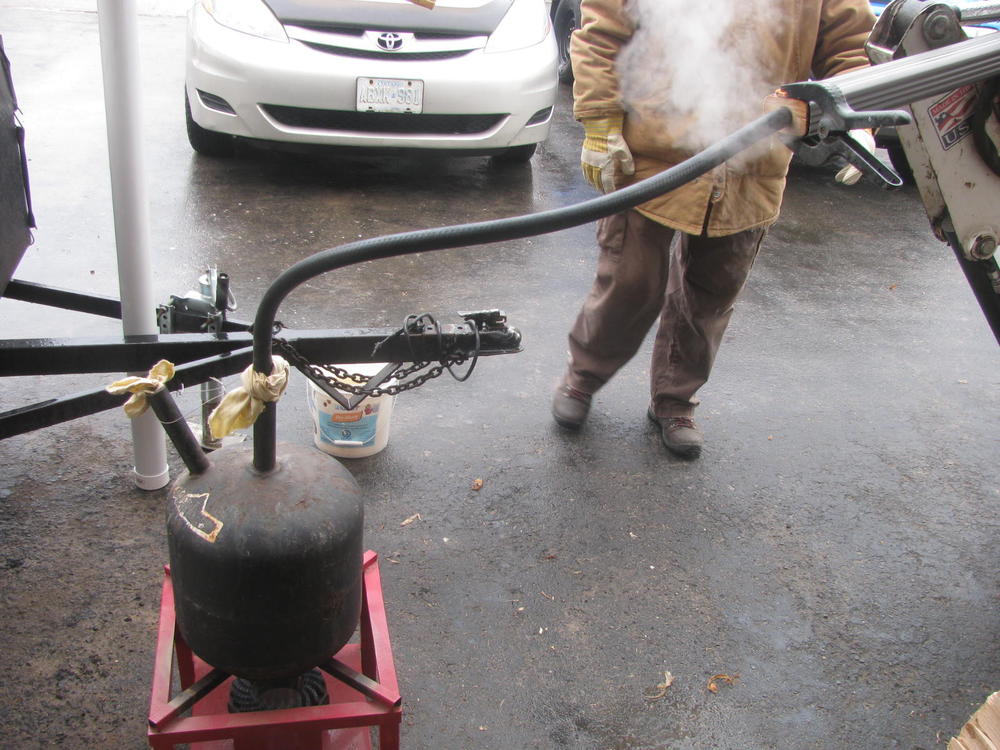

I started with a Coleman camp stove for heat and kept running out of gas, so my current rig is:
LP "turkey" burner, (fed by 20lb tank), 5 gal recycled metal gas can on burner, 3" fitting attached to top of gas can, 3" plastic pipe straight up about 18" to a 12"x12" x 5" cedar box. The box can hold up to 8 -10 ribs at a time. The box is on legs so it's easy to set on or off the steam pipe. Works great.

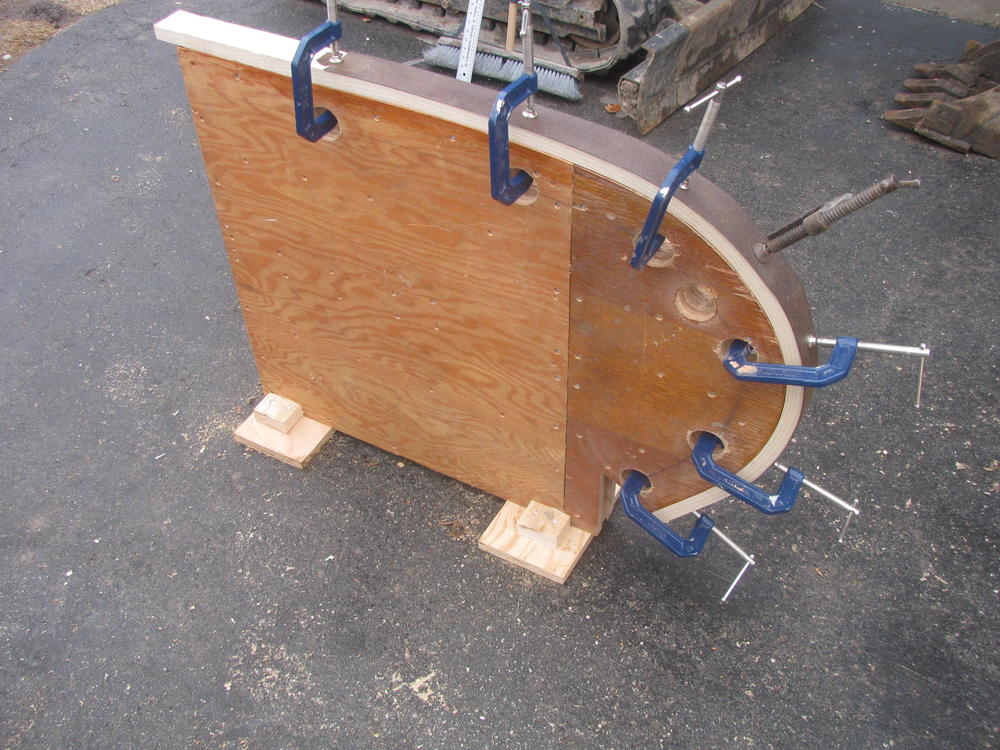

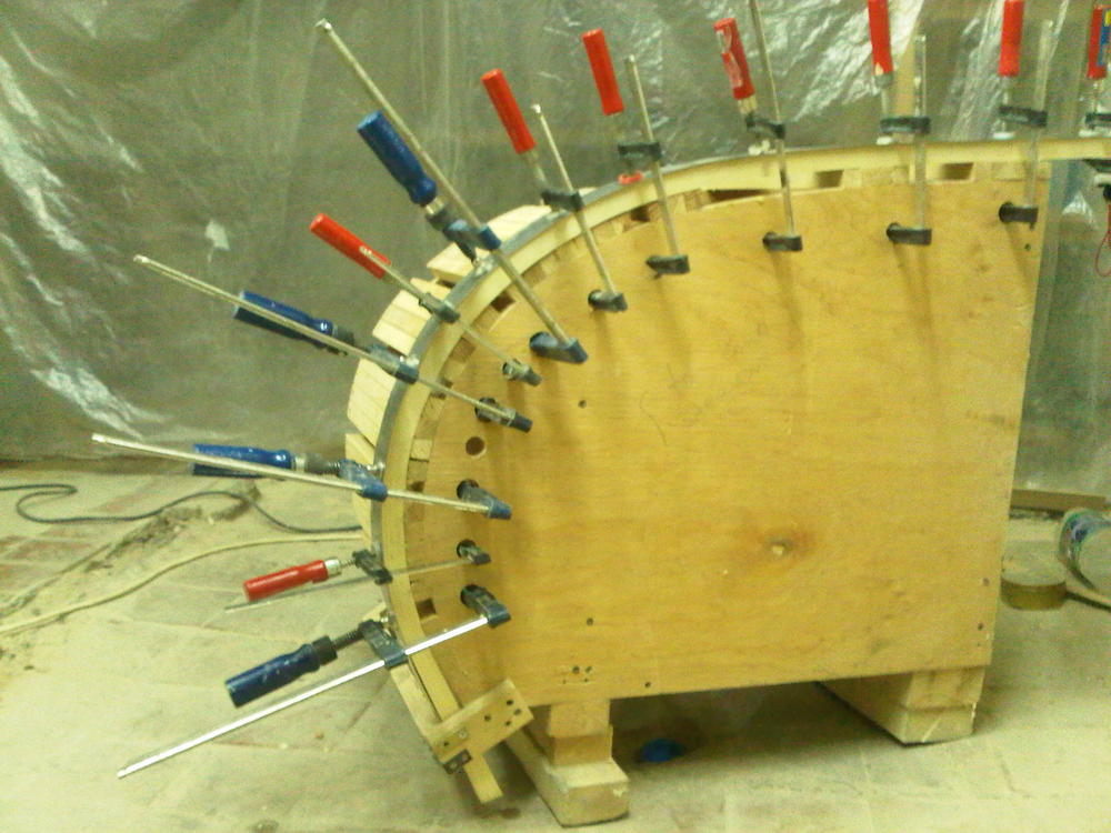

propane cylinder and propane fryer, on its way to 200deg. Air dried wood, soaked for 3 days in a tube beforehand, and a steel backing strap for no failures. ;)
and apparently whatever shoes Rob wears, they bring luck....

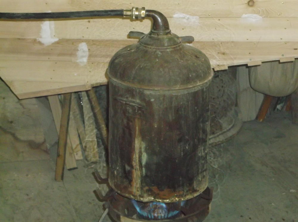

I just unhook my worm and thump tank from the still and pipe it into a box. Make sure you clean out the mash from the last batch. :)
