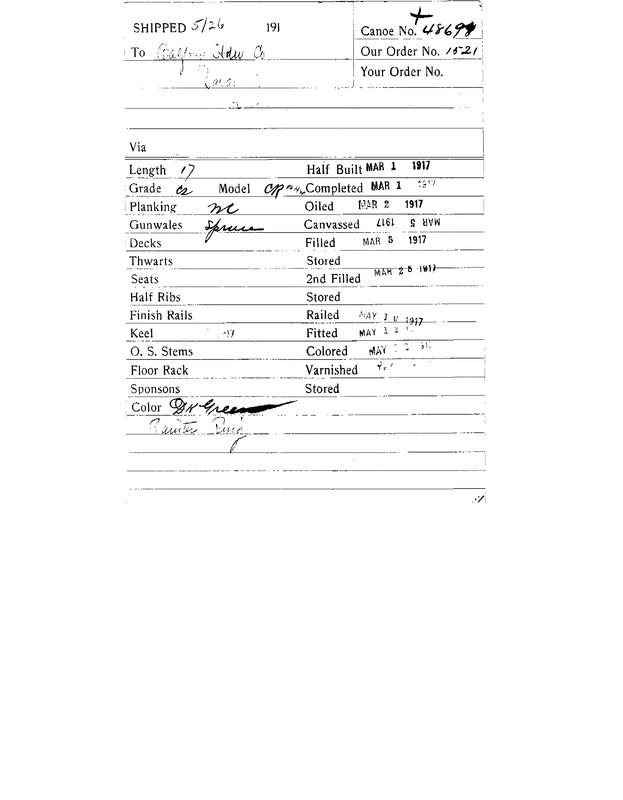

You need to take another look at the serial number. The Old Town canoe with serial Number 48698 is a 17' Charles River canoe.
Sometimes using a raking light makes the stamped number clearer; sometimes posting a photo of the number here can help us figure out the number.

Greg, Thanks for helping. The stem piece with the numbers was quite rotten and the numbers are barely legible. The first number, "4" is the one that is questionable....it may be a "1" or it may be just a crack in the rotten wood. Is it possible there are only four numbers.......8698?
Were all Old Town boats sequentially numbered, whether they were canoes or not?

I checked all the numbers x8698, as well as 8698 -- none are 14' and none are boats with a transom. If you have a photo of the number and can post it, different eyes sometimes see something differently. OT boats were all numbered sequentially, as far as I know. Are you sure it is an Old Town? Some builders other than Old Town built similar boats.
