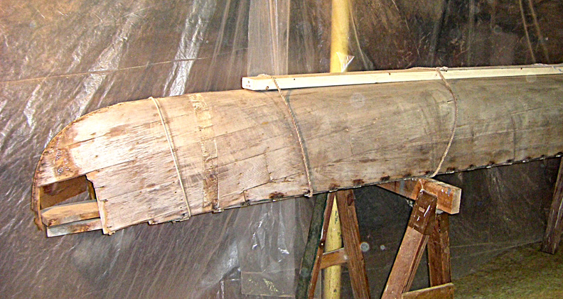

Benson, No doubt you will get better images than this, but for what it is worth, here is a 1948 White.STH70961crop_resize.jpg
This is excellent. It confirms my assumption that the White style shares many similarities with the Old Town style. A. E. Wickett worked at White in 1895 before he started at Old Town as described in the newspaper article below. Can you also share the full serial number? Thanks,

My best guess is that it is 16-48-920, but the 920 is faint. You will see this now-rebuilt canoe at Assembly. Tom McCloud

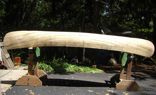

Benson, Here' another for your collection. Attached is a shot of a 12 foot probably Huron. The individual planks are 3" wide except for the second one down, the banana shaped plank, which is 4" in the center. Those are NOT multiple small pieces of planking - rather, those are gores cut down 80% thru the plank. Planking this way leaves several small triangular gaps at the gunwale, which then have to be filled. Tom McCloud

Hi Tom,
This is interesting. Do you have a higher resolution version so we can see this all in more detail? Thanks,
I can take a shot with higher resolution. Because it is difficult to tell the difference between the gaps between the ends of planks, and those gores, I have thought of shading some places with a pencil. Any thoughts, or a better idea? Tom McCloud

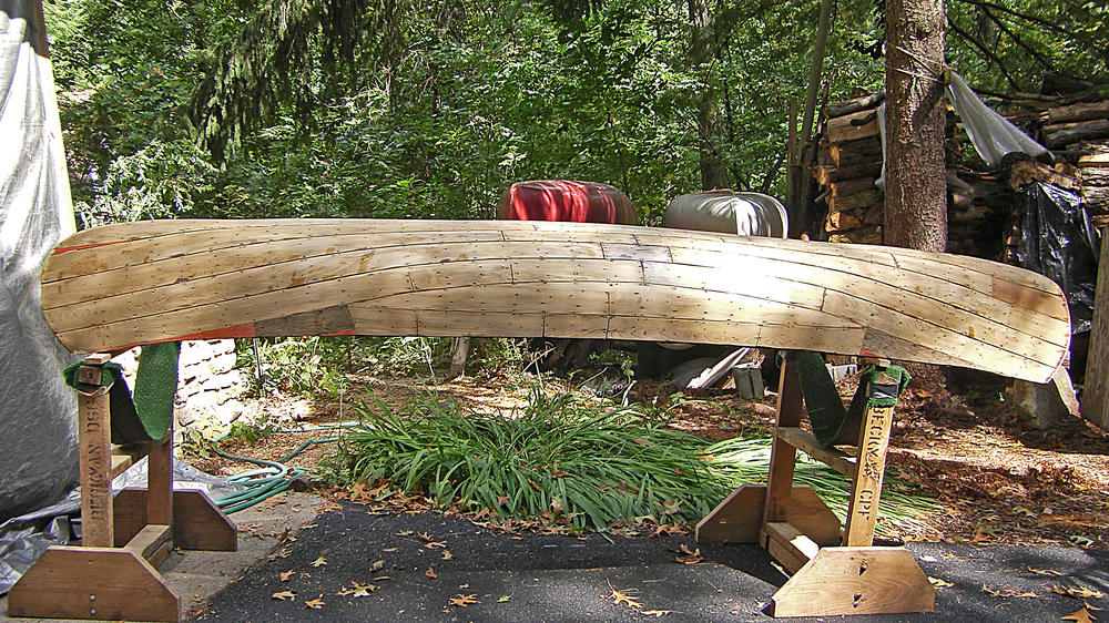

12' Huron? planking pattern
Second try, at higher resolution and contrast enhanced. Notice the 4 small red planks where small triangles of planking have been added as space fillers. Some planks have been darkened with pencil. The long planks begin at both stems, and if not long enough, a filler board is added near the center. All those vertical dark lines are gores cut into a long plank so it will bend around the curvature. All the planking is 3" except for the 'banana shaped plank' which is 4" in the center. There are 7 planks on each side of the keel line. Another build feature I found interesting in this canoe is that a piece of 4" wide red cedar planking was used as the first 'cant rib' on both ends. When you think about it, this makes a lot of sense, as it provides a wider area of support, and as you are trying to taper down to the stem. Do any of these construction features point more specifically to one of the Huron builders?
OK, so I uploaded the photo, and am told it is 248kb, and adobe elements says it is 1.4 meg. Some knowledgeable person has to explain to me how to upload a bigger file. Tom McCloud

This is much better. The difference between 248kb and 1.4 meg is usually the compressed size on disk versus the uncompressed size in memory. Thanks,
