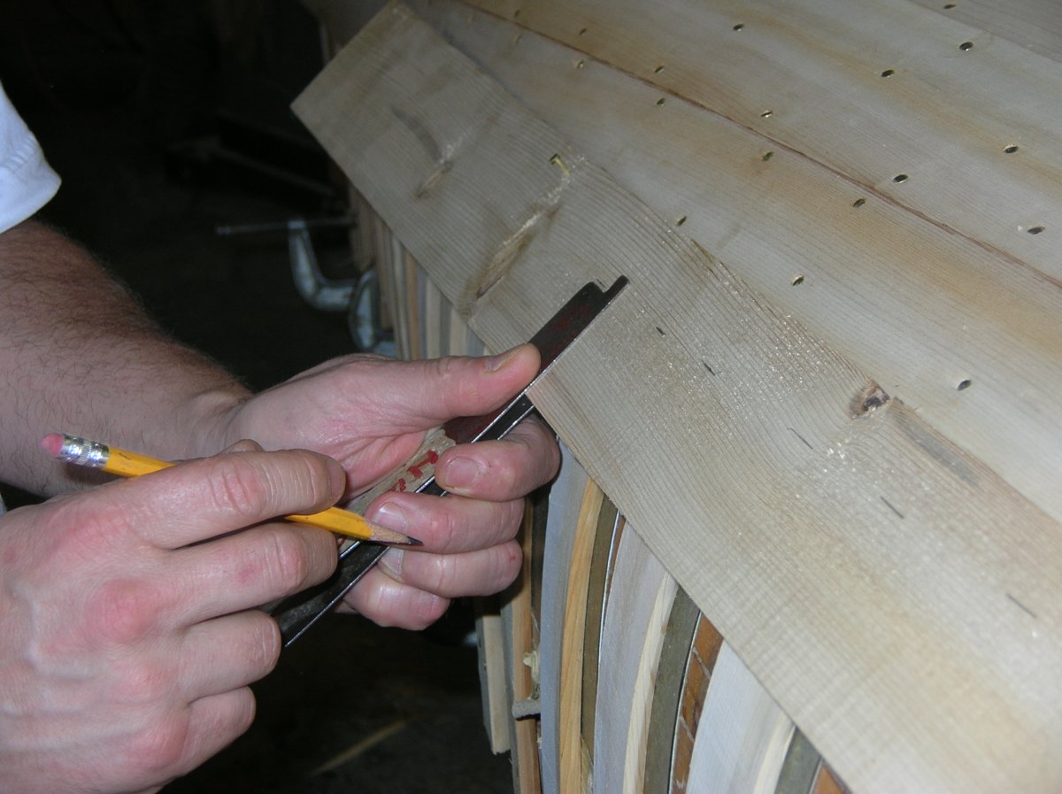

For marking the gore? As has been suggested, make one.

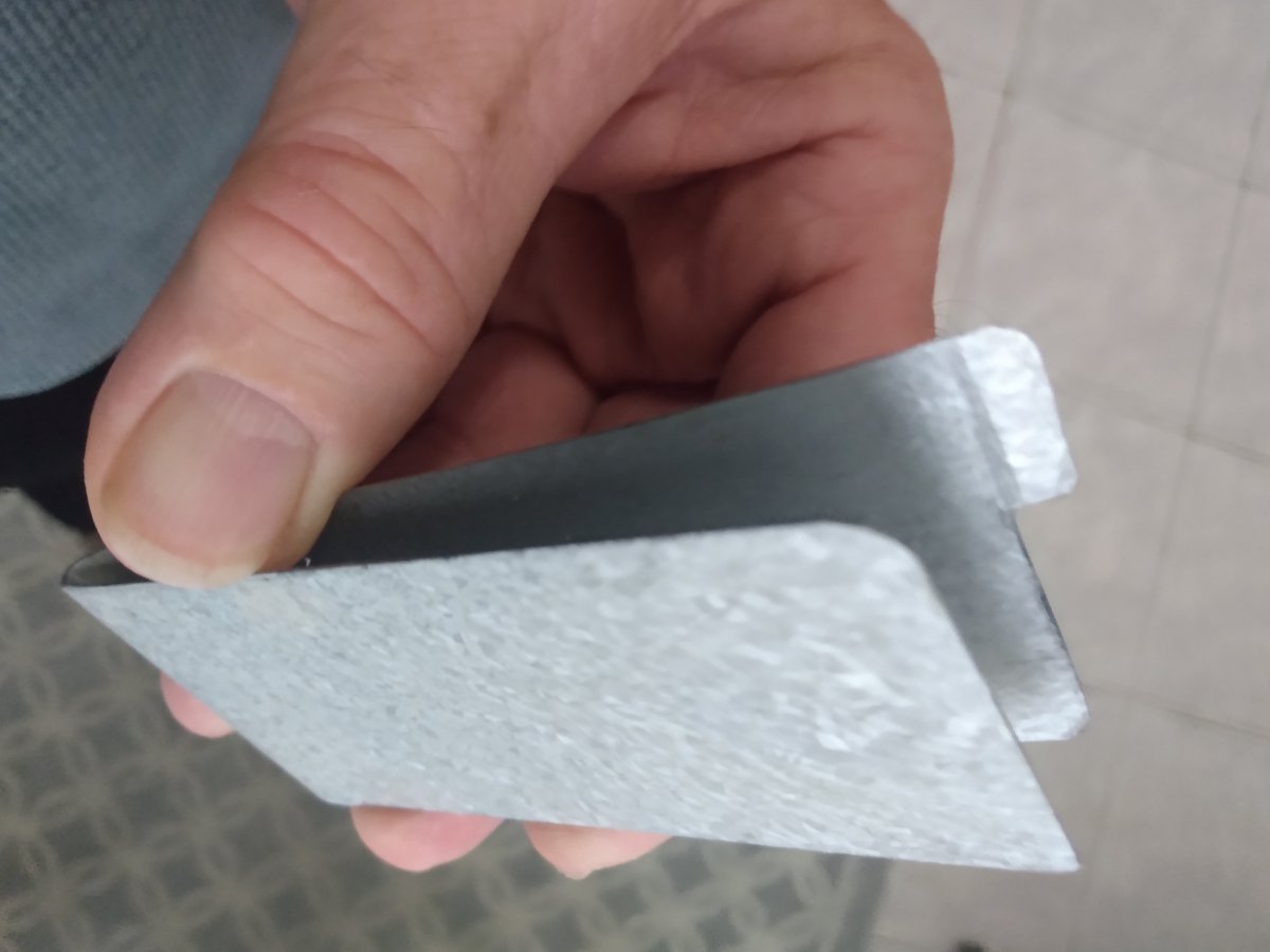

Here are some of mine. The gore scribing gauge is just a piece of folded over galvanized steel (leftover banding from a mold construction). One side has a lip folded over to ride on the plank, the other a notch for the pencil. The chunk of broomstick acts as a handle (it's optional).
The other wooden gauges are for scribing the sheer plank. The one that is sort of U-shaped is to ride over ribs that are proud of the gunwale (I don't flush cut until the outwales are installed.
