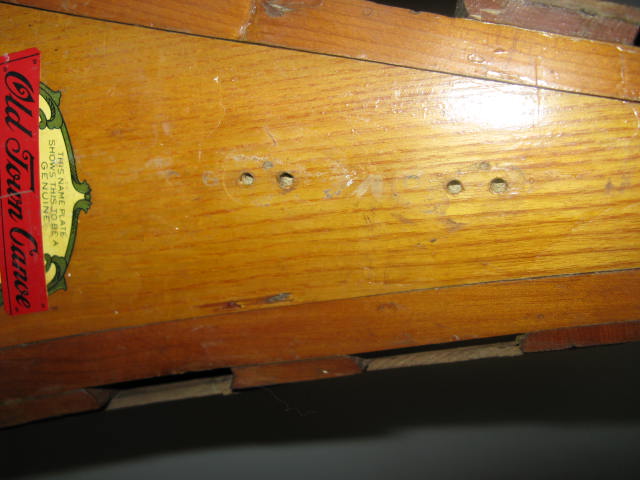

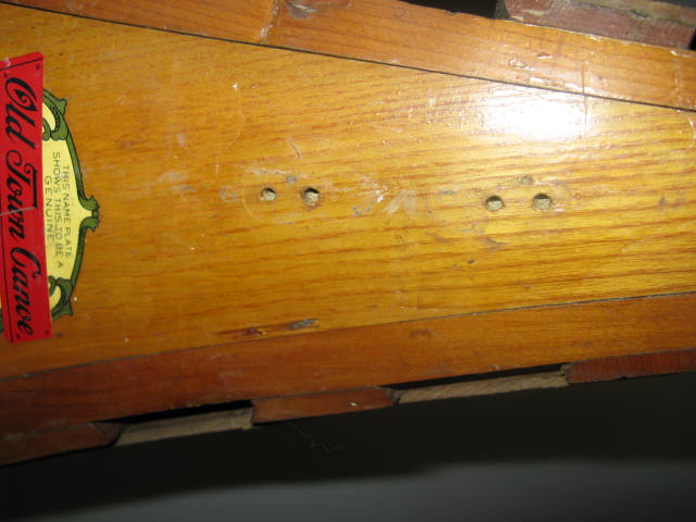

The holes in the deck have already been bored. I contacted Old Town and they replied that they would not have installed anything on the decks. What I have is two sets of holes 1/2" apart which are spaced about 3" from each other centered vertically on each deck. I may be looking for a needle in a haystack, but I sure would like to match them up.
Michael
Also, I am not absolutely sure that the holes are for painter straps. They may have also held the mounts for flags.
Michael
See the attached photo- this is what your canoe had originally, though it's odd to see two of them mounted to one deck... maybe the previous owner moved the position at some point, or maybe the canoe just wanted to show off with TWO painters. The assembly in the pic was purchased directly from Old Town. I can't get to a canoe with an old one on it right now, but they're the same. You can see that it requires two holes to be drilled, 1/2" apart. The large leg is about 3/16" in diameter. The wooden piece is just a block for underneath the deck.
Michael
Okay, I don't normally post things like this, so ignore the text in the attached file... This story from some years ago contains a photo I couldn't find elsewhere. On page two is a photo of two Old Town Yankees that I restored a few years ago (note the old-style repro decals!). Each one has one of these painter rings on its deck. These canoes were from the 1930s and 1940s. The hardware looks nice and is very functional.
