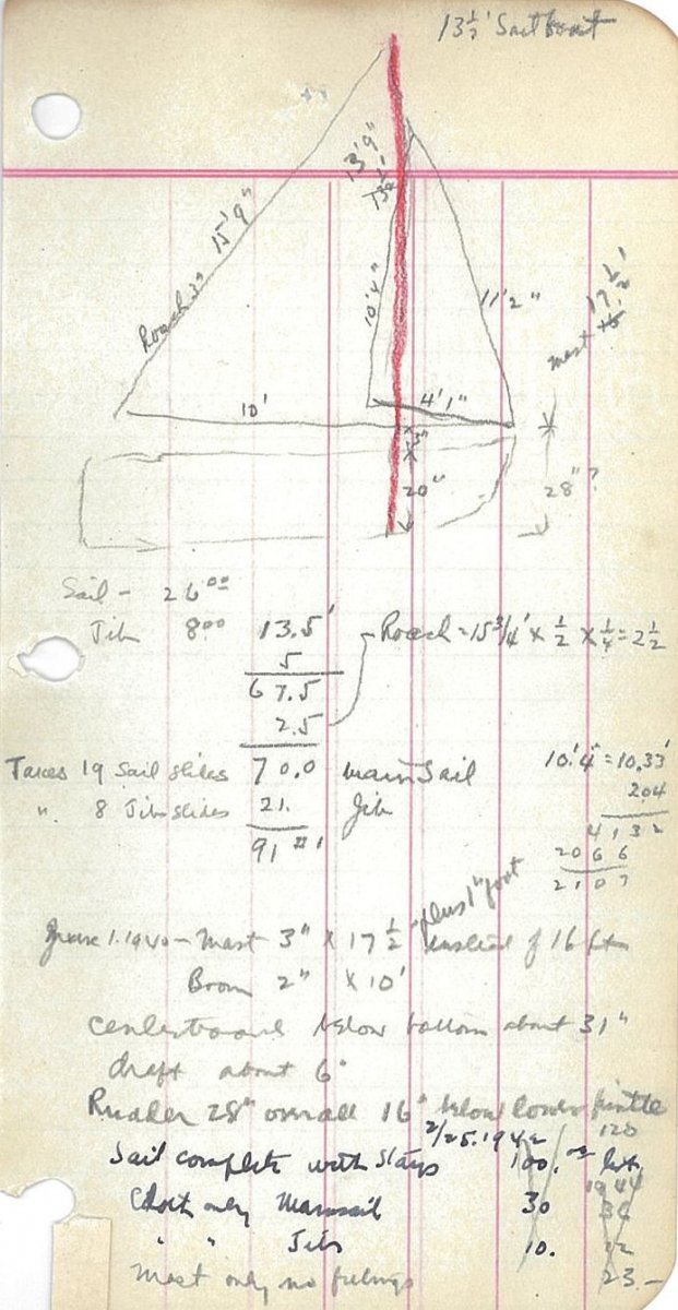

The Old Town with serial number 164680 is a 13 1/2 foot long lapstrake sailboat with a keel, outside stems, and a floor rack. It was built in January, 1956. The original paint colors were white and gray on the hull with brilliant green on the deck. It shipped on May 28th, 1956 to Wells River, Vermont. A scan showing this build record can be found below.
It is also possible that you could have another number or manufacturer if this description doesn't match the boat. Page 24 of the 1954 catalog at the link below has more details (including a fuzzy picture of the centerboard lever handle). Feel free to reply here if you have any other questions.
Hello again, still don't have a good answer on the centerboard lever, the Dyer Dinghy lever is the right idea, but too small. Meanwhile we need the spar dimensions for the boom and mast and sails if possible. I've checked with Jerry Stelmok but he has no info on the White Cap.
