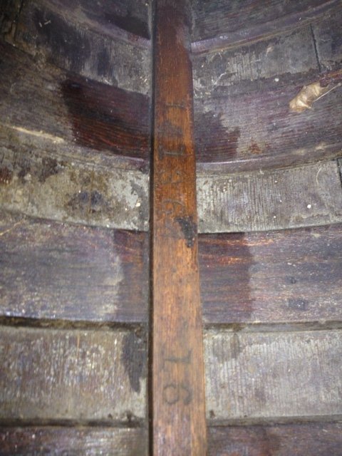

The Old Town canoe with serial number 147363 is shown as a12 foot Sportboat, built in 1946-47. Check your serial number again, at both ends -- perhaps post photos of both serial numbers.
I sent an email to the guy requesting it.
What he gave me was: 747363. 16 I guessed the first 7 was a 1.
Something is amiss.
Our build record scans stop at 210xxx, around 1975. The serial number 747363 is not from an Old Town built in the 1950's.
Trying some other variations -- 147368 is a 16 foot Yankee. 147863 and 147868 are not Otcas, and are not 16 feet long.
Again, pictures of both stem ends with the numbers might help, and indeed, pictures of the canoe itself would help to confirm that it is an Old Town and an Otca. A few of the tricks described at http://forums.wcha.org/showthread.php?791 may help if some of the digits are not clear. Good luck.
Old Paddler - the photo you posted looks like a pre-1950 (or so) 16' OT Otca. Something's not right with the serial number you were given.

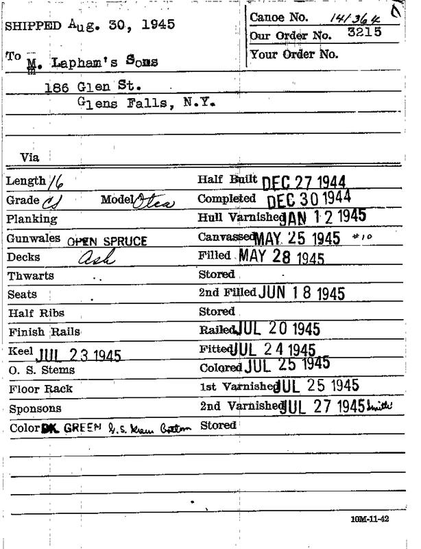

The Old Town canoe with serial number 141364 is shown as 16 feet long, CS (common sense or standard) grade, an Otca model, with open spruce gunwales and ash decks, and equipped with a keel. It was built between December 1944 and July 1945. The original exterior paint was indicated as dark green with a guide special green bottom. It was shipped to Glens Falls, New York on August 30, 1945. A scan of this build record can be found by following the link behind the thumbnail images attached below.
