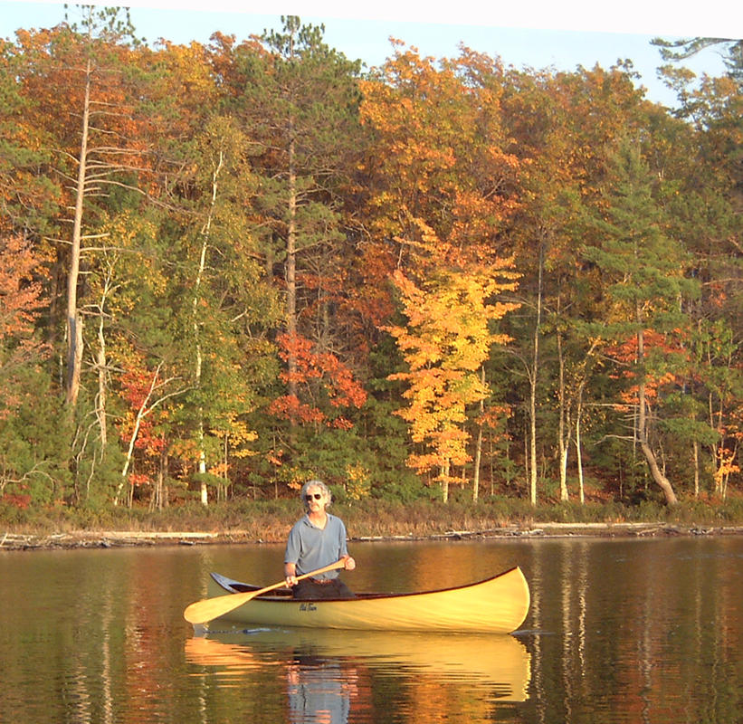

Regardless of the covering (glass or canvas), that is a very attractive boat. Is the color a yellow or funky green, and what is it called? I just painted the hull of my Old Town white but could change it in a heart beat.
Thanks, Pathologist
It's a pale yellow. In my 1970 Old Town catalog there is a photo of two hunters hauling a deer carcass out of a yellow Lightweight model, but at least in the copy I got, the yellow is a bit softer and lighter than most Old Town yellows that I have seen. I've never really been into yellow boats, but always thought that among all the colors you can paint the hull, the light yellow seemed to give the nicest contrast and bring out the warm tones of the cedar best. The boat was originally dark green when I ordered it and later, after glassing. Then I eventually repainted it dark green over off-white. This time around, I figured I'd go with a light yellow. I didn't like what I could find pre-mixed and finally had Ace Hardware mix up a custom color in their polyurethane floor enamel. It does not roll and tip quite as smoothly as some of the marine enamels like Brightside (a bit more orange-peel) but it's not bad and pretty tough.

Again, about that yellow canoe; I really like the color very much, so please excuse my impudence when I ask if you would share the Ace Hdwr recipe or color-mix formula. It appears as a lemon-lime yellow. Refreshing!! I also use Ace for color mixing and formulation. I am waiting for filler to cure on a 1964, 17', top grade, OT OTCA. The original color was bright red but, red is less appealing since I saw the yellow canoe.
Thanks, Pathologist
Sailmaker,
Again, about the yellow canoe. It appears as a refreshing and wood-enhancing lemon-lime yellow/green. It may be the light during the photo but, I like it very much. I'm waiting for the filler to cure on a top grade 1964, 17'4" OT OTCA (all original wood). The original color was red but red is becoming less appealing. I also use ACE Hardware paint mixologists. Excuse my impudence, but would you be willing to share the color formula of the yellow/green?
Thanks, Pathologist
Sailmaker,
Again, about that hybrid yellow on the above boat: I'm waiting for the filler to cure on a 1964, 18' OT OTCA, top grade. Gorgeous wood!! The original color was red but that is becoming less appealing since I saw the "lemon-lime" on your canoe. I, also, use ACE HDWR mixologists for paint color. I picked up every yellow, yellow-ish, light green, etc. paint chip in the store and none comes close. Excuse my impudence, but would you be willing to share the paint formula for the color?
Thanks, Pathologist
Sorry about the multiple postings. I couldn't find them in the forum for some reason. Still have not mastered this thing. I guess you know by now that I like that color
Todd,
Your yellow OT you have pictured, does it have a keel of not? I know you mentioned that you special ordered it without one but glassed it two years later. The picture looks like it has the brass bow and stern bands. So would you suggest that, brass bands and no keel? Thanks.
kjg
Correct, no keel and brass stem bands. It's personal preference, depending on what you like, and I really dislike keels on canoes. There are certainly boats where I would put a keel back on (and canvas) for an accurate original restoration, but this isn't one of them. I rebuilt it the way I wanted it for my own use and changed some of the things that bugged me. The original ash decks were getting rotten at the tips, so I replaced them with mahogany decks and their undersides are epoxy-sealed and will never rot out from underneath. They were also cut with a simple radius on the hand-hold inner side because it's more comfortable than the standard shape when carrying the boat by the ends. Also, all the screws were replaced with square-drive, silicon bronze screws, simply because they are drastically better and stronger screws than the original slotted brass ones. OT Guides aren't particularly rare and were built to be more utilitarian than fancy, so I don't have any problem with rebuilding one to suit your own needs.
