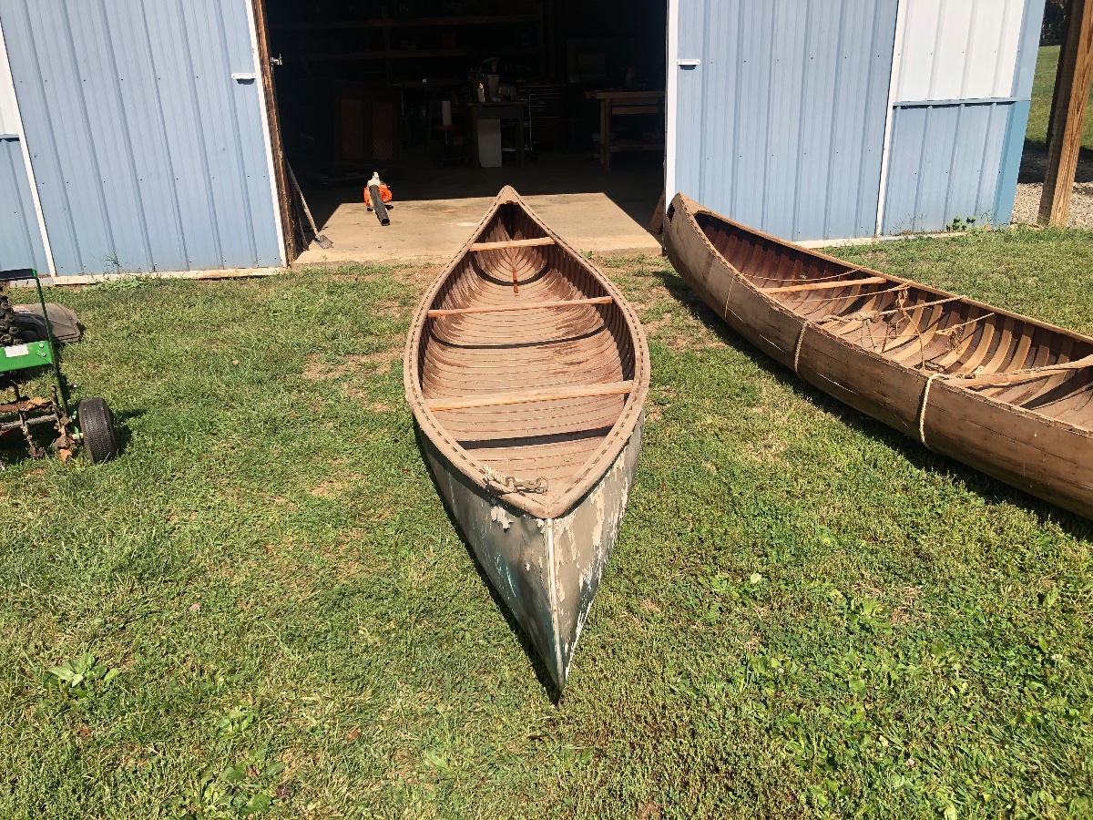

Serial # 166105: Interestingly it's only 104 digits older than the 166299 50 pounder adjacent in the photo below. The canoe has no seats, rather wide kneeling thwarts bow and stern, and a D-shaped outwale which appears to be non-rabbeted, so the canvas top edge shows in the joint between outwale and rib. Thanks in advance.

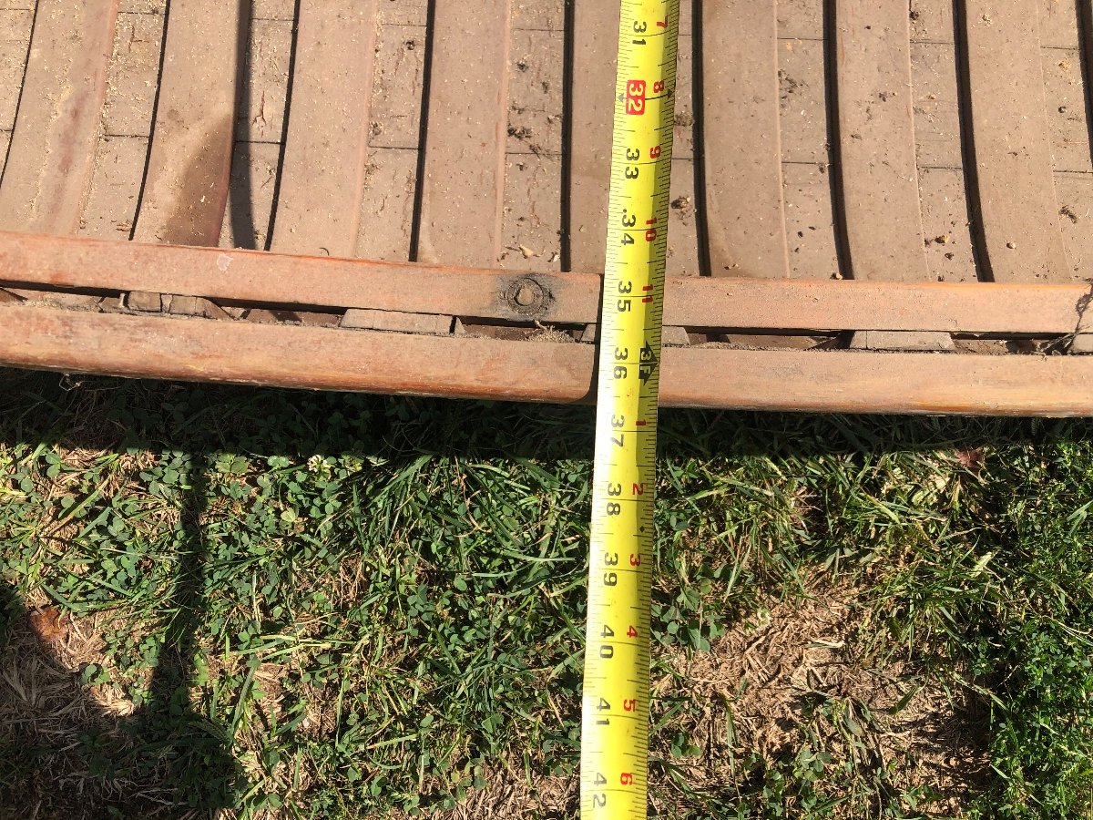

Beam measured inside inwale to inside inwale: 35.5"
