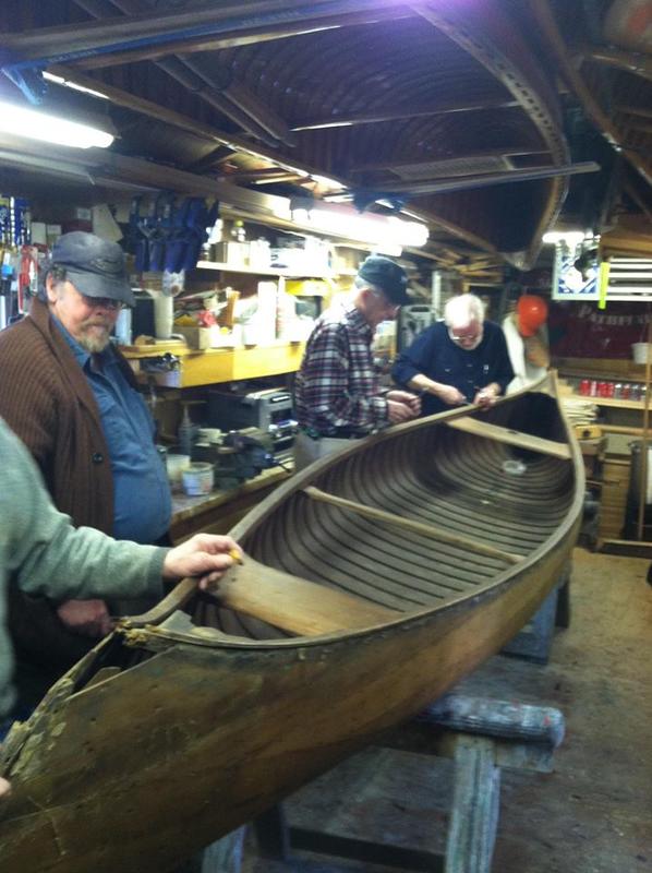

The Norumbega Chapter has started work on a circa 1930 Robertson. It will be restored and donated to the WCHA, to be auctioned or raffled at the 2015 Assembly.
On Saturday, March 22nd nine Chapter members gathered in my small shop and spent half a day scarfing in new inwale ends and stem tips.
Other sessions will be scheduled in the future so as many members as possible can get some hands-on time in on this project.
