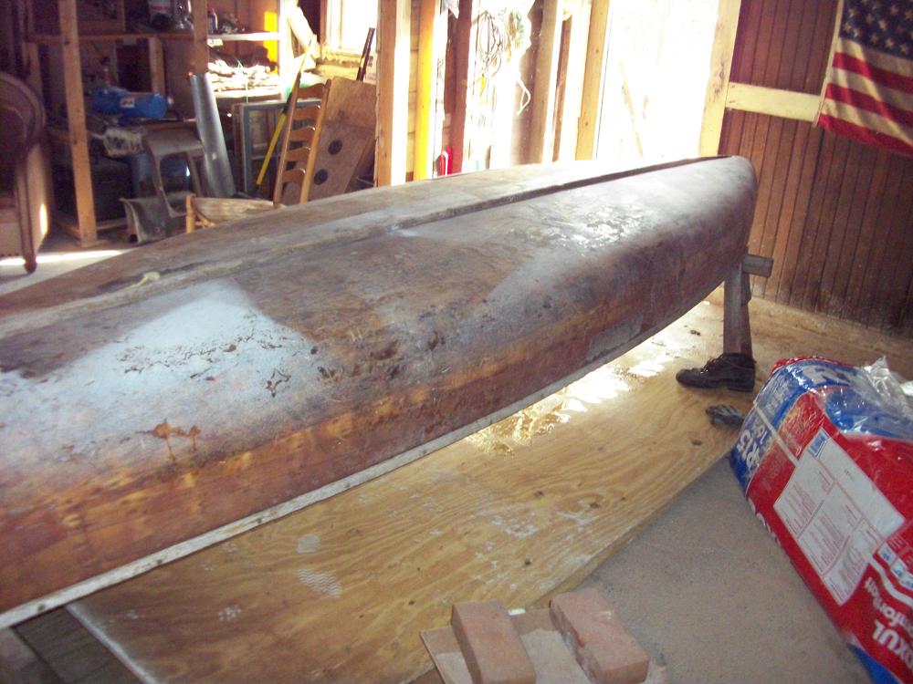

New to me.. Old Town
Tex
Ok.. Very vague but. could the number be? 87711 - 15
It looks to me like if there is a number before the 8 it would be a 1?
This is a craigslist find that I'm lookin forward to..
Please any info is greatly appreciated.
Bryan

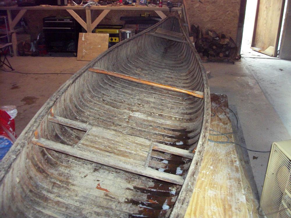

Wow! Thant's amazing. Yep thats it, the 15 foot trapper. It still has a lot of its fiberglass. Two layers that are coming off pretty easy. This is very exciting. I really thought the canoe was originally canvas and then recovered in Fiberglass. Hm.. makes me wander what to recover it in...
At any rate. Thanks so much for this incredible info. It makes my rebuilt so much more meaningful.
Bryan

Hey thanks Greg. Yea that was me. Been searching around. Trying to figure out what i wanna do. Canvas or fiber?
So thanks again. I'm new here.. and hooked.
Bryan
