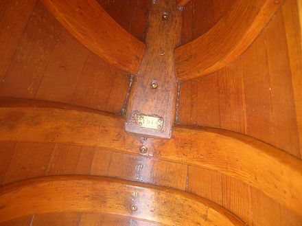

Wow Benson! That canoe could pass for a Morris easily. I assume that there was an OT serial number on a stem not splayed for you to distinguish it as an Old Town? Are there other Old Town canoes with pocketed ribs?

Yes, Gil Cramer thought that it was a Morris when he first saw it in 1990. I did too when I first saw it many years later. The early Old Town Molitors had pocketed ribs. The stem and serial number shown below with the matching build record confirmed that it was an Old Town.
