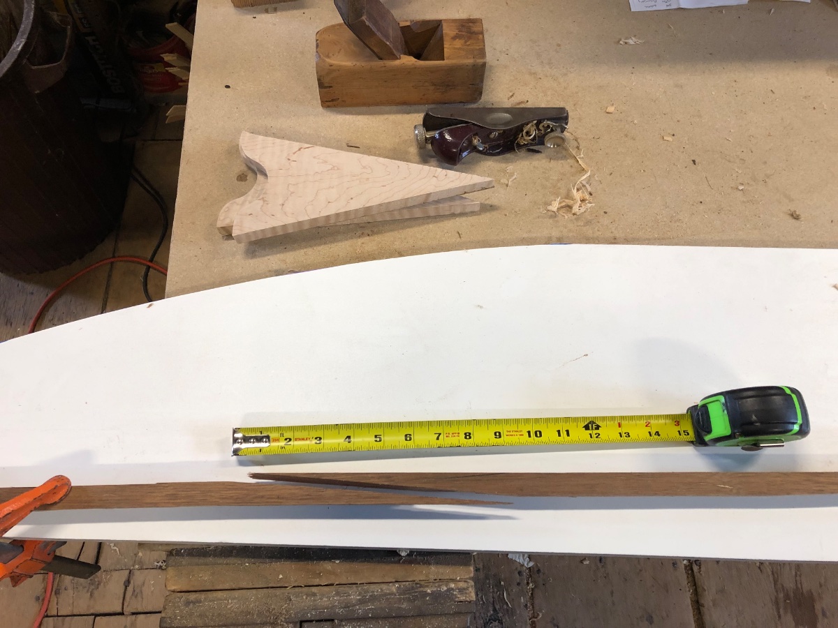

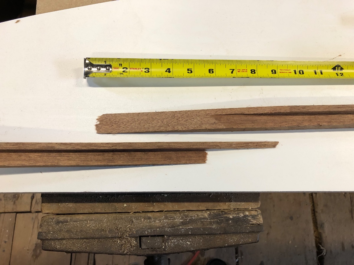

I have a mahogany outwale (actually probably Sapele) which catastrophically failed at the sweep up toward the stem during test fitting. It was a jagged, nearly vertical break. Since then I have scarfed the two pieces at roughly a 10-1 angle and intend to glue and retry. The outwale will be positioned so that the joint is as far away as possible from the greatest sweep (roughly 3' from the stem), but will still likely require steaming. Here's the question; which glue will tolerate steaming the best? Titebond III or G Flex epoxy?
viewed from the side against the hull:
viewed from above:
