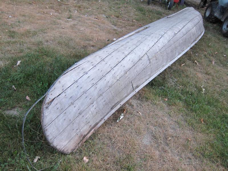

Hi folks. My name is Frank, and I live out in the boondocks south of Albany NY. A power boater most of my life, my current ride is a 50 year old classic fiberglass tunnel hull racer. Many years ago I acquired a 1947 C&S H&W model Old Town canoe that had been fiberglassed in the early 70's. Over the years I've pecked at the fiberglass, which did not adhere very well, and got most of it off, so I think the planking is fine (not resin-saturated). The canoe, a saltwater/big water model, is very light as it is now, and needs some major work, at least from my perspective. I do have the history of it, build sheet and brochure from Old Town. I have set it up on blocks temporarily in my small pole barn and hope to start cleaning it up this week and figuring out what needs to be done. Then I'll be back with questions!

It looks in pretty good shape from what we can see of the bottom views.
More pics will get more opinions about condition and rehab.

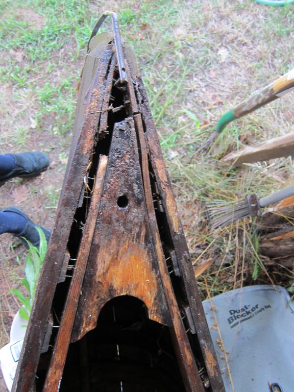

Here's some more pics. Bow is worse than stern (I think I know one from the other - hull number is in bow right?), but I need to learn how to best go about repairing this damage and then strip the interior right? Thanks for any suggestions!
Frank

Well, the one thing you have going for you is it appears to have a solid hull. The rib, depending on the severity of the break can be repaired or replaced.The rot on the ends is typical. It will require you to install new decks, new inwales, or atleast scarf in good wood on the tips. Same with the stems....a scarfed in piece of wood will suffice and never be seen. When scarfing try to make the angle of the cut as long as possible.
You may need to repair rib tips as well or cant ribs. I usually opt for scarfing in new rib tips. The joint is easily hidden behind the inwale.
I too have a 1947 Old Town with spruce planking on the build record. I think it was a mistake. The planks look like red cedar to me.
