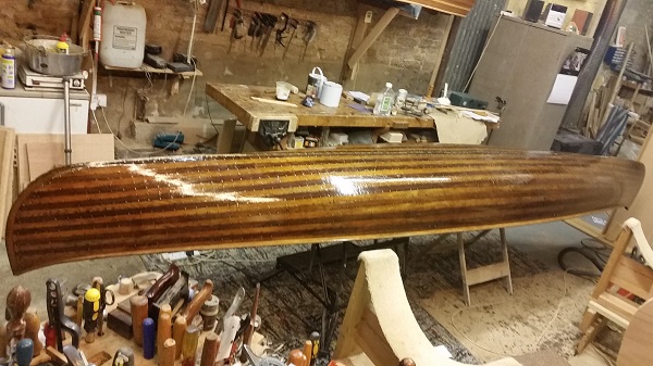

NoOOOooooooOOOOOOOOOOO! Please don't let it become shelving :-) I started with this.
and now she looks like this
I still have more coats of varnish to do but you can see the potential in your boat.
Cheers
Alick:)

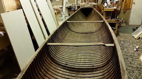

I'm in Macon Mo. If I can get this canoe bought restoration is the only way to go. I've carved toes for Lion head claw foot tables. Woven Hundreds of press back chairs. But this is a really neat part of history and the outdoors well worth saving. IMG_1251.jpgIMG_1250.jpgIMG_1252.jpg both ends need repair. deck look good but gunwales in and out will need help. Does the planking look salvageable? Can it get too brittle?
That hull looks really great! The planking looks fine. You'll apply some hull soup on the planking before you canvas. The red cedar tends to be a bit more brittle than white but it's not an issue.
The soup is either straight boiled linseed oil or a blend of linseed oil, varnish, turpentine, tung oil, mineral spirits etc. I apply a hot blend of linseed, turpentine and mineral spirits....very few of us agree on what's best but boiled linseed oil applied warm has been the standard.
Bazaar attempt to install a rib...cutting the inside rail is a bit of a tragedy... no worries..you can replace it or possibly splice it. With your woodworking skills you should have the necessary patience to tackle a canoe project.

That canoe looks to be readily repairable/restorable. The planking looks to be in great shape; western red cedar is, by its nature, somewhat brittle even when new -- not much of a concern here, as it looks like little, if any, plank work needs to be done, at least as shown in the pictures.
The unpleasant, messy job of stripping the interior has been done, so you start off ahead of the game.
Right now the entire hull may seem a bit flexible because the canvas has been removed and the condition of the gunwales -- it will become quite a bit stiffer with repaired gunwales and when you put a new canvas on.
In the first picture above -- is the section of inwale shown at the top of the picture mahogany, or has it been replaced with some other wood? Is the outwale there missing?
You will probably want to keep as much of the original fabric of the canoe as possible, both to save money (real mahogany ain’t cheap), but also to keep the boat as “original” as is practicable. Repairs/replacement of sections of gunwales is not uncommon, and a fully functional gunwale can be the result as long as scarf joints that are long enough -- at least 8:1 and better 12:1 -- are used.
The butchering of the inwale shown in the second picture is unfortunate, and was almost certainly unnecessary -- but what’s done is done. Splicing in a short replacement section using scarf joints should do the trick. Replacing the entire inwale is not necessary The curve of the sheer is not great at the point of that cut, so a spliced-in repair should have more than adequate strength.
In the same way, the break in the outwale near that cut in the inwale can be repaired by splicing in a new piece of wood with scarf joints, and again, such a splice should be more than strong enough.
