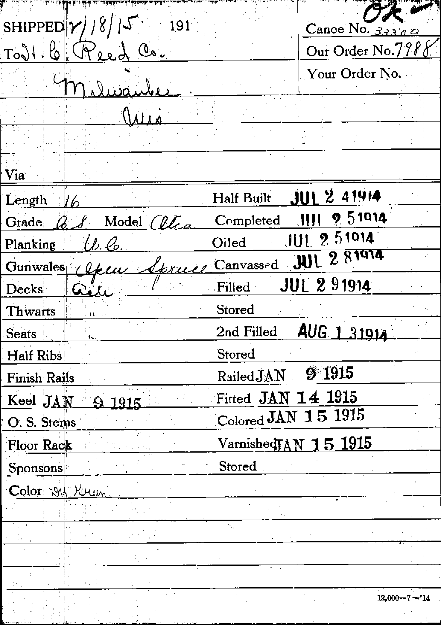

There may be more to your weekend theory than you guessed. I checked your build record from http://forums.wcha.org/attachment.php?attachmentid=1337&d=1143592055 and the Day of the Week Calculator from http://www.searchforancestors.com/utility/dayofweek.html to see what days of the week were involved. It came off the form ("half built") on a Friday, was completed and oiled on a Saturday, railed and had the keel fitted on a Saturday, painted ("colored") and varnished on a Friday so some of the quality problems may be due to the day of the week when they were completed. Good luck with the rest of the restoration.
I would think factory workers are the same everywhere.We all know the urban ledgend of not to buy a new vehicle that was made on a Monday or Friday.
I do not know what year the canoe was built but I think that a 5 day work week is a recent deal maybe 50's before that everyone only knocked off work on Sunday for church.Some worked 7 days even
